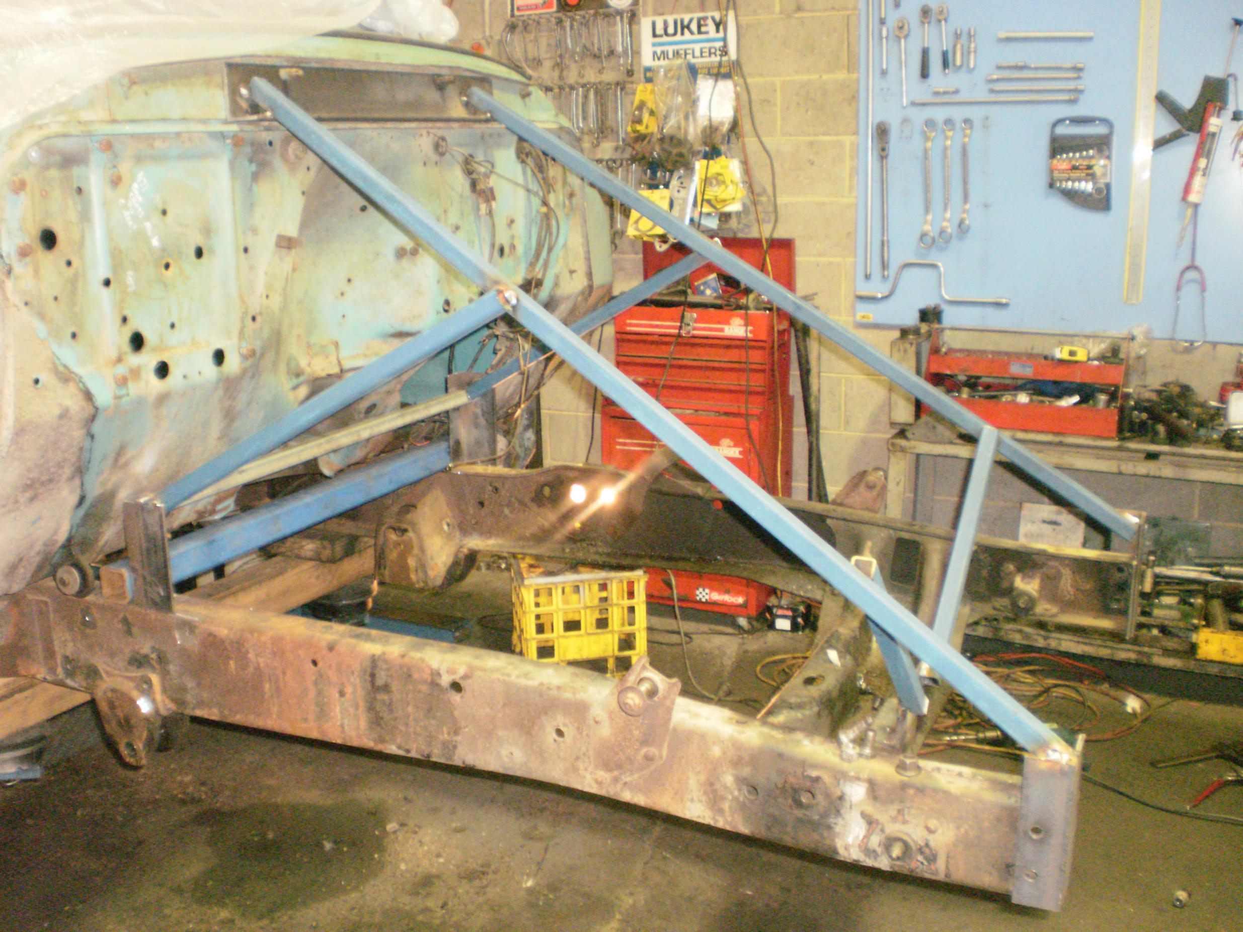

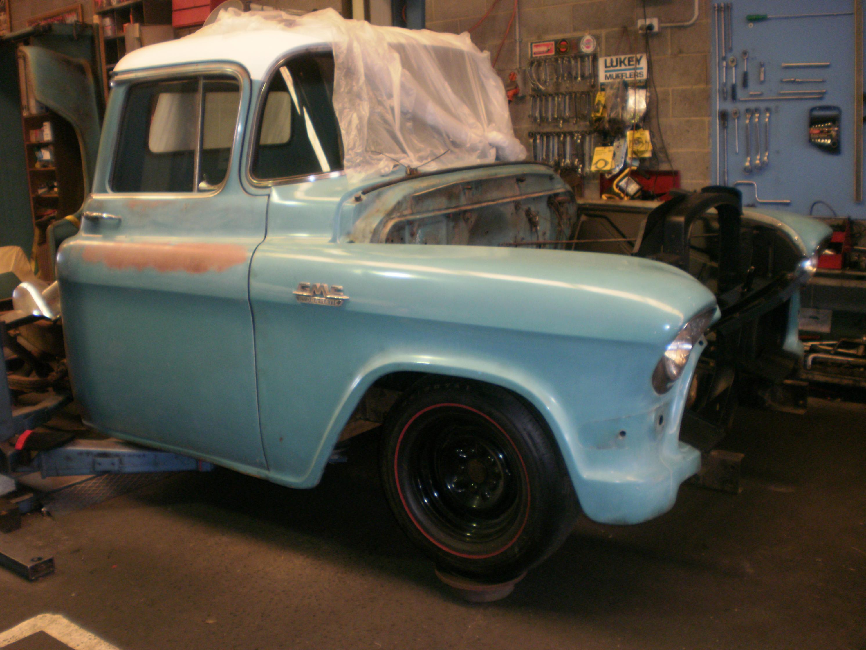

    Hi Guy's, First of all Merry Christmas in advance, its early Christmas morning here in Oz, kids aren't up yet so I'm here brousing again looking for advise?
    I finally tacked in a 77 fbird frame in my 56 GMC acouple of days ago after hours of measuring & squaring up, also knocked up a bit of a jig to help with finding rad support & frame horn bumper points. 55-57 GMC are differnt than Chevys as discussed in a earlier thread.
    I also mocked up the wheel to were I wanted it before I cut the original frame, once I centered the wheel to were I wanted it I marked the original frame & it worked out to 1.6" (41mm) forward from the original axle centerline. I wouldn't mind some opinions on how the wheel sits before I go ahead a weld her in?? keep in mind that I will bolt up spindles & hubs to mount the wheel properly & re check also.
    *** trying to attach pictures but its not happening, I will try again later***
  25. JAWS
    Joined: Jul 22, 2005
    Posts: 1,850
    JAWS
    That sounds about right. I depends on how low the front is gonna sit as to where the wheel looks best in the fender opening.

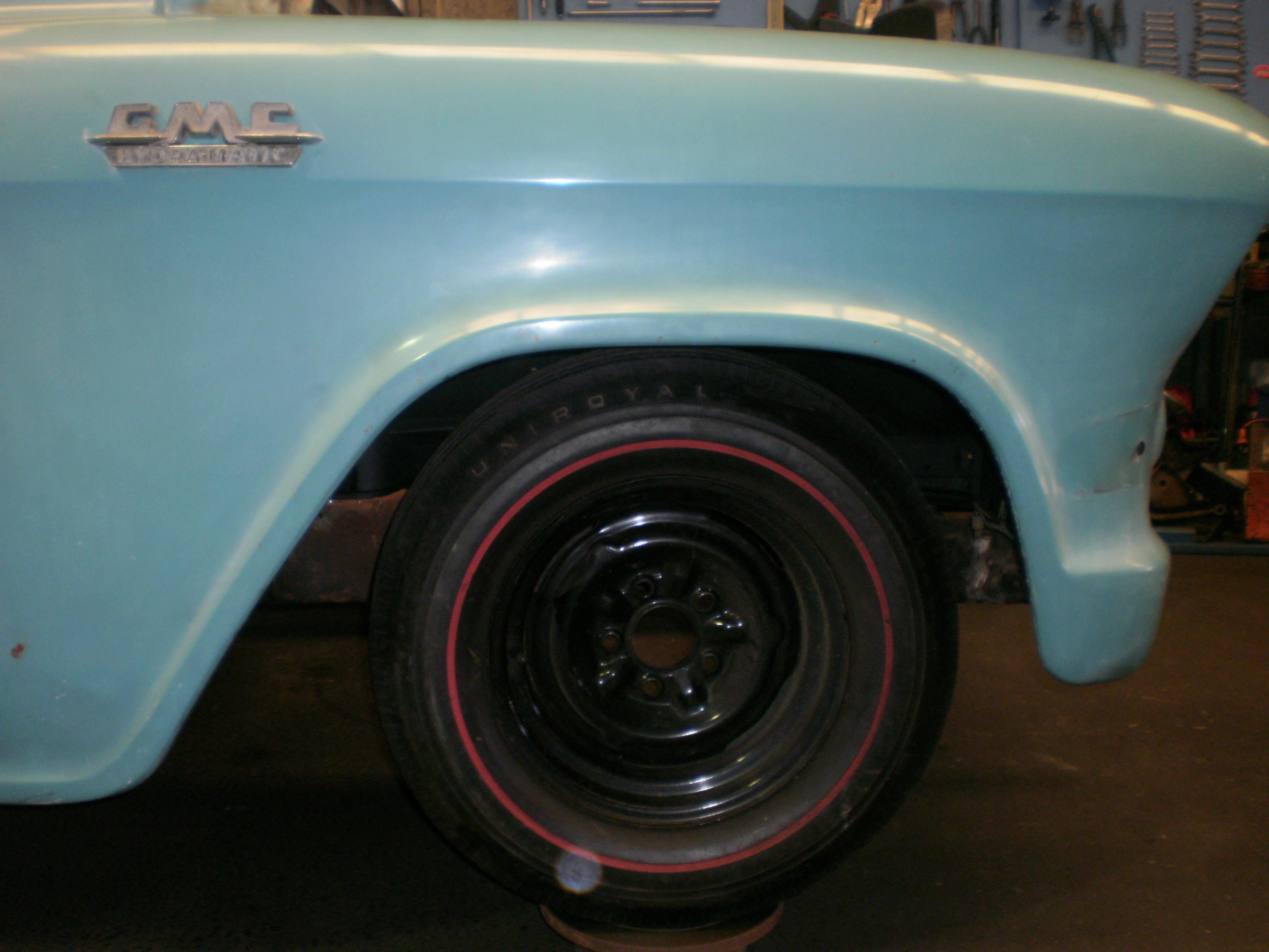

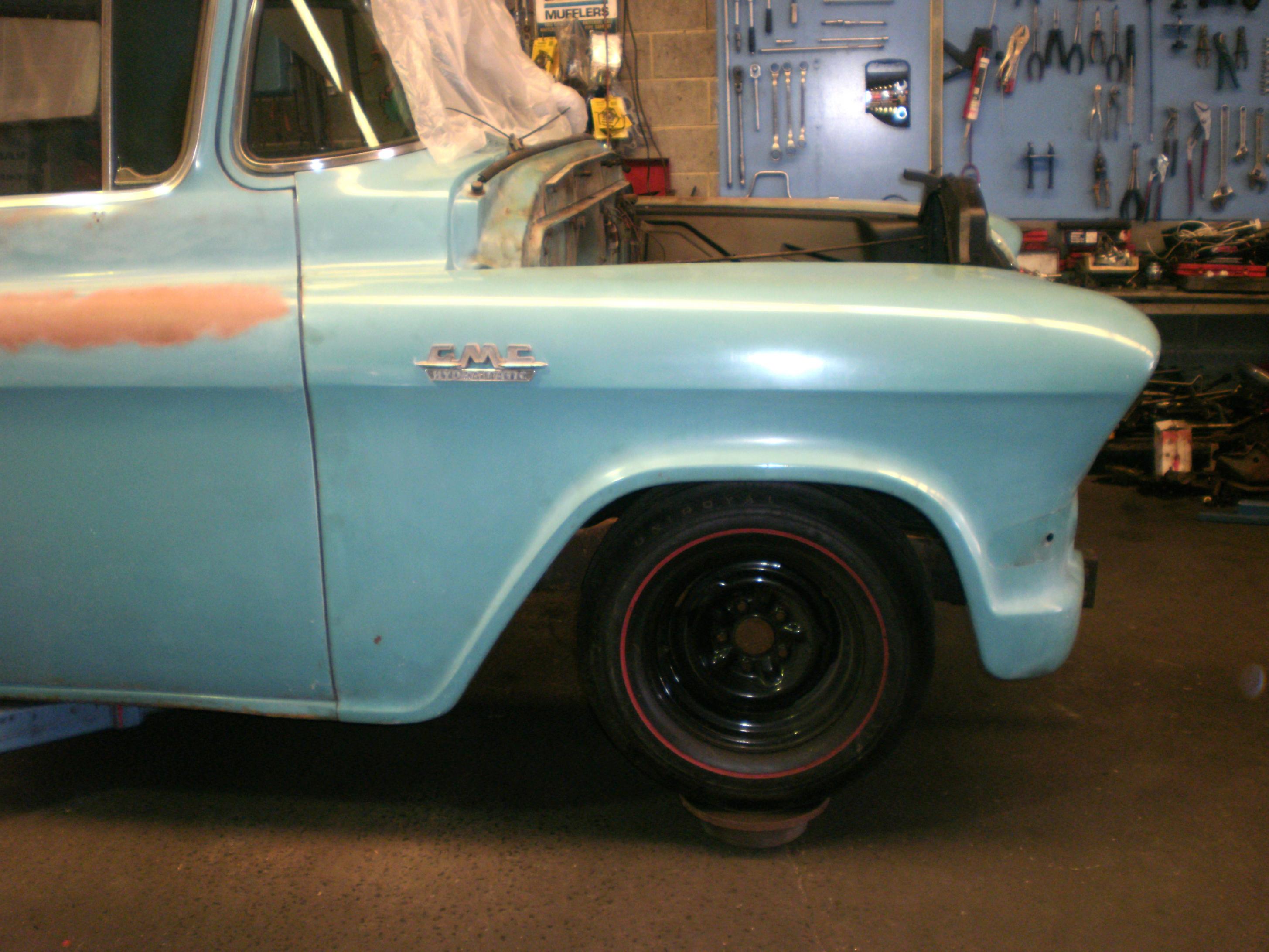

    Ok I think I got this working, here go's this is the wheel sitting 1.6" (41mm) forward of the original axle centerline. This is the look I'm hopeing for, the tire's propped up & the truck is level allthough raised on the hoist.

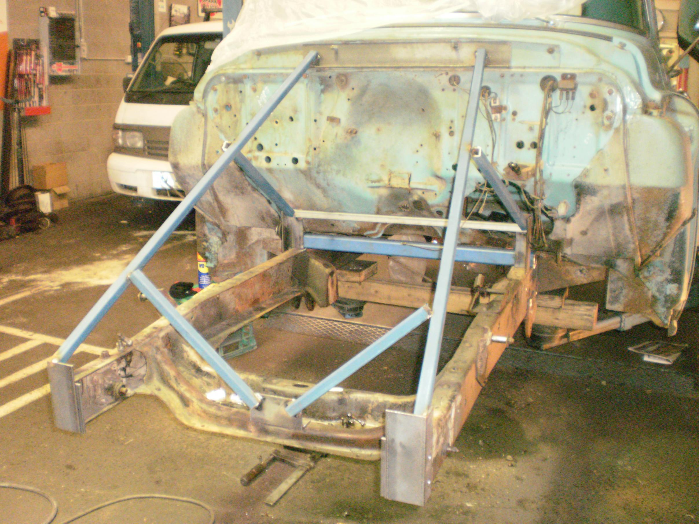

    The idea of the jig here was to pick up the Rad support & bumper brackets location, not my idea but my buddy's that is a fabricator/welder with many years experience so I,m going with the flow!
  30. JAWS
    Posts: 1,850
    JAWS
    That looks right to me....I like it alot.
