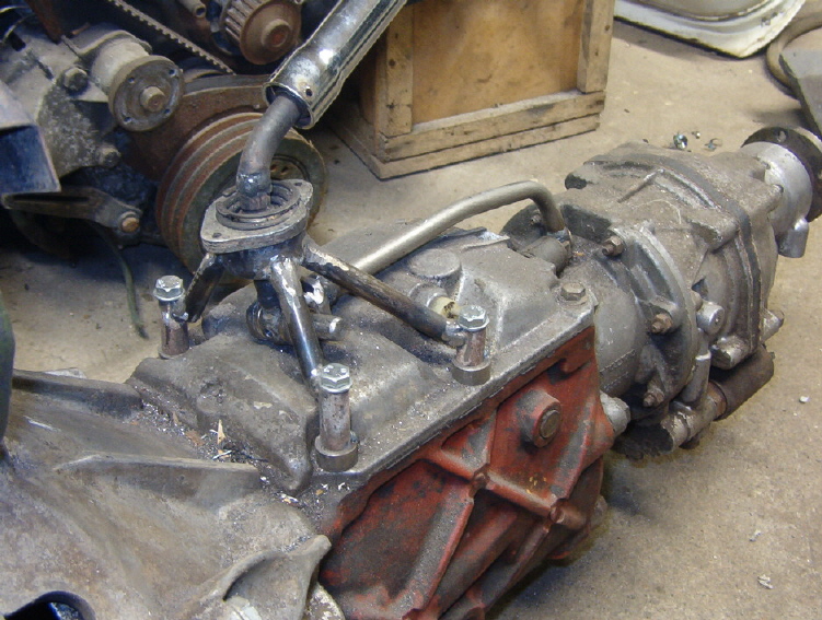

    I've pick this picture on the net, I think it's a M46 (correct me if I'm wrong) and I'm wondering how to get the shifter on the case, not so backward. Your right it's not the long aluminum shifter like on the M40/41 , but it's still a way to long for me (or may be I can put my seats in the pick up bed .. :))

  4. Hi Pierre!
    Glad I could help! :D
    Do you want the shifter closer to the gearbox, or is it a shorter shifter, you want?... :confused: If it is the shorter shifter, just cut some of the top of it - if it is the shifter closer to the gearbox, I would find a M40 gearbox instead, like the one in the pics, Artiki placed in the beginning of this thread. And you can still put the OD from an M46 on a M40 box, if you build in a longer exit axle!

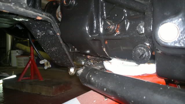

    Hi guys, the job is done so far, yesterday my friends and me removed my engine and trans out of my 32 sedan. We had the M40 box bolted on the engine and gave it a try to fit it in the uncut chassis, after some waggling with the engine & box, to our surprise the combo fitted nicely in the chassis, it's tight but it can be done, but not without any cut, a small cut have to be made to fit the speedometer cable properly, but nothing seriously. As for the trans bracket, i don&#8217;t think you have to make one, or use a thick piece of rubber between chassis and trans, but i think the engine can be supported on two mounts at the rear of the engine where the side rods are, that's what i gone try first. On one photo you will see that the engine is well alined in the center at the snout and the trans not touching any part of the chassis.
    @ Mart... yes, it can be done, there's some extra place for the OD :)
    Any comments are appreciated ! :D
