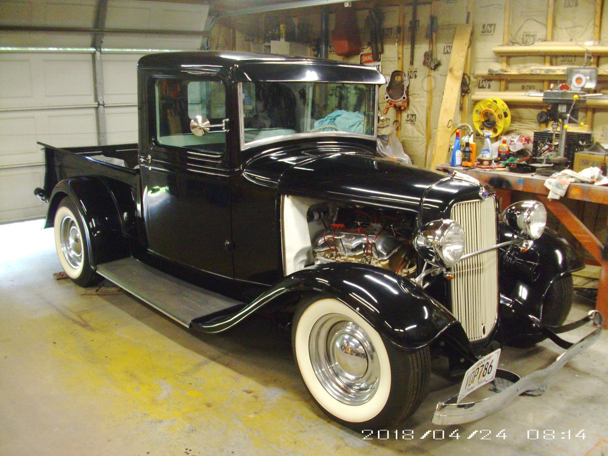

  6. I have used it. I sprayed this 34 pickup with it. It was not as good as the PPG I sprayed years ago but it went on as well as one would expect with lacquer. It didn't seem to have as much pigment in it as a higher quality (priced) lacquer like PPG. I had to use more of it to cover it like I like. It wet sanded out fine and I hand rubbed it, I have not machine buffed it. The thing is, you can't buy lacquer just anywhere and you have to use whats available if you want it in lacquer. I would think for a repair of a 50 year old paint job that TCP Global would work fine.
