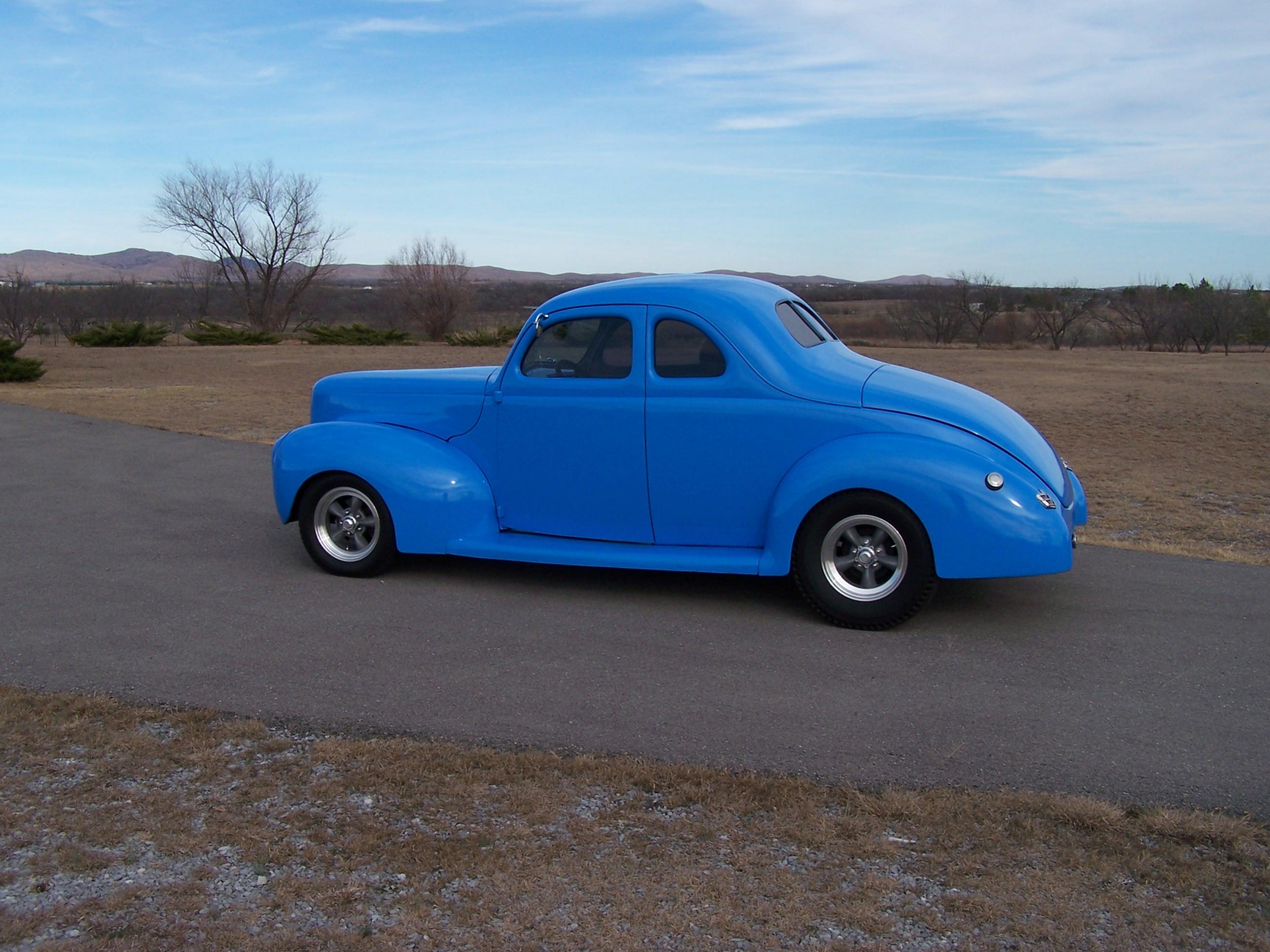

    i know this may not be of any help, but i have the welder series crossmember, cut to my measurements i wanted, and the front ride height is perfect for me.

    TCI kit,dropped spindles with 1 coil cut from springs.
