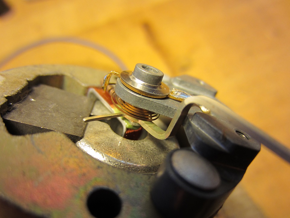

    Maybe the clock spring came unhooked. Normally the spring provides resistance. The stronger the signal, the farther it twists against the spring. Without the spring it could just spin as an electric motor until the indicator needle hit something.
    This is an old Sun. Others should be similar.
