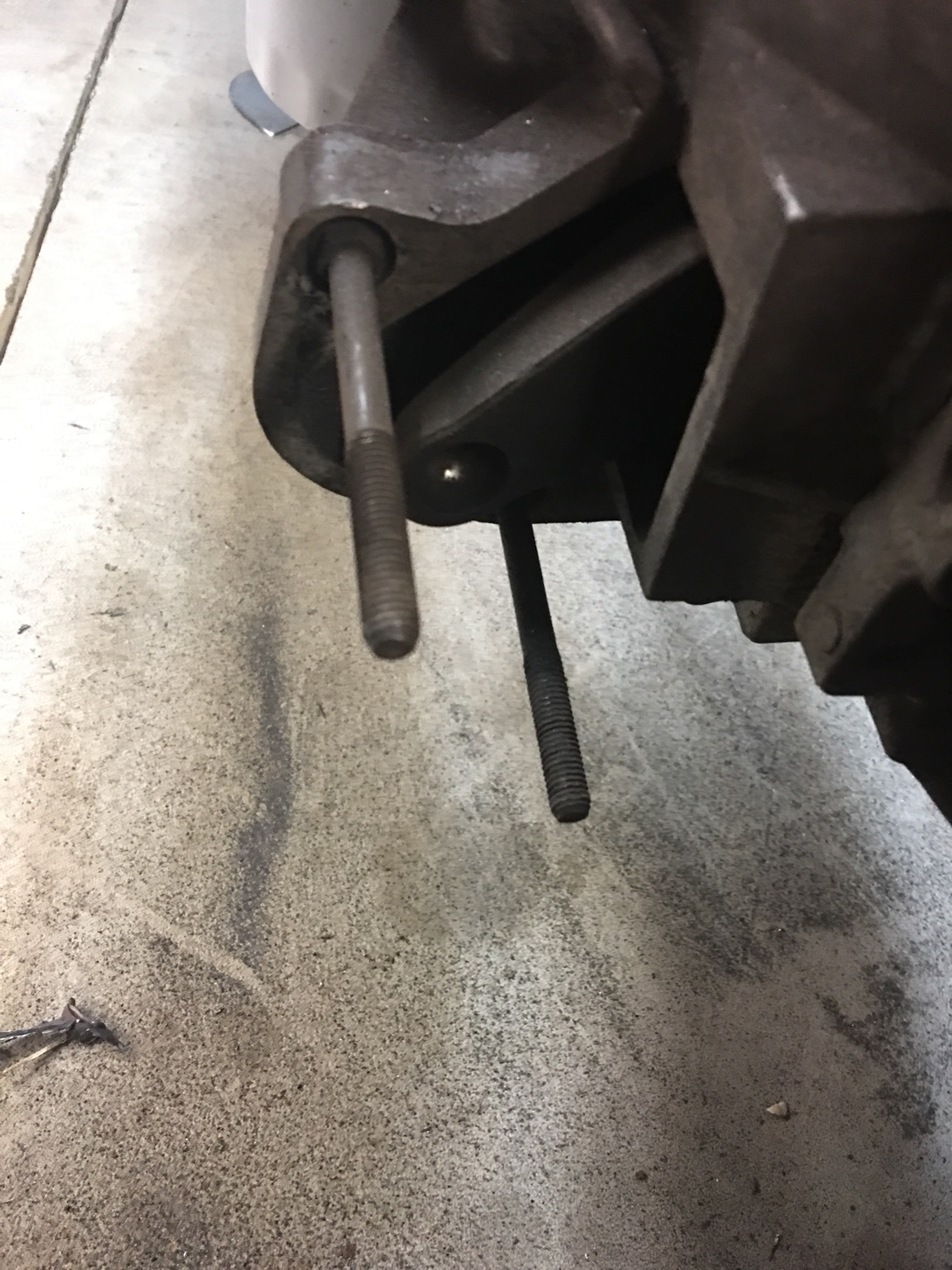

    Have a 305/t56 trans from a early 2000 Camaro? Needing to figure out what I need for the hydraulic arm of the slave cylinder. If that makes sense? The car project came with a pedal system already, but no part to work with trans. Help and Thx Michael [​IMG]

    That's not a 2000 transmission, and the 305 was not in a Camaro after 1992.
    You have a 1993-1997 LT style T56, with a pull clutch. If you want to use stock stuff, the entire hydraulic system is one pre-bled unit, that looks like this:
    If you look, you will see that the slave cylinder bolts to where you have those two studs in your picture, and end ball on the end of the push rod fits into the cup on the release arm, also shown in your picture.
    Aftermarket equivalents are also available. Those can be used with different length hoses, or other combinations of parts, to fit your application.

    Oh, and you're missing a spacer:
    It goes under the slave cylinder. You can score one on eBay.
