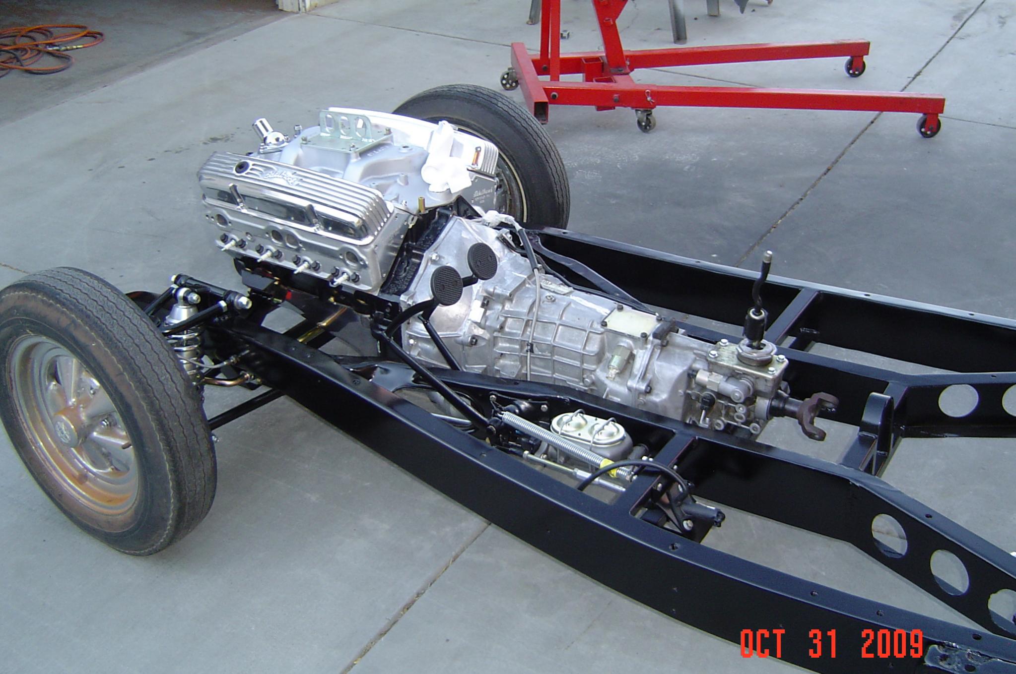

    I have had the T-56 in my '33 coupe for over two years now. I didnt like the shifter in the stock location so I moved it up. There isnt any info on it either and I couldnt find a kit to buy so I just went for it.
    I have to say, it was an excellent choice.
    Im running a 392 with a Hotheads adapter, hydraulic throwout bearing and a Corvette pressure plate.
    -Jason

    I have a T56 from a Camaro LT1 in my 34 Roadster. The engine is a 1st gen Chevy small block w / 1pcs rear main seal. The LT1 transmission & clutch fits right on these engines. No need for adapers and stuff.
    The transmission is huge. The 3 pedals fills up the space very much. Nowhere to strech out your left foot while driving.
