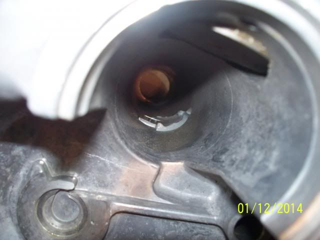

    Thanks to some sharp guys on the HAMB, I have a pretty good handle on the 2 T5 swaps I have in the works right now. I've been hunting for an S10 mechanical speedo tail housing for a while. I was running out of time, so I payed the big bucks and ordered a housing from a guy that has an eBay store specializing in T5 parts. The pictures below show what he sent me. It appears to be an electronic speedo tail shaft that has been bored out and had a mechanical speedo insert epoxied in. needless to say, I'm a bit pissed about this - not real interested driving across the countryside with a trans held together by glue. For almost 200 bucks, I expected to get a real OEM housing. Before I rip on this guy and demand my money back, is this thing maybe OK to use? Are other guys running something like this successfully? Thanks for your advice!![​IMG]

    Joined: Apr 28, 2006
    Posts: 3,370
    badshifter
    You know the answer. Get your money back. It may work, but the right housings are out there.

    I would think 200 would get you a whole T5. I think you need to do more than just change the tail housing, isn't the output shafts different. Why not just change your gauge to an electric speedo.

    IMO that should work fine but it should have been disclosed and priced accordingly.

    I buy S10 WHOLE T5's for $125-200.
    If the exact description did not include what you find here, then it is a misrepresentation.
    Contact the seller and demand your money back. If he is not willing, contact eBay and file a claim.

    the first year or 2 that GM went to electronic instruments they (88?) they used a drive unit that bolted inplace of the mechanical unit. I think it was 88 you could get electronic guages as an option. they did the same on the automatics for those years. I don't know if the tail housing you picture is one from this period or if it was modified.

    The modification doesn't look too bad, a little sloppy on the goo, but it really doesn't have to do more than hold oil in.
    The price seems high though, but some guys will just fork over the money instead of scouring salvage yards, the internet, and classified ads.
