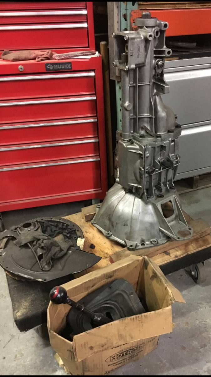

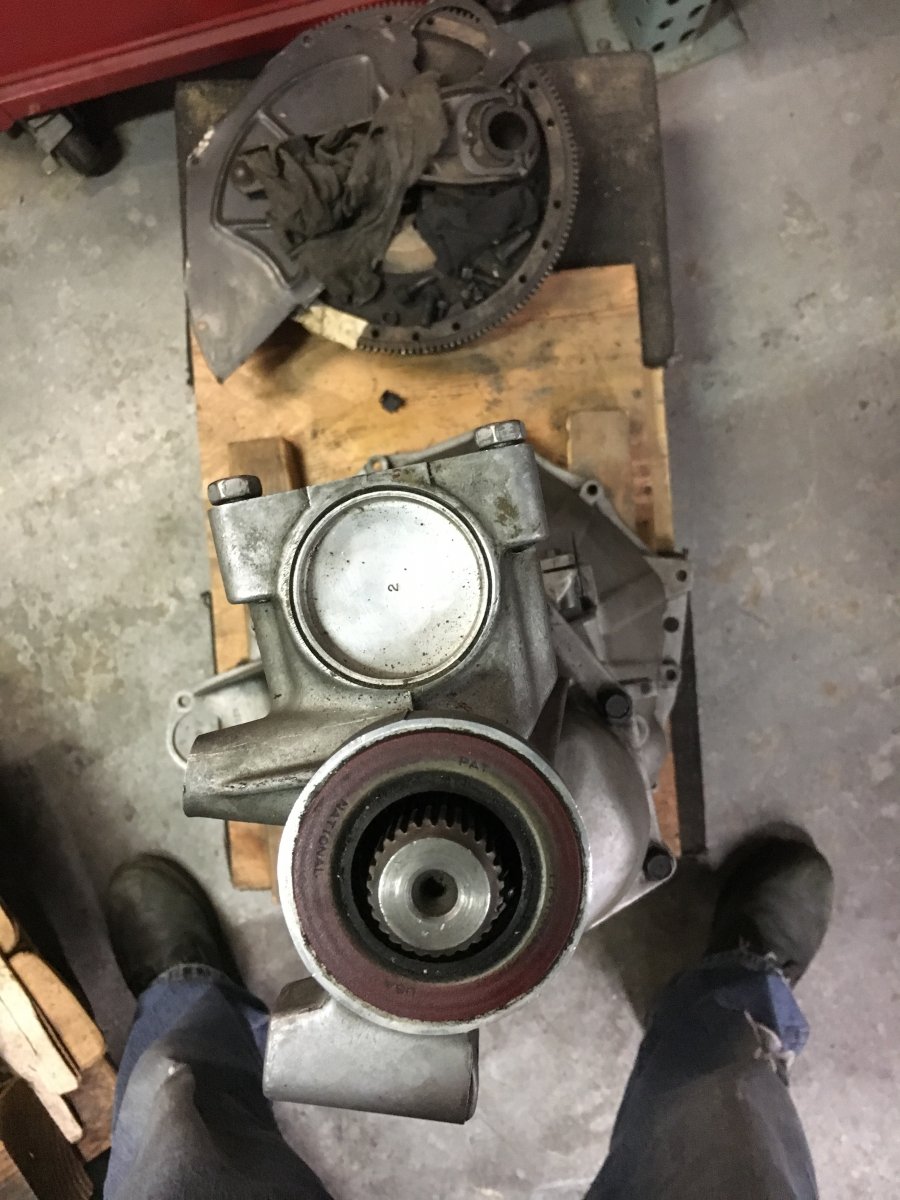

    A42D0B09-1B4F-4B1D-B5C3-CD790FC03D5D.jpeg 1E57E0A7-F9D1-4B4E-850E-CE38CF205F6E.png Camaro and Mustang T5 bell housings both rotate the transmission gear box towards the driver side bringing the shifter closer to the driver. Both have the shift tower positioned towards the rear. Both tail shaft housings have a corresponding angle where the trans mount is located.
    S10 T5 applications sit up straight at 12:00 with a forward mounted shift tower.
