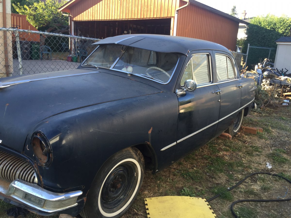

  9. Steve More
    Joined: Nov 17, 2015
    Posts: 23
    Steve More
    Do you have an adapter plate for an 8BA flathead to a S10 T5 ?
