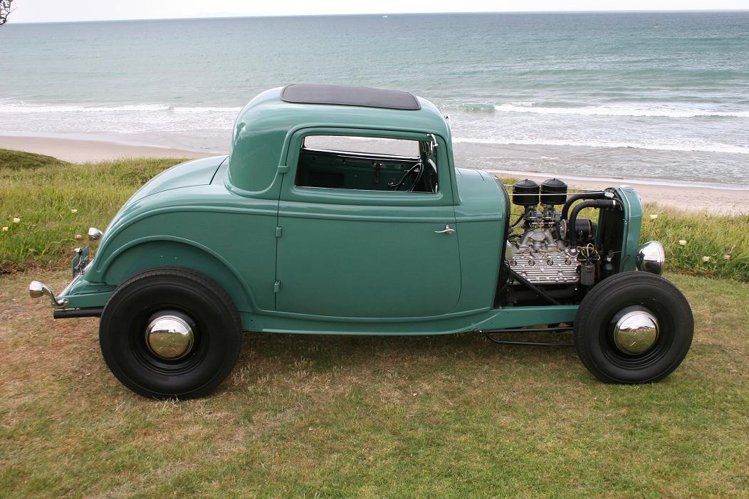

    Originally we built this ol jalopy with a std 3 speed and 3.5 gears with 750x16 tyres. Hummed along just fine and would keep up with anything with a 260 merc motor.
    Got a wild idea we needed a 5 speed. The engineering is never as nice when you do it with the body still on the frame, but we got it done ,all at home. It does rev lower now obviously but shifts smoother , the drop in highway revs is not wildly noticeable as it's a non world class with I think .85 O/D. Did have a few surprises on the install clutch shaft hit the starter in RHD , yes the bellhousing was for a RHD set up.
    It's faster in the first few 100 yds than a lot of Overheads,with the low first gear, then they drive by at the drags, who cares it's a bunch of fun.
    Would I do it again, sure in the right car, with the body off the frame.
