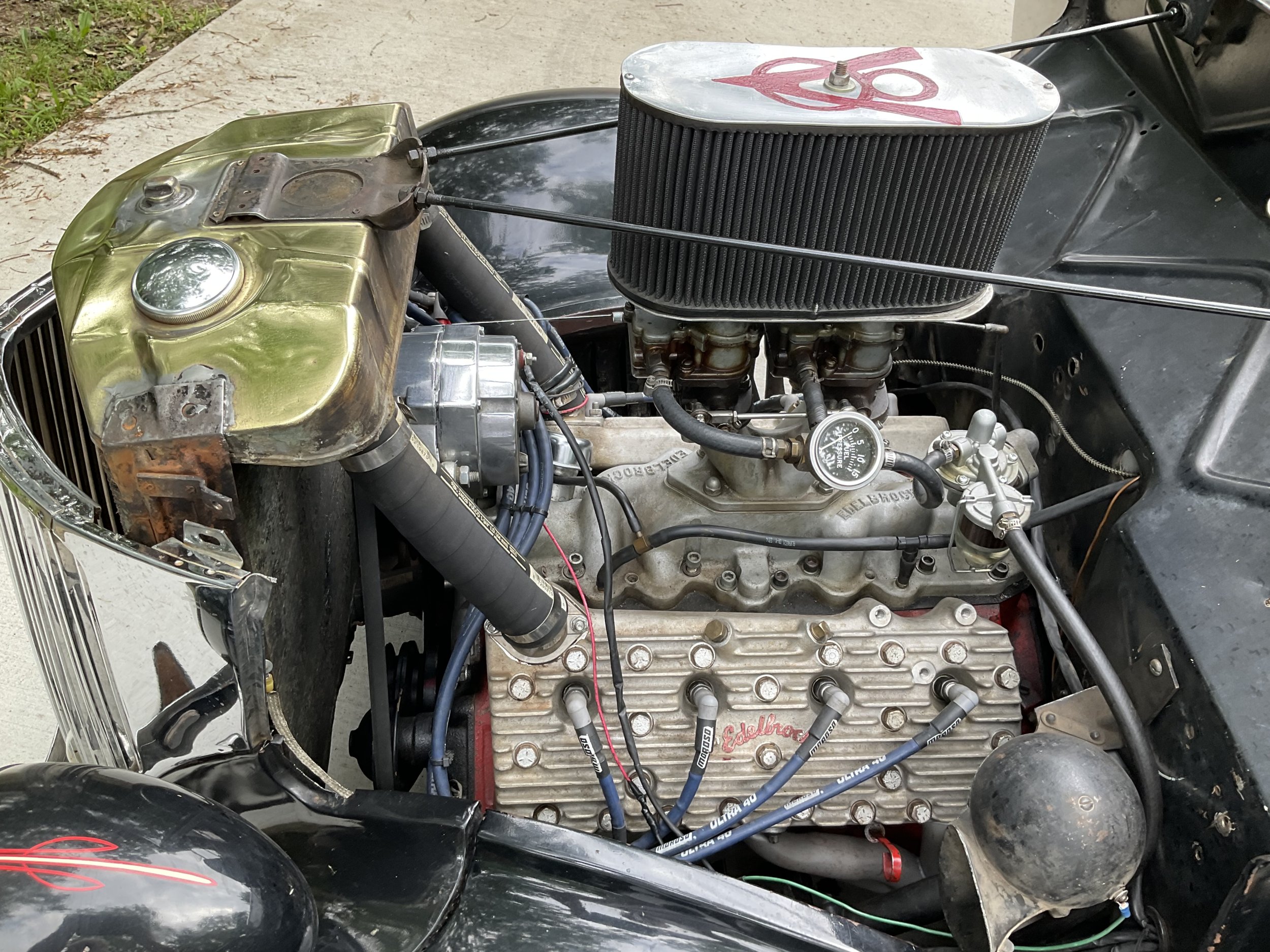

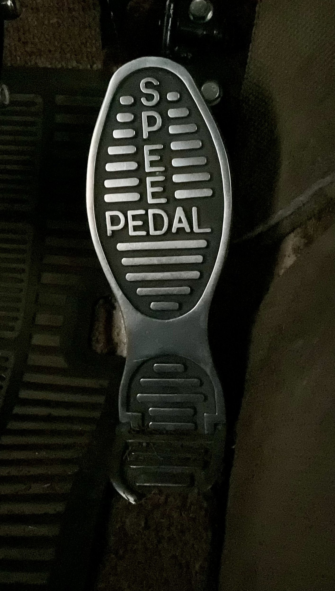

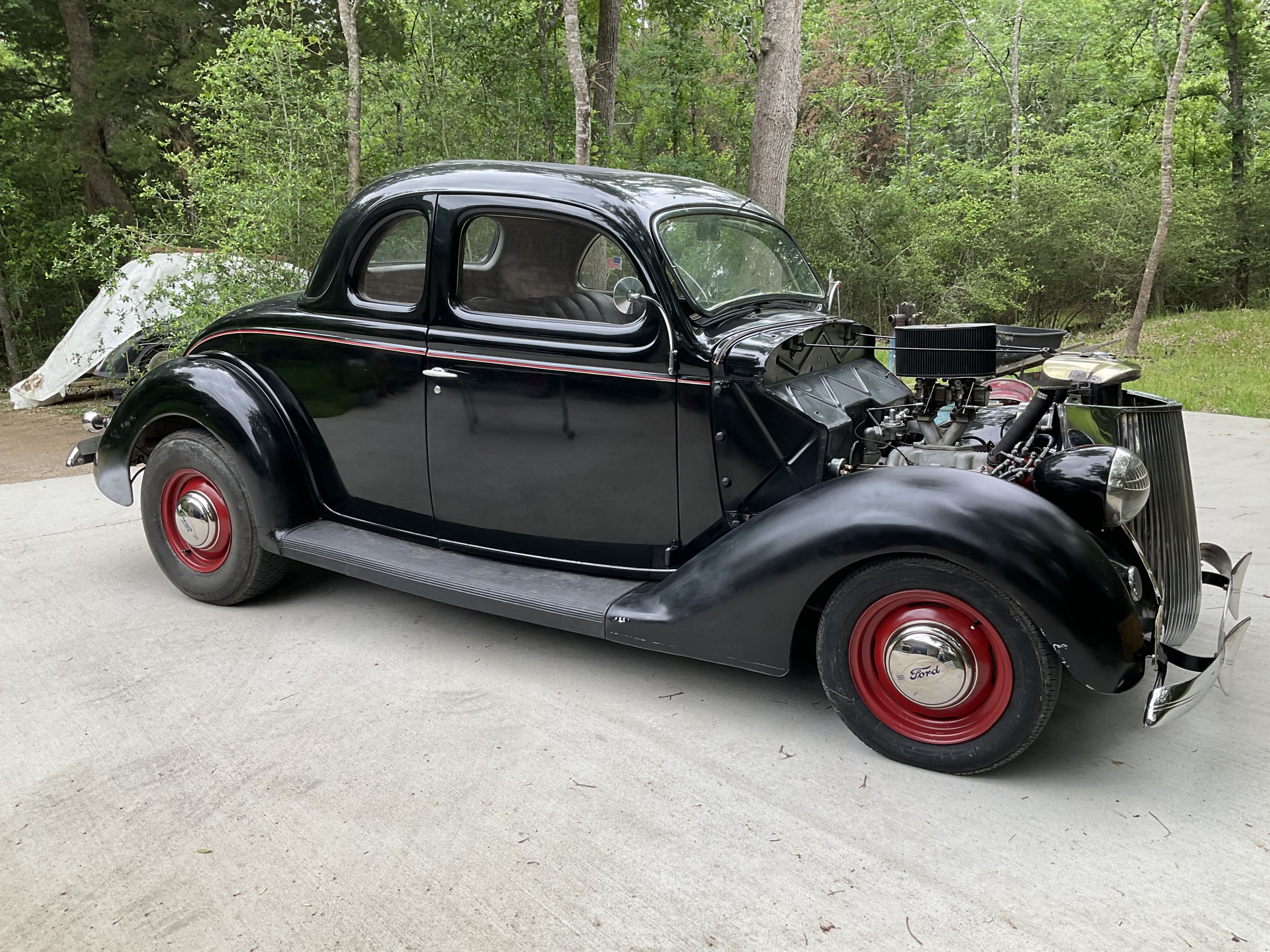

    Built a nice 36 Ford with Mustang parallel leaf springs ,tube shocks, nine in rear, and 5 spd trans. Had to reposition the hole only in the main spring to get it centered in the frame frt to rear. Made all of my own bracket rt frt and rear. 8 in will work fine if u want the 5 on 4.5 pattern(small Ford,Mopar) Rear of frame will need to be boxed to have a nice,strong base to mount your shackles to,but also boxed the frt mount assembly as well! IMG_2603.jpeg IMG_2411.jpeg IMG_2414.jpeg
