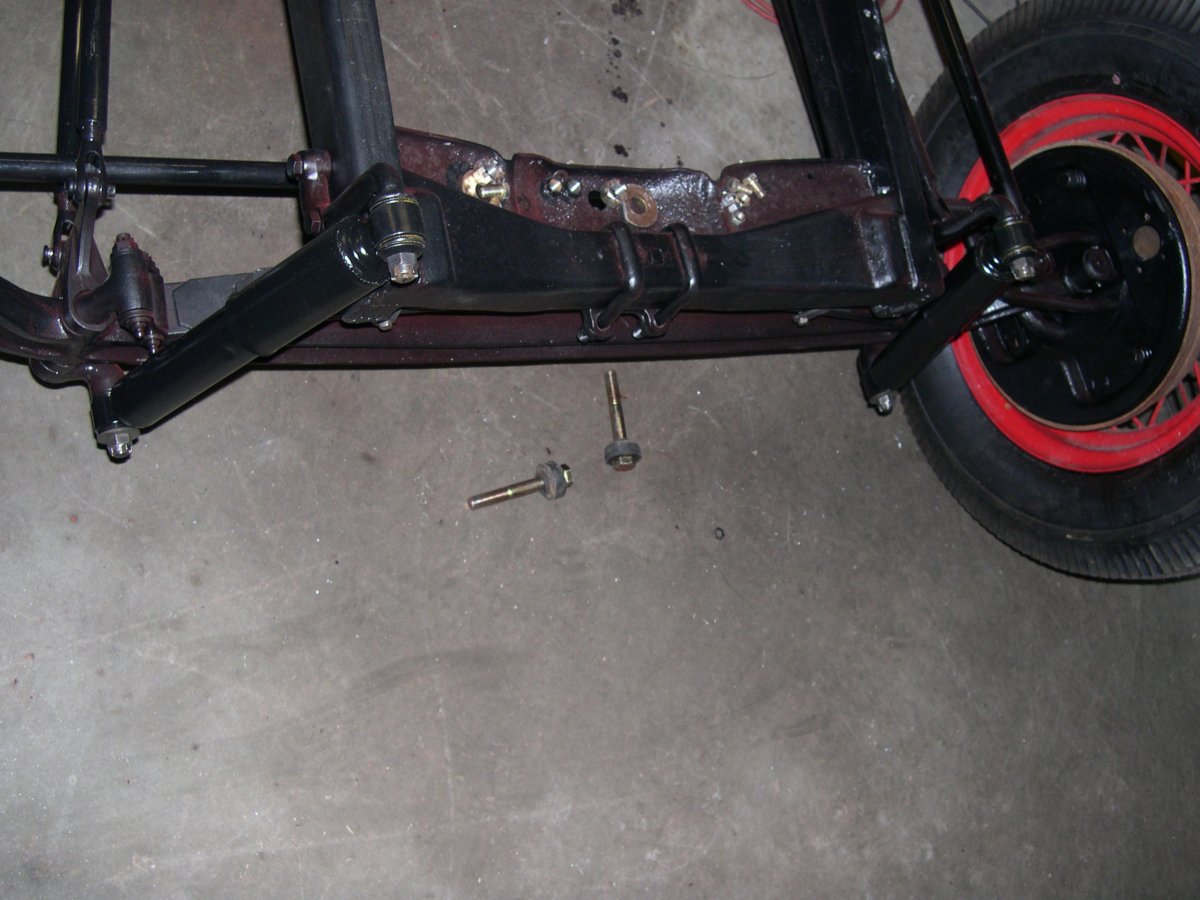

    Its going to be a nice car. I like what you have done so far. the front wishbone mounts look a lot nicer now. Its not always necessary to have lots of machines or even a wheeling machine almost anything can be fixed or made with just hand tools. Your friend did pretty well on the floor panels. Keep up the good work.

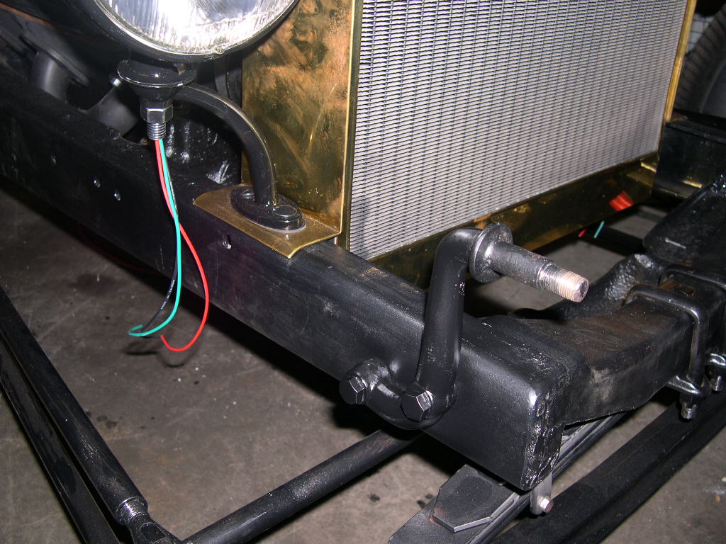

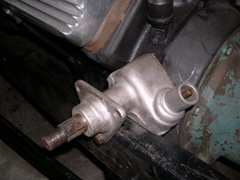

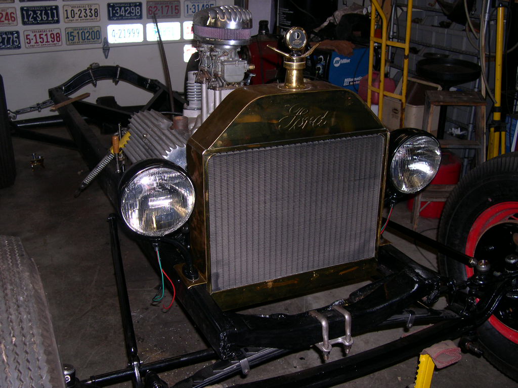

  4. I don't have a lot to report, but I did make a little progress. I got the Austin-Healey seats installed. Had to make a couple of the tracks, since they had been lost at some point. I'll have the seats recovered. Note the F-1 steering column at the far right of the picture. I'm going to need to shorten it by about a foot.

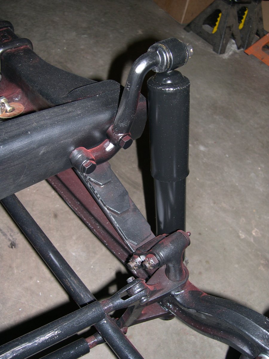

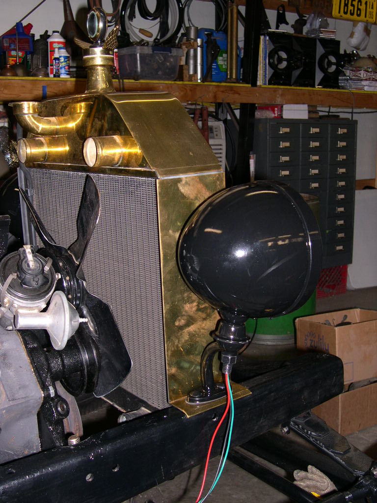

    I did a few small things which don't show much, such as running all the brake lines and welding up the seams at the corners of the sill covers. I also spent a couple of hours fine-tuning the door fit. I had the local exhaust shop make me some radiator tubes to fit. The "official" Flattie ones came out about 5" too tall for my short radiator.

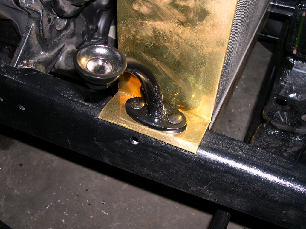

    I had the radiator built (by Superior Radiator in MI) to fit a Model T low radiator shell, so the tubes the vendors sell were way too tall. I asked the exhaust shop guy whether he could re-bend those, but he said he'd just mess them up if he tried. So I had him make me some from 1-3/4" exhaust tubing yesterday. He made them a little long, and I cut them to fit, then painted them. Then I installed them today, using old-style hose clamps. I had bought a big box full of those clamps several years back, and I had used a few of them working on Model T's. So I had plenty on hand now that I needed some. It takes a dozen to do a Flattie.
    They're a small detail, but I think those small details add up to a lot when trying to achieve a Traditional-looking build. Dennis Lacy said in his build thread that he drills bolts for cotter pins and uses castle nuts rather than the ny-lock nuts which come with some modern repro parts because he feels that those details are important. I couldn't agree more, and I'm doing the same thing on my car. I've restored Model T's for about 15 years, and I can tell you that Ford used about a zillion castle nuts and cotter pins per car. ;)

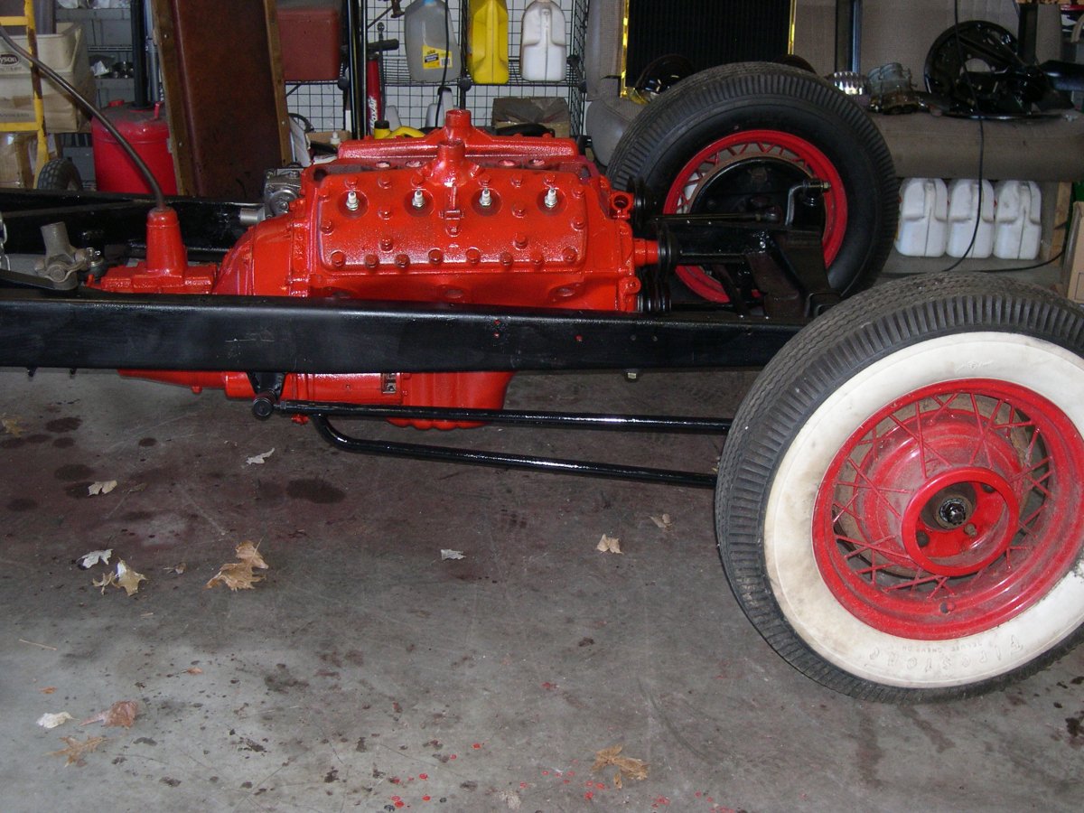

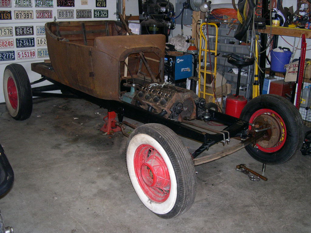

  6. OK, so I rolled it outside to get a profile pic. Tires are 6.00-16's in front and 7.00-16's in the rear.
    The crankcase looks too close to the ground, but I think that's because of the crown in the driveway. Sitting on the level garage floor, there's 6-1/2" of clearance. I've been working on getting the pedals worked out, and I'm about done with them. I'll post pics of that when they're finished.

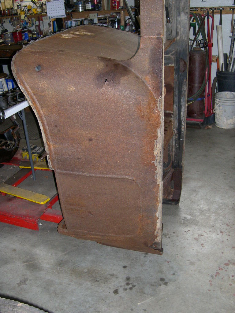

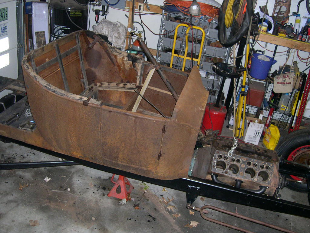

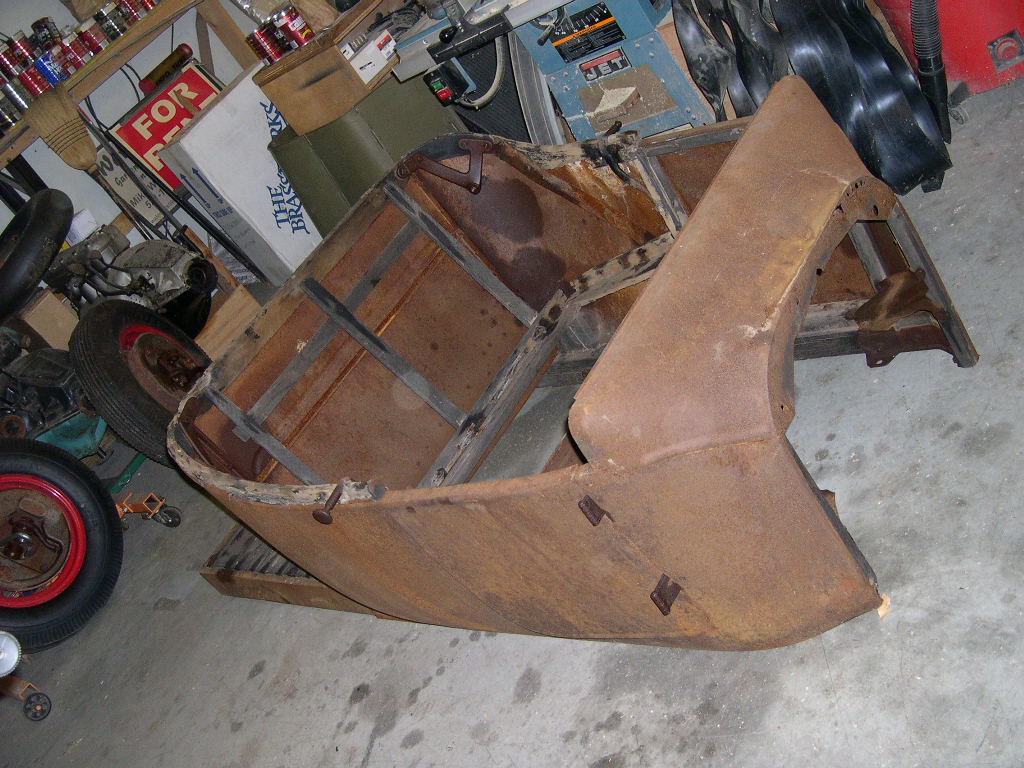

  11. Great job saving that body. It gives me some ideas on how to save my T body. I like that metal "cage" for body support. Might have to steal that :cool:. Did you use 2x3 subrails because thats what the stock wood is?
  12. "Did you use 2x3 subrails because that's what the stock wood is?"
    Yes. It's kinda' overkill, but we just thought it would work out easier to use the same size material as the original wood. We used 1x1 tubing around the top edge and for the uprights. Two old guys still can lift the body. ;)
  13. How did you form the curves in the 1"?
    I had thought of using angle iron as my sub rails to keep the floor low. I guess the floor could be at the bottom of the 2x3. I'm 6'1" trying to fit in a '15 T!! Every 1/2" is going to count

  15. "How did you form the curves in the 1"? "
    We clamped the 1x1 to the center of the seat back, then heated and bent it to match the shape of the body. We had to make two of the bends first, in order to clamp it in place. Then just move along slowly, one guy heating and one guy bending to fit. There are some in-process shots in post #7 of this thread. I don't have any "action shots" because we both had our hands full and there was no one else to operate the camera. :)

  16. Thank you.
    I wasn't sure about bending of the tubing do you know what wall thickness you used?
    Any chance you could pack JD up and send him West?:D
    One more question, Just painting Rust Bullet on that body got rid of all that T rust?
    Thank again I'm hoping to get my T body pieced together this summer, they way you did the inside cage is very well thought out. I bet it made it nice and stiff.
    Make sure an tell JD I have a bunk for him and the coffees always hot and the whiskeys strong:cool:
    Late to the Party likes this.
  17. The 1x1 tubing isn't very thick, I'd guess 1/16" or so. It's plenty strong for what we did with it.
    JD wire brushed and sanded the body panels before using the Rust Bullet. The directions say to remove all the loose rust. It still had some surface rust visible when painted with it, but it was quite smooth by then. I'll have JD go next door to his granddaughter's house so he can catch up on this thread and see your offer. There is no computer in his house. ;)
