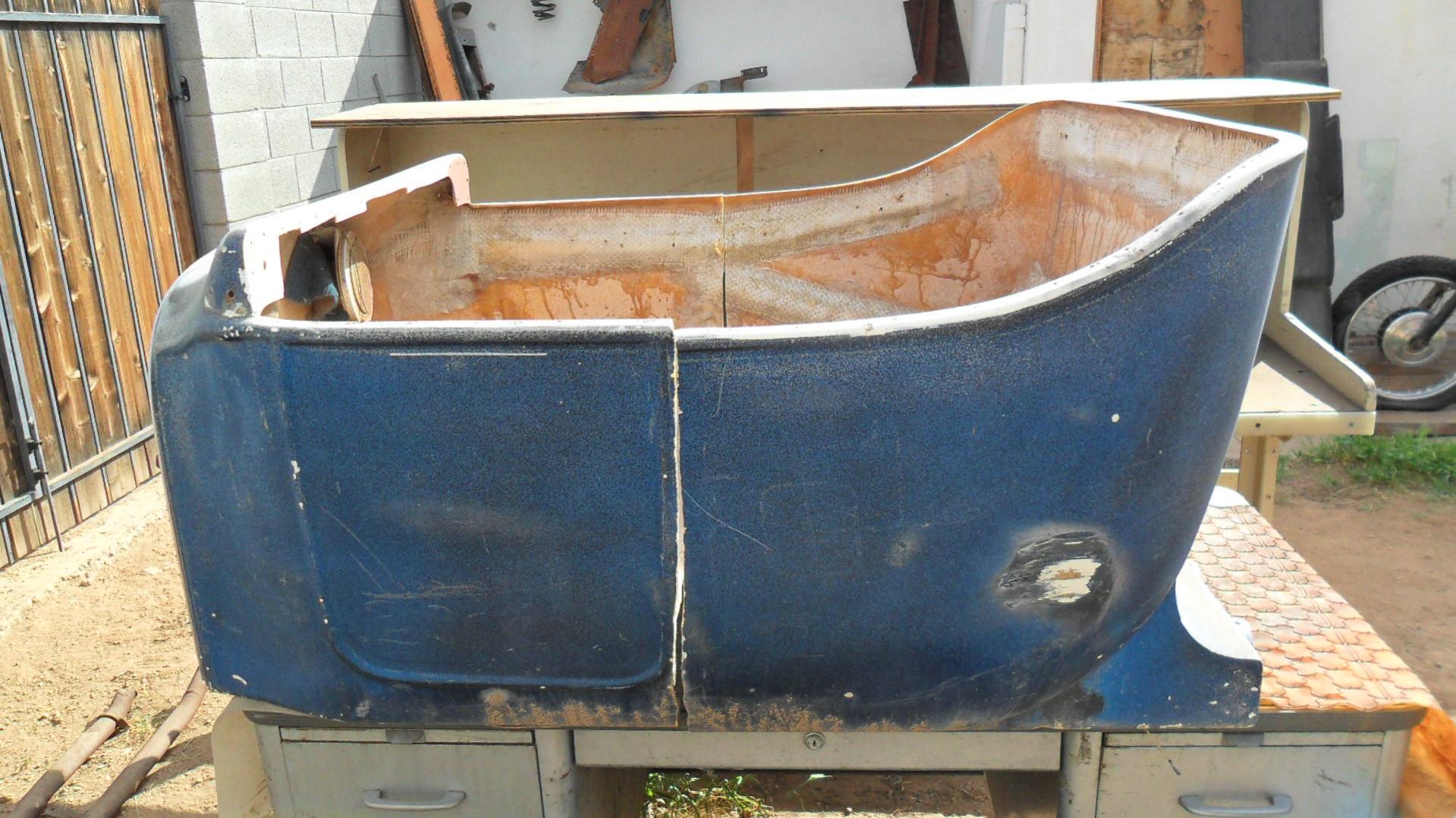

    It seems that every swap I have gone to this winter around here has had at least one 250.00 glass bucket body floating around. Hell, around my house, I just flat had one "show up" in the driveway last summer from a neighbor that was moving and thought I could use it...

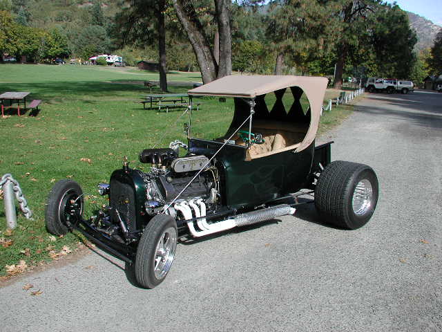

  14. My starting budget for this one was $10K. I came in right around that number.
    My dad and I did all the cutting and welding on the Model A chassis, the 302/AOD came from a junkyard and the body is glass.
    I did buy a ton of stuff from Speedway though....and that's where most of cost came from. Then of course, the wide whites were expensive too. If I hadn't been so particular and had used things like old hubcaps, a swap meet windshield frame and a swap meet steering column, I bet I could've gotten it done for around $8K....maybe even around $7500, but it would've been hard to get down below that unless a guy already had some stuff laying around.
    This was pre-Craigslist, and I bet I could've chopped off some more money by scrounging on there.
    (I used a Speedway steering column with a quick-release steering wheel to make getting in and out of the damn thing MUCH easier)

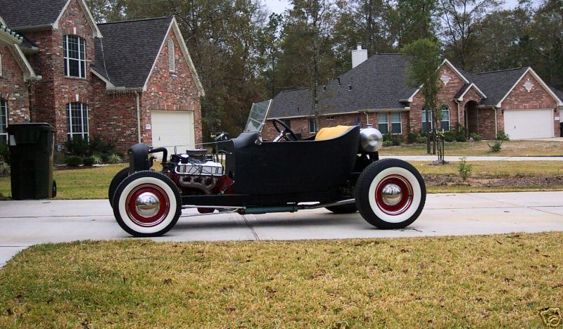

    I've got about 5 grand in this as it sits. It still needs paint and interior but is licensed running and driving. I also already had the engine and trans

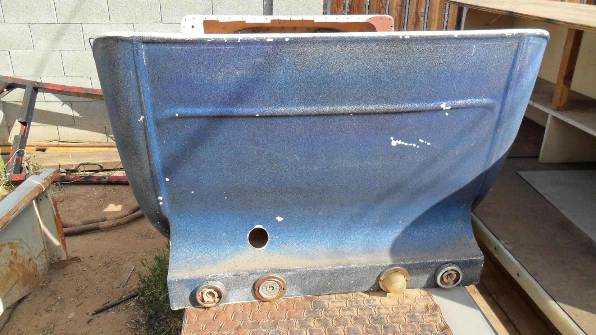

    This is my second body. They can be had cheap. I paid $450 for the bucket. I already had the bed.
