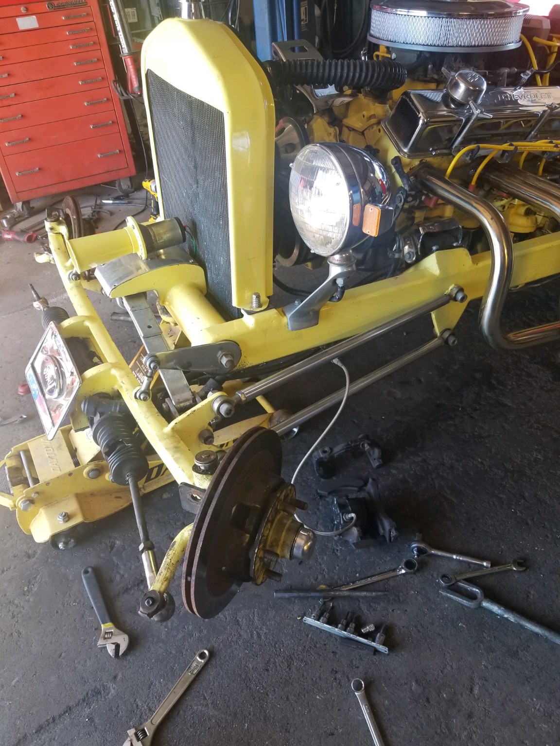

    Trying to help my father in law fix a goofy steering set up he has on a t-bucket he bought. The power steering rack is causing issues with several things, but mainly, my concern is safety.
    The rack’s arms are angled way too rearward when they connect to the spindles causing the wheels to never have a correct toe in. He took it into a shop to have the spindles reversed (arms facing forward) but that made it worse. I don’t know much about t-buckets but I’m thinking this whole rack and pinion needs to be removed and a Vega cross steer system should go in it’s place. He has a power steering pump (Saginaw, I believe but not sure) and I do see they make a power Vega pump. I haven’t seen the car in person, so I’m shooting at the hip with the limited bucket knowledge I have.
    Am I going down the right path thinking this will fix this steering contraption correctly? Also, what other parts will I need to do the conversion correctly?

    I agree, just remove the rack and replace with cross steer. That car is light enough that finding a suitable gear shouldn't be a problem, corvair, vega, etc.
    The tie rod angles are totally wrong with the way its setup and easier and cheaper just to scrap it and replace with cross steer.
    Only down side is losing the power steering BUT with as light as a t bucket is he may not notice it at all and if set up right the steering will feel a bunch tighter more positive UNLESS he has any disabilities and needs power steering.
    If so they do make power vega gears but more expensive. But again a better option then what you have now.
    Good luck and have fun !!

    That whole steering setup is WRONG. Scrap it and go to cross steer. A car as light as a t-bucket shouldn’t need power steering with the right manual box.
    Tman, mad mikey and Just Gary like this.
  4. There's practically no weight on the front end. Motor looks to be at least a foot behind it. Cross steer it, add a panhard bar. Shouldn't need power steering. Flip the spindles back and get the arms facing the rear so you get some ackerman too.

    There's 900 -1000 lbs on the front of the average T , side delivery steering with an early mustang , Vega or corvair box have been done to death , & WORK , many other boxes to choose from , with his 4 link front end , bumpsteer should not be an issue .

    I would encourage you to look for a new front axle , trying to remove all that welded on r&p garbage may be a " not worth it " situation .

    Cross steer on this one is going to be tough, with the axle that far ahead of the frame rails, and the radiator about where the steering box would mount. I would go with side steer.

    Thanks guys. Yeah, my father-in-law bought this already built then took it to a shop to have a few things fixed. I knew right away looking at it this wasn't right. Can you guys recognize what spindles they are? I went on Speedway's site and think they are Ford but not sure the year.

    Model A axle, 42-48 ford spindles

  19. ^^^ Mustang box would be the way to go IMHO. And probably another axle since someone welded all that crap onto it.
  20. Is that a trailer spring? :confused:
    Personally, I think it's start over time.
    mad mikey likes this.
  21. That does look like a trailer spring.:eek:

  24. I love the H.A.M.B because you always get 3 different answers to any one question, and then there's opinions. My outlook is,, what's wrong with a Ford Axle just because someone has welded on it? Don't look like any weld has failed and the Axle isn't bent. It's on so I say leave it till something goes wrong with it. Your right, it looks like a Trailer spring. I bet it don't know it's on a T Bucket. If it carries the load and your Dad like the ride, what's the problem? If we were building it from scratch each one of us would do something different. This fix it job don't need to brake the bank or start from scratch. I agree the Rack is a dumb idea and don't work, that's all that needs to be addressed for now until something else comes to light. Keep it fun and get it done, don't reinvent it. Heck if we're just going to pick it to pieces, I wouldn't have built the spring perch as it is but it would still just hang the spring.

  28. Maybe I'm not seeing things correctly...but is the driver side kingpin missing the bearing? Or maybe it's been apart and is in process of mock up.
    If the spindles can be swapped side for side (sometimes difficult on suicide/t-bucket front suspension) the steering geometry (ackerman) will be much better. As others have said, the Mustang option should work well.

    It’s apart in someone’s shop he took it to in hopes of having it fixed, but he couldn’t figure it out. It’s back together at my Father-In-Law’s house and will be here next week.
    Jumping online to see about parts. I looked at the Mustang option, but seems the Vega cross steer would be better. Either way, it’ll be better than the contraption that’s on there now! Would a spindle swap be necessary with this to allow the cross steer arm to be bolted to the spindle? It appears since the right spindle (and left) has the steering arm cast as part of the spindle, that gets hacked off then another arm bolts to the bottom. Is that correct? I see Speedway # 7022754 1-3/4” drop steering arm may be what I need, or the other that’s just straight #91632029. He’s decided a new tilt column will go in as well. Not sure why he just didn’t build the darn thing from scratch! ;-)
    I also plan on going over all the welds to look for cracks. I don’t know how old the car is or who built it, but I’ll double check everything too.
    (EDIT) Just zoomed in on a picture of the right spindle and the outer tie rod end was hacked off. So with that, replace the whole spindle with a non-hacked one or lop the rest of the arm off and bolt a new one on (if the lower steering arm can be bolted on)???

    I think Marty is correct. The drag link should as close to parallel to the tie rod as possible. Vega Steering.png
