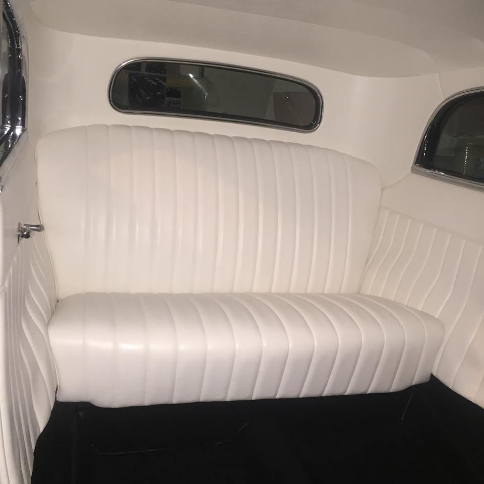

  6. ABS panels are the way to go; they can be easily shaped with a heat gun. Here's a pic of a one piece rear window panel my daughter-in-law shaped out of ABS for a '33 sedan she trimmed. If you get a full wrap with ABS in a sedan; T bucket quarters should go pretty good.
    loudbang and tfeverfred like this.

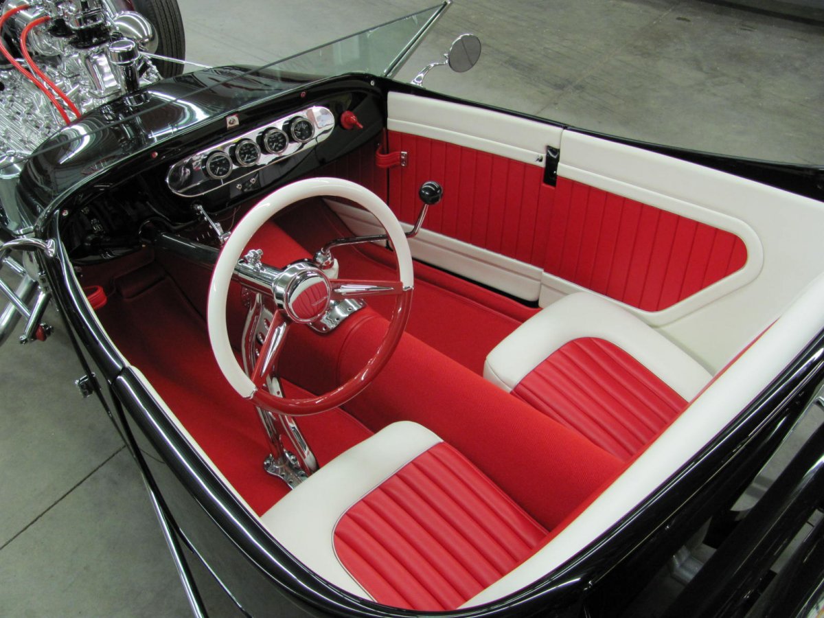

  21. hotrodscott2003
    Joined: Jul 1, 2008
    Posts: 405
    hotrodscott2003

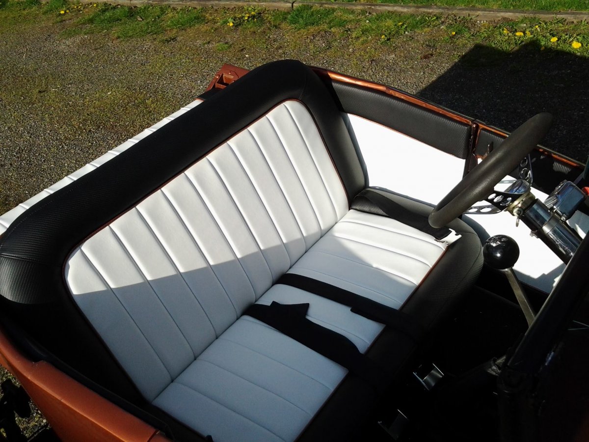

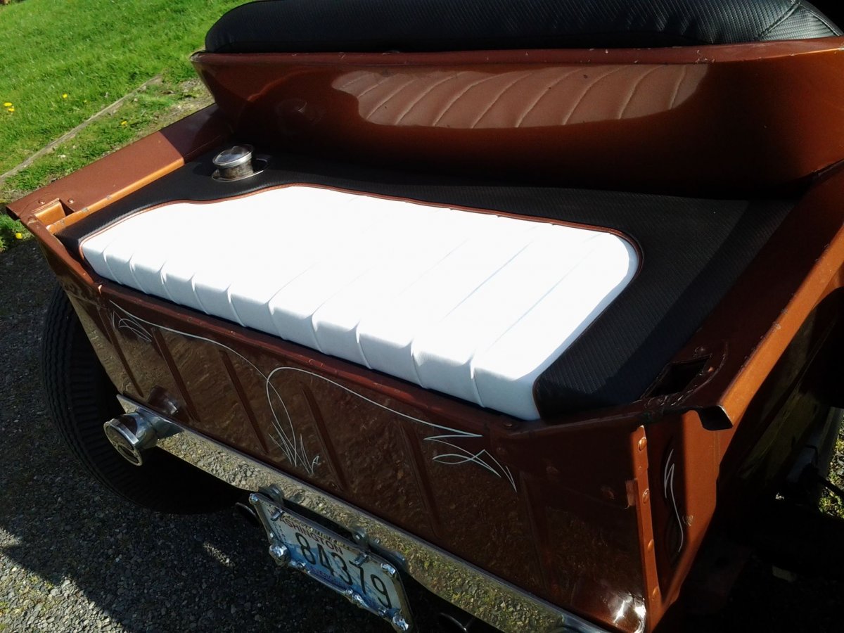

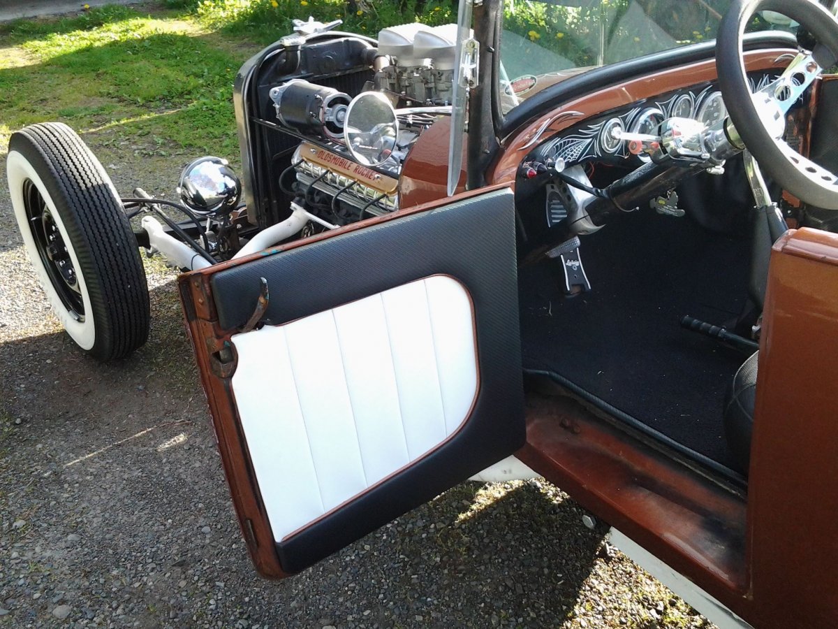

    Here's mine. Black with white pleated inserts, custom piping that matches the color of the car.

  24. captainjunk#2
    Joined: Mar 13, 2008
    Posts: 4,420
    captainjunk#2
    i like the black and white interior , excellent work and execution

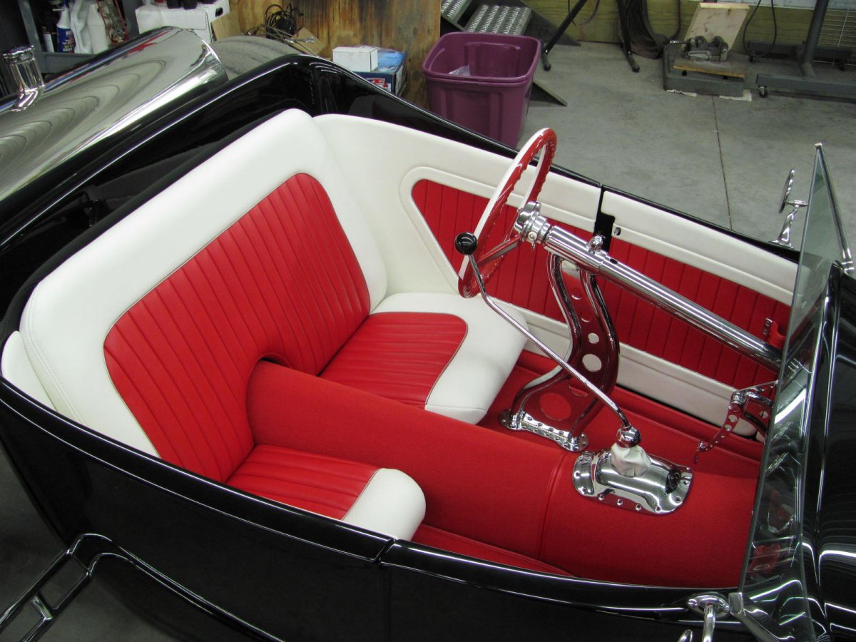

  25. DaPeach
    Joined: Apr 22, 2009
    Posts: 260
    DaPeach
    from NE OH
  26. tfeverfred
    Joined: Nov 11, 2006
    Posts: 15,791
    tfeverfred
    Beautiful work. I think I'm going to TRY and take advantage of the extra room I'll have and make my back panel about 3"-4" thick. With the back panel starting up and tilting back, where the kick up on the frame is, loss of space would be minimal. That's what my sketches tell me, anyway.

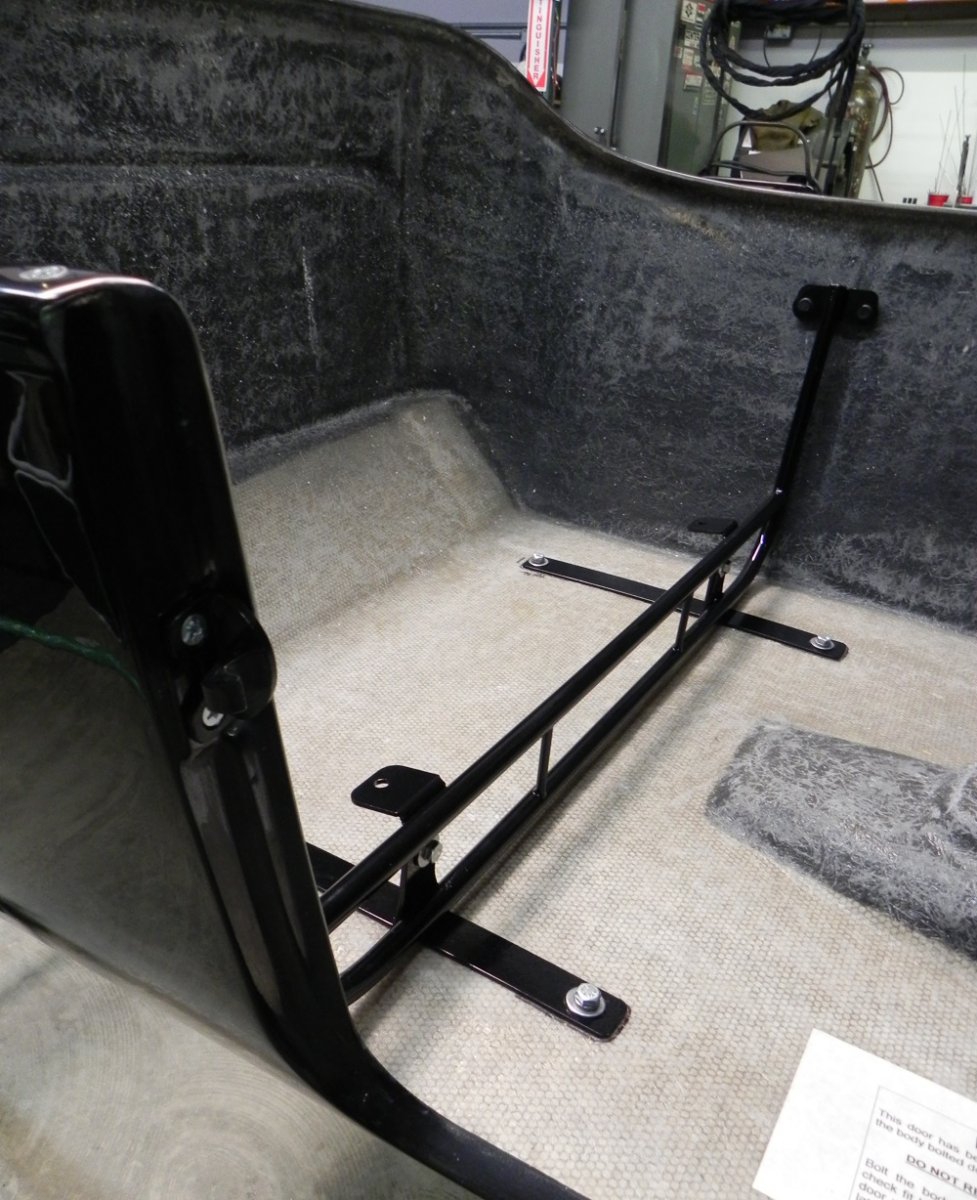

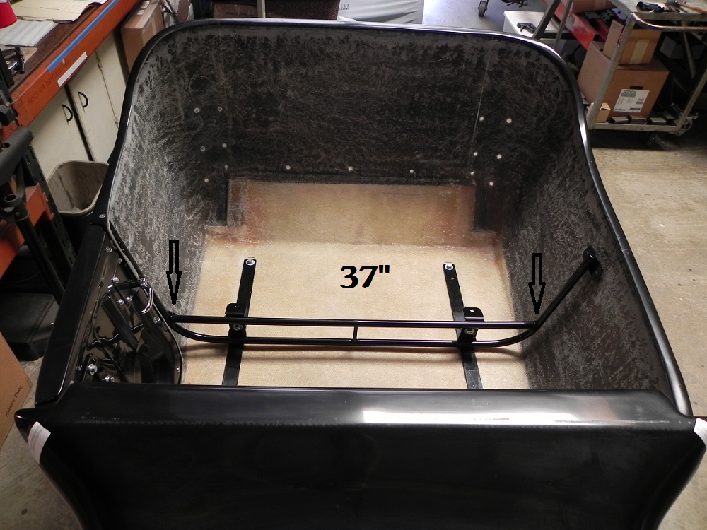

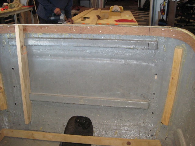

    I was searching solutions for the back piece and found this website:
    http://www.catalinacustom.com/showc...case_gallery_street_rods_23_ford_t_bucket.htm
    It shows a few ideas on making an interior in a T Bucket. What caught my eye was a possible solution for the back panel. I'm assuming two pieces, one on each side, were used. What I don't like is the amount of interior space it appears to use. Maybe a couple pieces that narrow as they approach the top edge of the body. That would create a slant to mount a back piece to.
    The CCR body has a 1 1/2" ledge that would support 2 or 3 sloped pieces. They could be 'glassed in with minimal effort.
