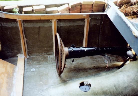

    My T body is from Class Glass and Performance. It already had wood substructure when I bought the project. I think that the body loks pretty strong.
    I have Speedway windshield posts and had to do a bit of body work to make them fit. It wasn't very hard. I am NO body man!!
    Be advised though that the body is 8" longer than normal so some won't consider it a T-bucket. The extra room is nice though!
    I found some at work, actually on Photobucket.
    The day it was dropped off:
    Interior the same day:
    Interior with the bare seat:
    Bill

    All I had to do for the windshield post was put down a couple of layers of resin/mat and some filler, I think that I used Duraskin it has fibers in it. Then I sanded held the post to the body, sanded high spots and filled low spots. It really wasn't hard.
    I used the resin and mat because I had to make the body a little wider so that the windshield frame would fit. The frame was a little tooo wide for the body about 1/4" if I remember correctly.
