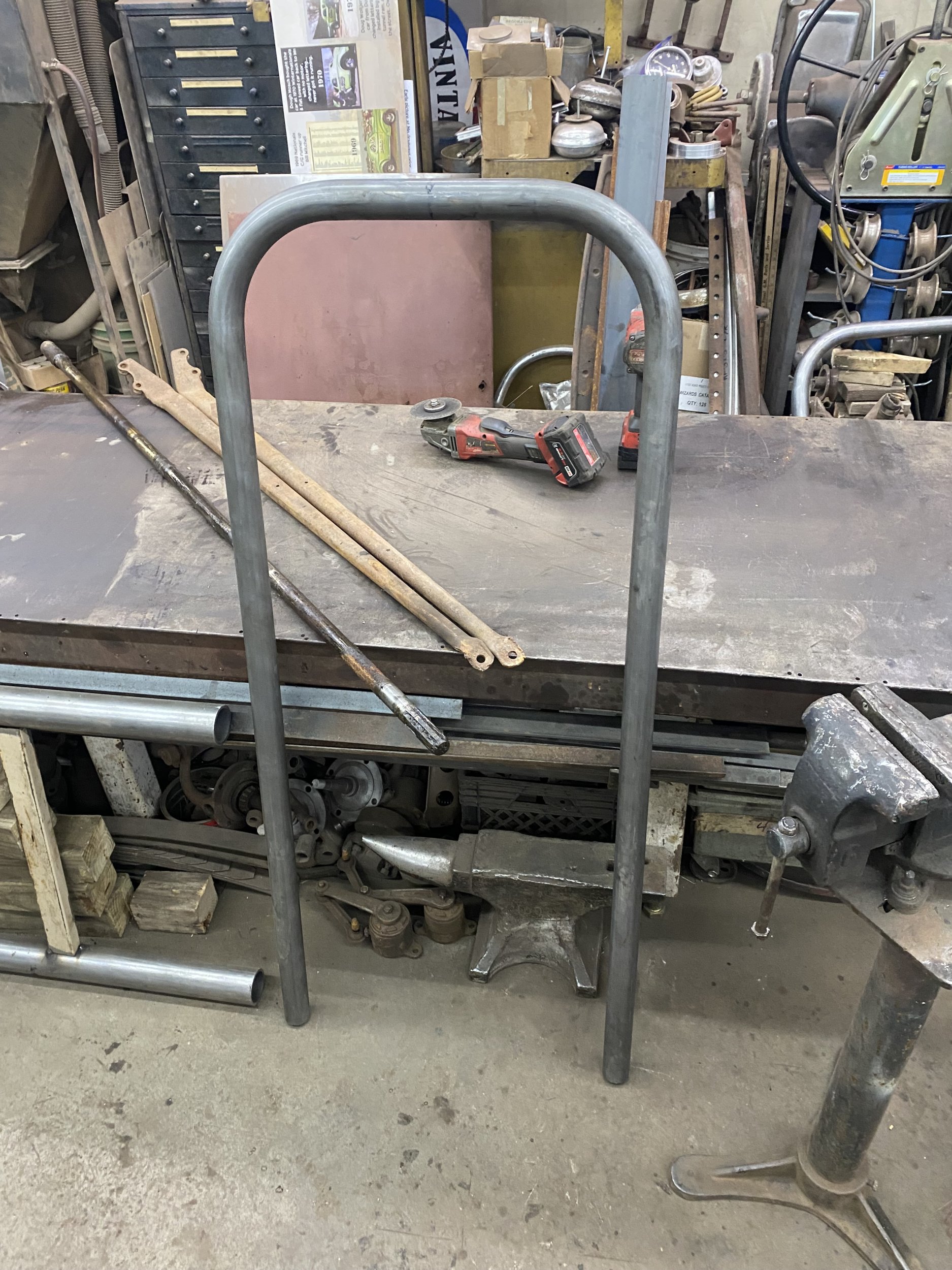

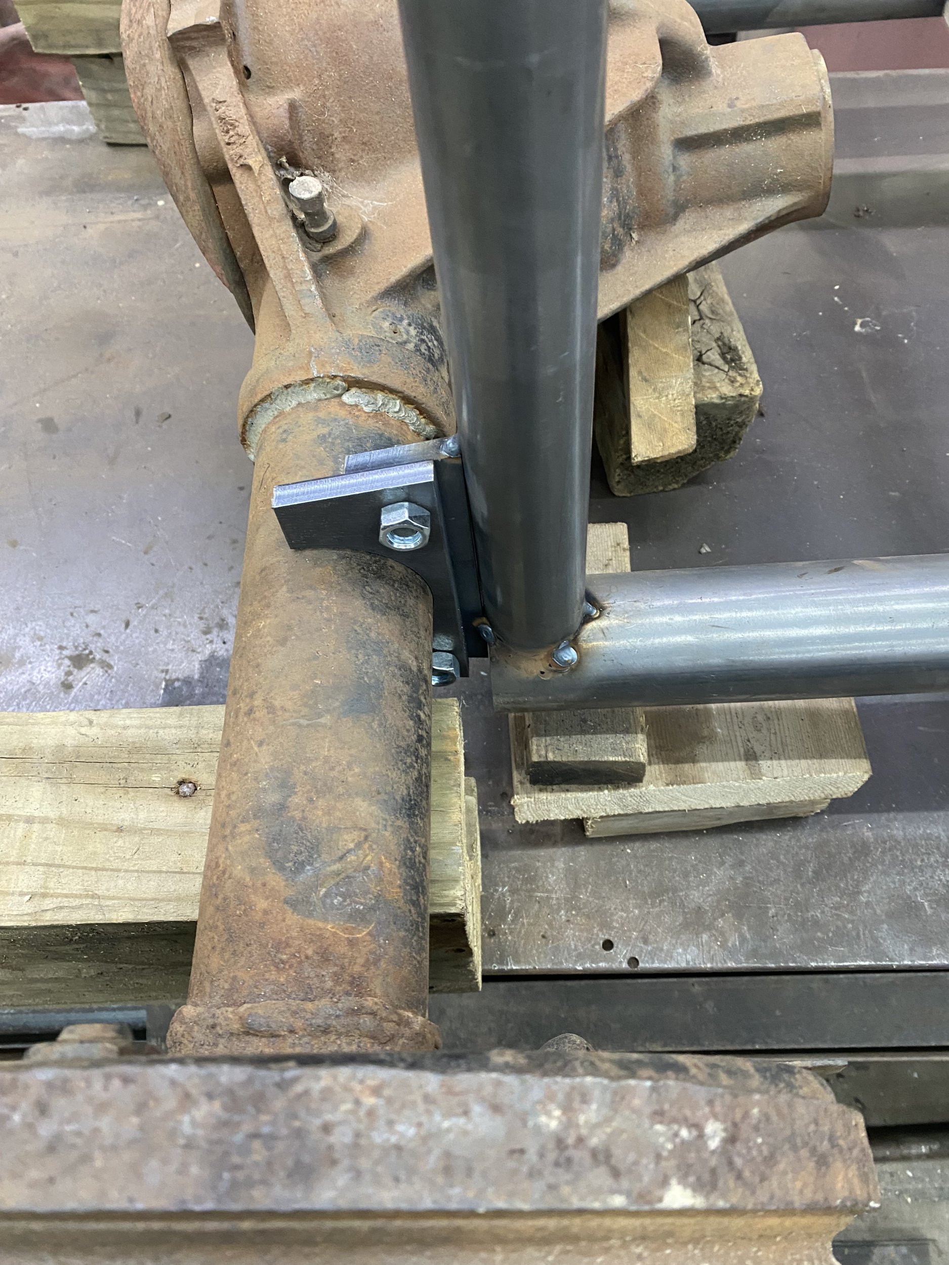

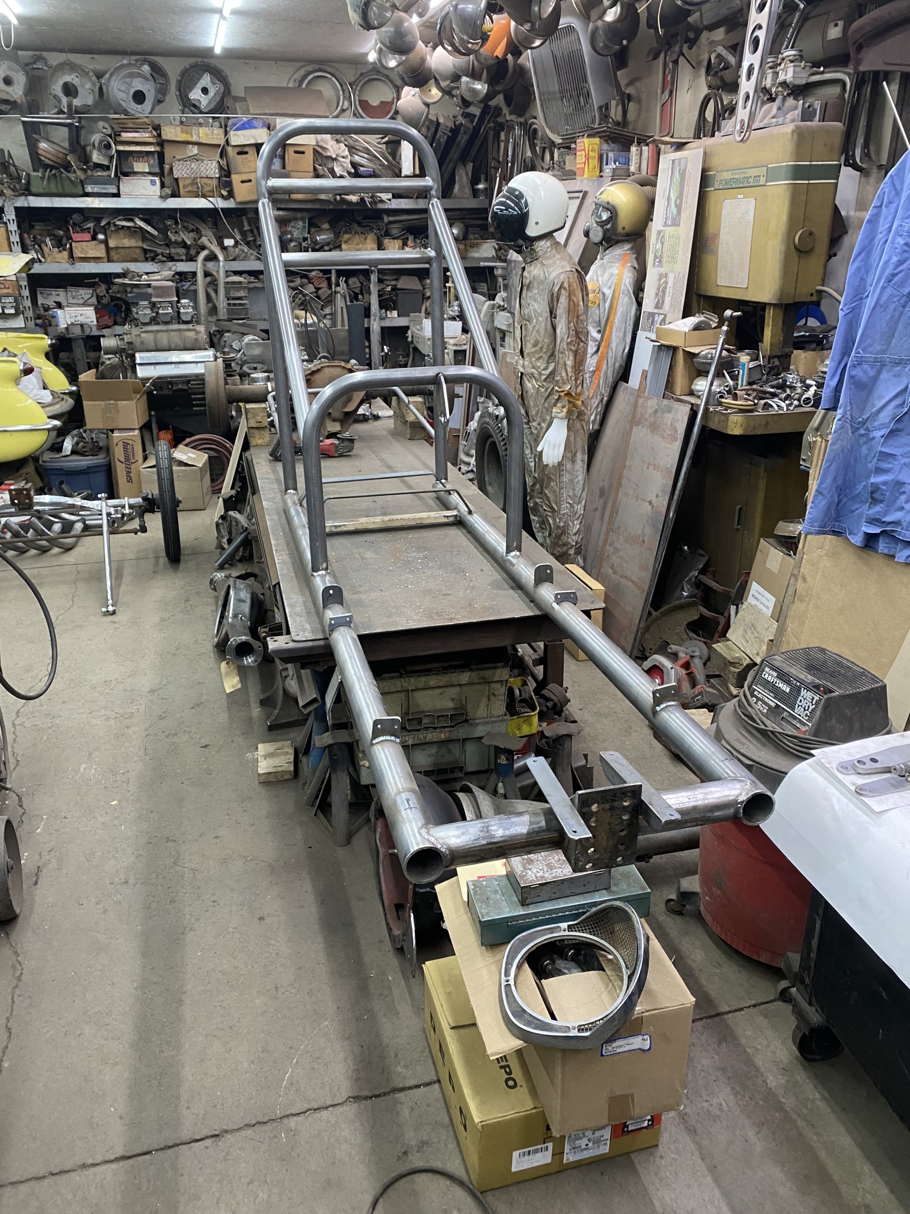

    Made a little more progress, side tracked with other more important stuff, got some hoops bent up, had a buddy draw some rear end mounting brackets up and got then cut out, got rear roll bar in and rear end brackets tacked in and rear tacked in, then got the body mounted, now time to start getting the motor/trans mocked up/mounted

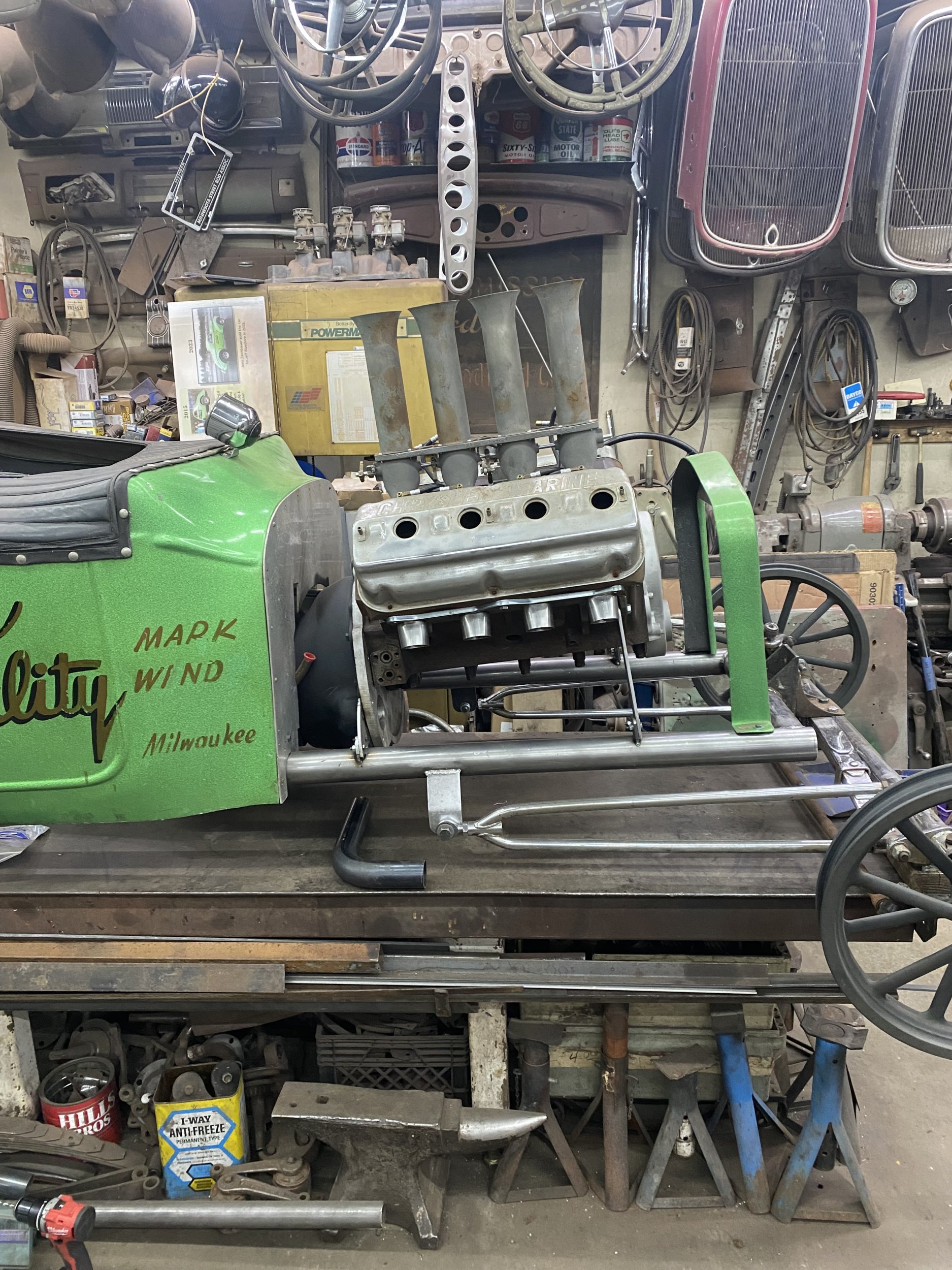

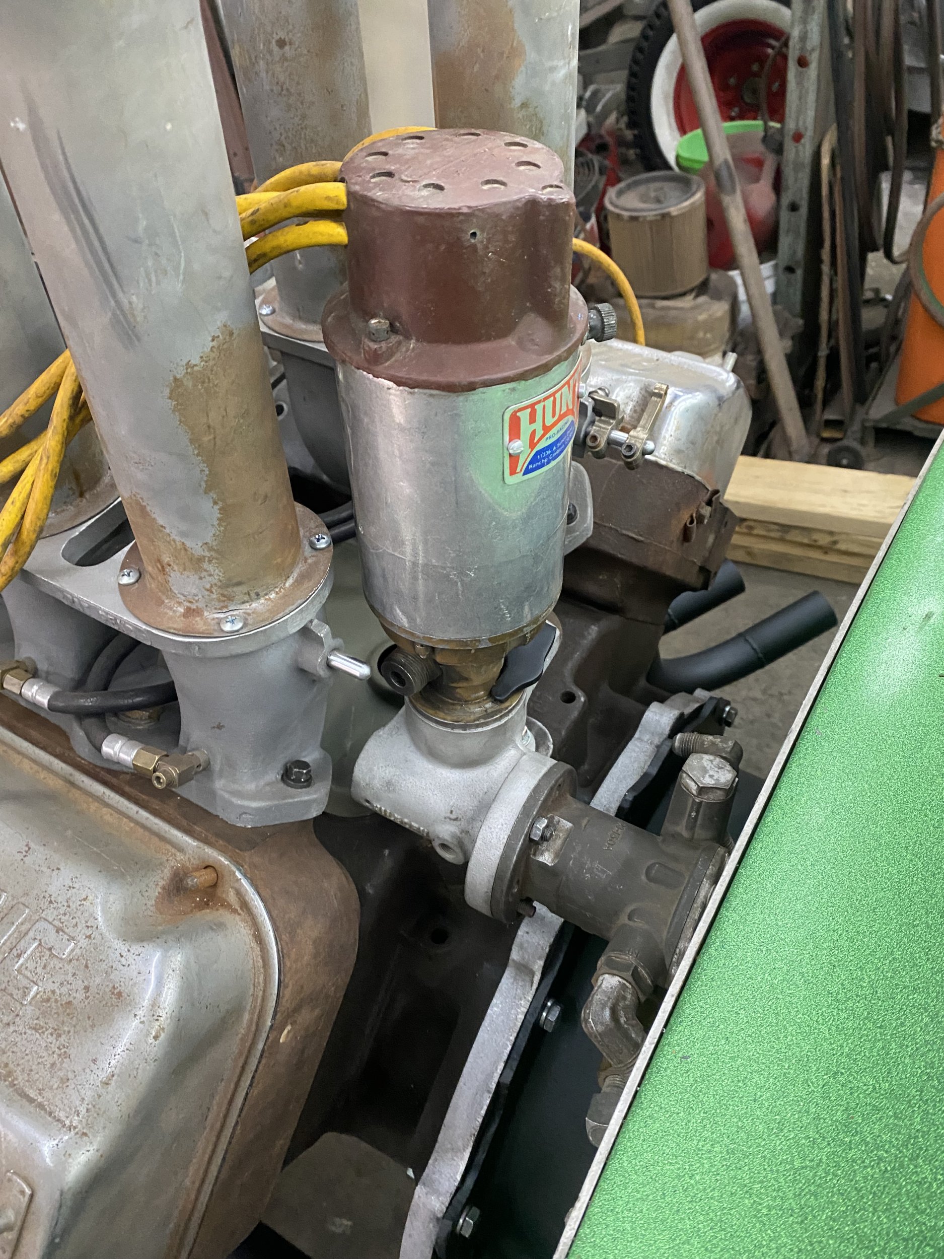

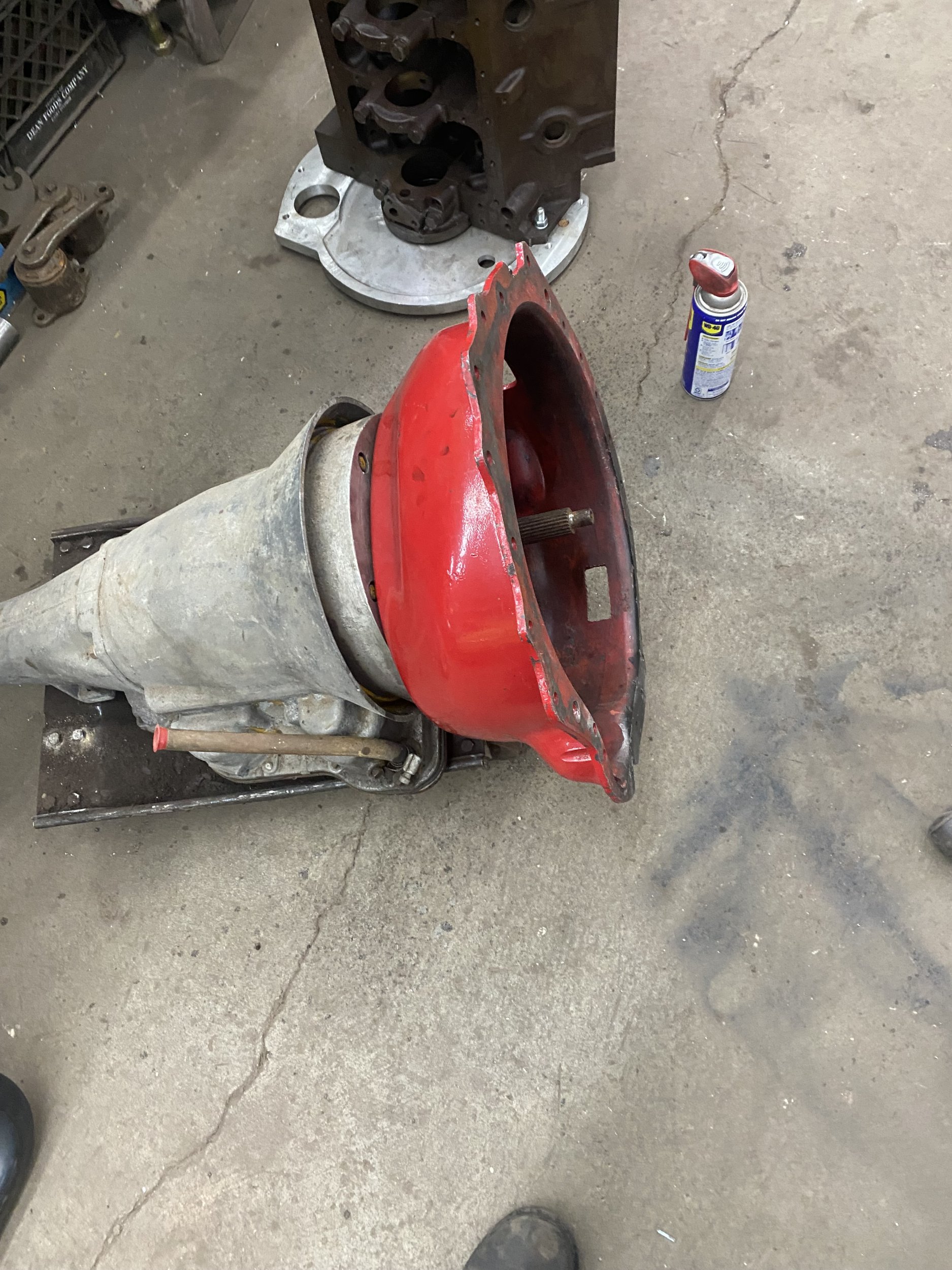

    Made a bunch more progress, rounded up some killer palamides 18” 12 spokes, found a lakewood bellhousing, got the clutch-flight attached to the hemi, got it slung up in the chassis and got motor mounts made and mocked up the rest of the motor including the hemi stack injector. last night i tinkered on headers

    Clutchflight included or did you have one. Pretty rare as well. Super cool find! Looking forward to seeing it progress! Thanks

    i bought it locally about 10 years ago, been on the shelf waiting for the perfect project!!

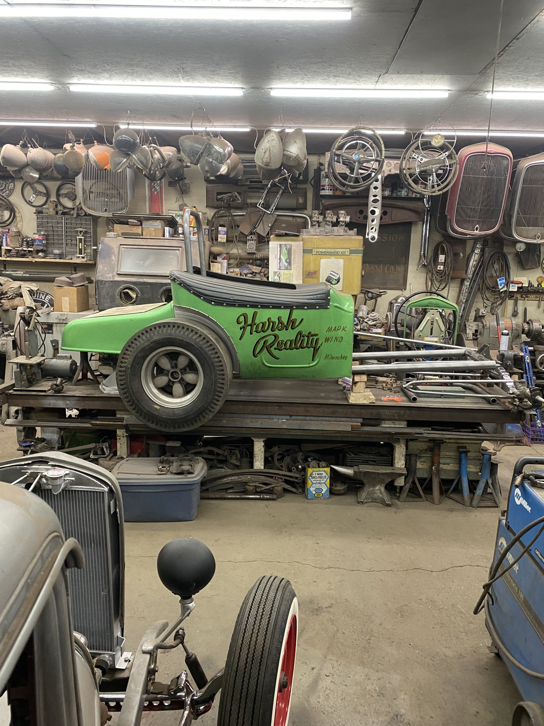

    i realized the forgot to do an update, i had the car at GSTA’s 67th annual rod and custom show back in April, i had been busting butt on it to get it rolling for the show, turned out pretty good, still need to build a motor for it at some point and of course lots of other stuff

    Is that your "Altered Ego"?! Love it.

    That is incredibly cool! It's great that you found it, not too many folks could bring it back to life.
