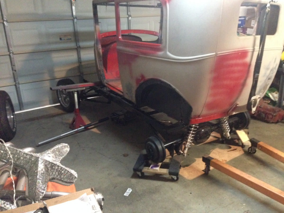

    Was just checking if anyone thought of putting a sway bar on rear of model a.
    I'm running coil over shocks and seem it needs a little stabilizing .Can you really tell the difference after installing one ?Any in put on this subject would be grateful.

    This is what my setup is if you can tell by the picture

    I'm assuming that you are running ladder bars, or similar and a panhard bar, pic is not really clear. Have you driven it? The reason I'm asking is based on the pic it looks like it still under construction. I have the same setup in the back of my car, no anti-roll bar, handles just fine, granted mine is very low. If you still feel you need an anti-roll bar, there are kits available from the circle track suppliers that would work well, some are even adjustable.

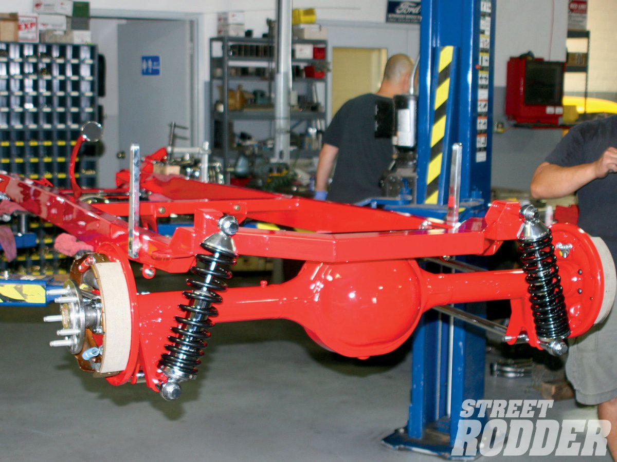

    Your coilovers are mounted too close together. They will be more stable the farther out you can move them without interfering with the wheel tire combo. 1004sr_16_o-model_a_signature_chassis-rear_suspension.jpg

    Your shocks at the top look to be to close , but it might be the angle of the photo ,
    Your coil over's look beefy , are they the wright sping rate ,

    I have not put her on the road yet ,its still under construction .
    I'm just getting some input ,this is my first model a build .
