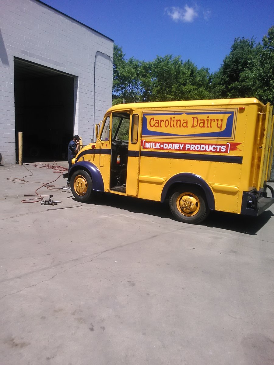

  3. KIMG0138.JPG Their is a company called wheels now in Waukesha Wi.1-800-782-5145ask for Cory he just hooker us up with new ones for a divco milk truck. the fronts are new the backare the old ones . Tell him the pineapple boys sent you.

    Are those 19.5s on the Divco? Are they radials?
  12. Yes and yes , they made a big difference in the handling on the milk truck. The guy in the commercial tire place we got them from said they would be the steering tires on a semi.
