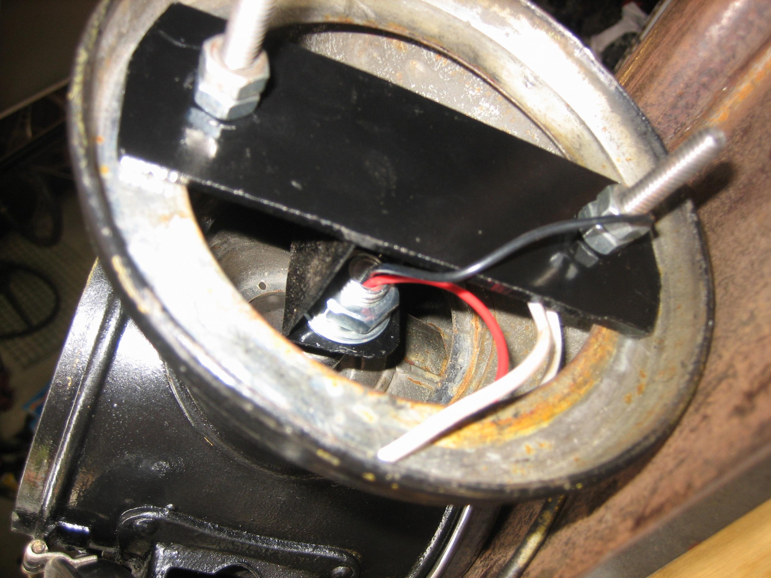

    Got my old tail lights working again with parts out of a new set of trailerlites set HF @ $9.99, as you see I've desided to use the bigger headlite side this time for more saftey,by using red trailer lenz behind big clear side will be briter. vs small thick red glass side I used back when there was a lot less crazy driver in Miami Fl. The wood back panel will be covered with stainless steel* vs old alum sheet I had there before. I have kept the stainless for a time now for this use,my buddy Rosh was working at Miami Airport when they were tairring down one of the old buildings,they trashed a art deco wall of dimpled stainless steel paneling,so Rosh put it in his truck and gave it to me. You'll get to see that later on when I make both fire wall and back panel out of that..to replace the bad alum back pandel that is now nasty dull and bent.

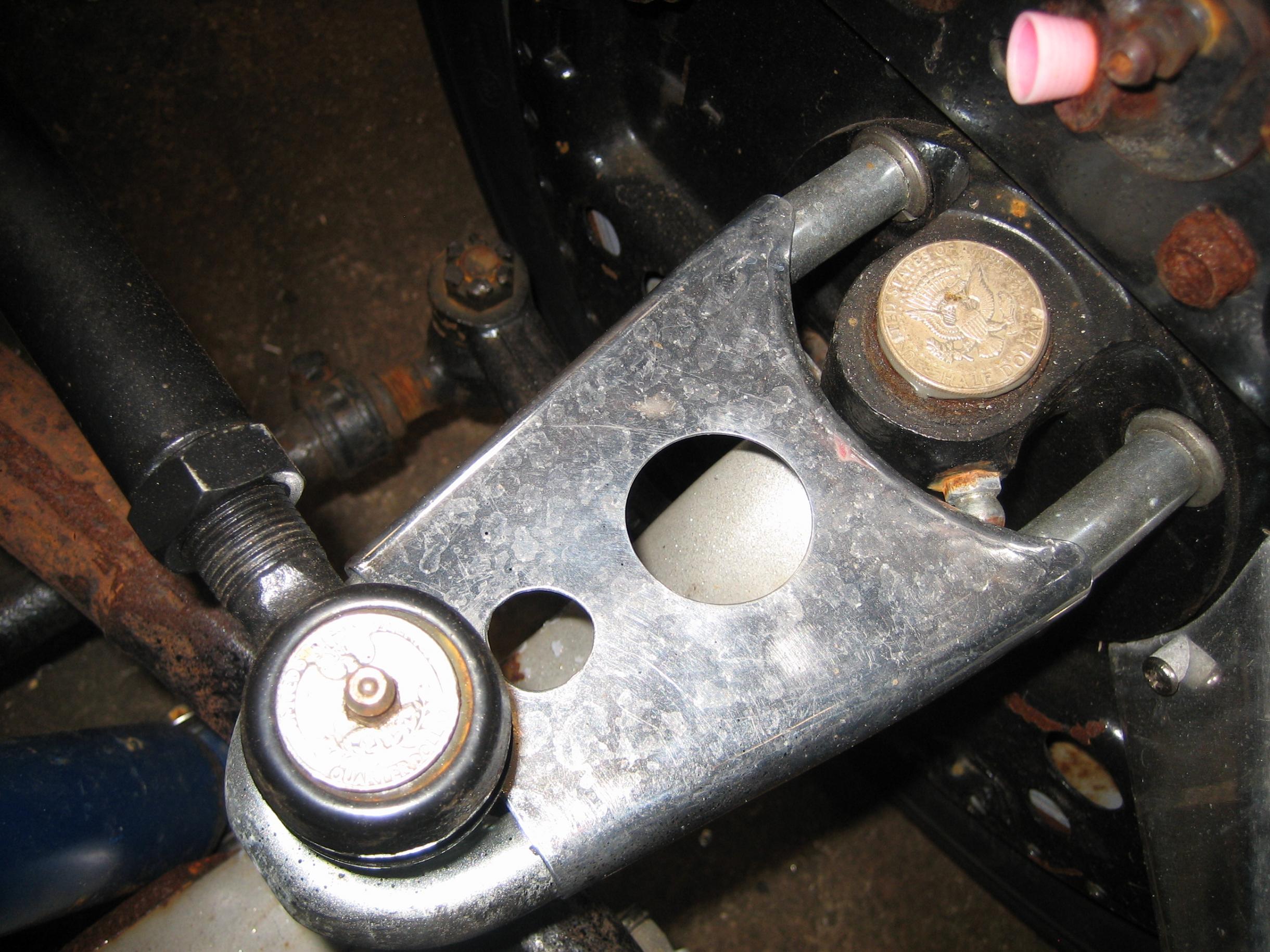

    Today we see a lot of shock mounts and headlite stands that all look the same pretty much,but back when I built my rod,we were mostly on our own to come up with stuff and make it work.
    Some more old detail,the shock stands are from front of 1948 Ford car that I drilled a lot and headlite stands are a little bit modafied 1928 modal A cut and bent front fender braces,the bullet acorn nuts are off a MC , I have a nice new alum rad now that I fitted into my old 28 chopped down shell.
    Nuts and bolts that hold stuff together are stainless steel that were rounded by me and polished. This will all look shiny and nice again when I'm closer to being done with rebuild.:cool:
    If you look hard ya can see a 25cent coin on my steering rod end at the very bottom of photo with a grease zert fitting through it,for extra shiny spots.

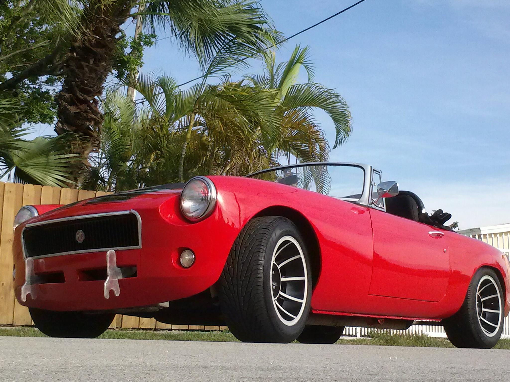

    For "gunswanted";My buddy John Fenner's MGB 350SBC V8,he bubbled the fenders , customezed the hood and roll pans,rebuilt the framing ect.,bad fast little classic sports car hotrod.
