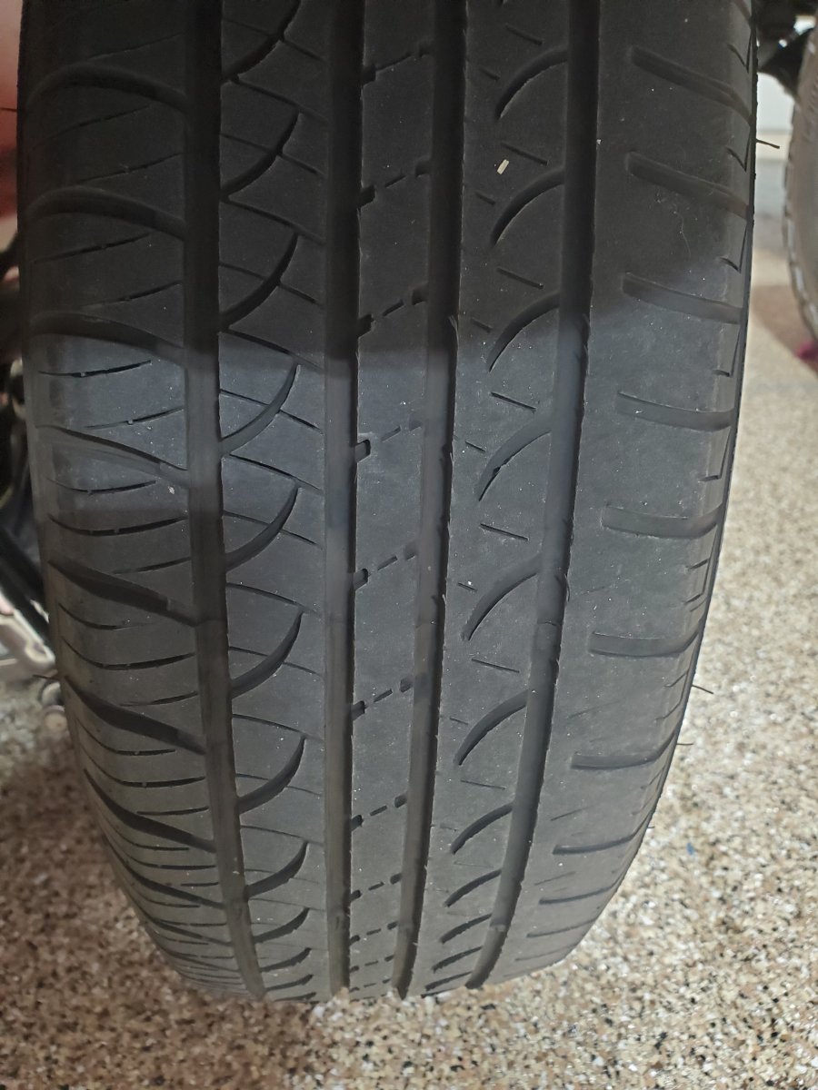

    My 32 straight axle car is wearing both tires on the Outside prematurely. I this a product of worn kingpins and bushings or is another shim/adustment issue. I am ignorant on straight axles and need advice on where and what I have that is causing this. It seem to start when I bought new front wires and change the offsets to get away from the rotors.
    thanks for any enlightenment or advice.
    Larry

    More likely to be toe issues, or scrub, or a combo. Pics help.

    Sounds like a toe in issue to me?

  5. I agree with what others have said, check the toe. If it was worn king pins/bushings, you (in theory) should see wear on the inside edge of the tire.

    So your new wheels moved the tires out farther (more offset)? That would induce more scrub. Might be the problem.

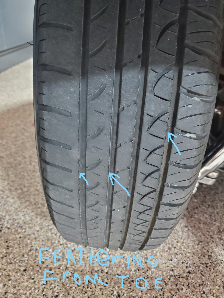

    No expert here but that feathering on the worn side I think points to toe issues. Measure / get checked. Should be in the 1/8"toe in ballpark.
    Pics with a straight ahead view of the inside of the wheel would help get a view of any scrub issues.

    thanks to all, will have the toe dialed in professionally and also all new Moog tie rod ends.

    If you slide your fingers over the tread you can feel that the tread is pushed to the inside, You can see that it is worn off on the outside of the tread bars and that there is a pushed out sharp edge on the inside meaning excessive toe in. Your fingers will catch on the feathered edges of the tread pulling towards the outside and slide over the tread sliding towards the inside.
    That's not to say you might have slightly excess camber but I don't think you can do much with that axle as far as correcting it if it is off. Desirable would be 1/2 + on the left and 1/4 + on the right or 1/4.
    1/16 to 3/16 on the toe in.
    If you are going to do the toe in adjustment yourself raise the tires a few inches off the shop floor, get something solid to steady your hand and hold a pencil to the center of the middle bar of the tread and scribe a line all the way around the tread as you slowly spin it with the other hand. That gives you an accurate place to measure from as it compensates for any runout in the tire and wheel. I've done hundreds of them that way in a shop where I only had a caster camber gauge and a bare bones front end rack and a tape measure. feathered tire_LI.jpg
