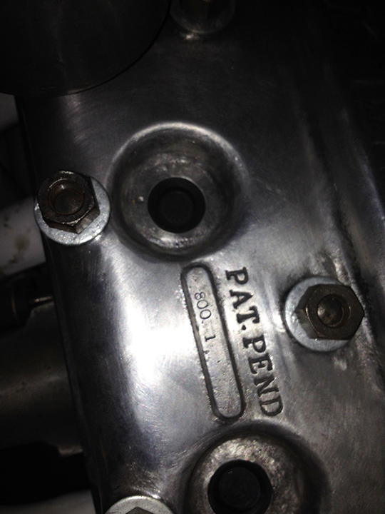

    This is the only markings on the head.
  5. Cool! Winfield normally used the first digit of the serial number to denote compression ratio; Yellow (6:1) heads had serial numbers beginning with 6, Red (7:1) heads with 7, and so-on.
    Super Winfield heads are a little more complicated; they were made under license (perhaps by Bell Auto Parts) probably in the late 1940's-early 50's...it appears that the 8001 "serial number" indicates an 8:1 CR.
