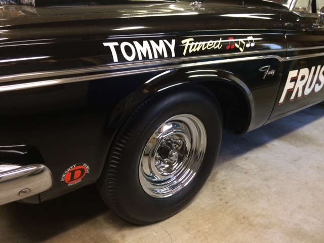

  13. Frustration
    Joined: Sep 11, 2010
    Posts: 67
    Frustration
    from PA
    Here is a photo of our '63 with the 6.70 x 15" tires you mentioned. There is also a youtube video showing the car running these tires two weeks ago. Search "Frustration at Cecil". Good luck. Tommy Front Cokers.JPG
  14. earlymopar
    Joined: Feb 26, 2007
    Posts: 1,315
    earlymopar
    Look great Tommy!
    - EM
