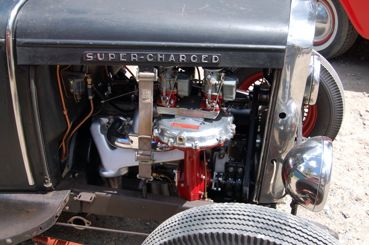

    I was pondering about fitting a supercharger to my pickup wondering if anyone else has done it and or had any luck ImageUploadedByH.A.M.B.1449021517.815426.jpg

    FWIW, a small turbo is much easier to do on a flathead and just as HAMB as the supercharger you're showing.
    I've got a pair of SU carbs off an MG Midget I've been saving for just such an application, cause I saw a photo of a Brit build which looked trick.

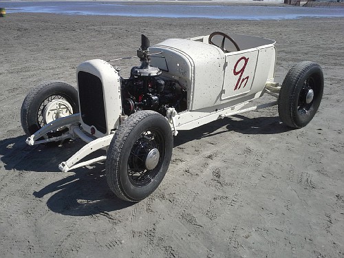

    There was a thread on this a while back, some guy built a roadster for the TROG with a Ford tractor engine and Graham supercharger. He was dubious at first , but we encouraged him. In the end he was impressed with the performance, and remarked that he expected the motor to give up at 3000 RPM but it just seemed to keep going faster and faster, which was more or less what I told him to expect. The car gave a good account of itself in the races in spite of being only 130 cu in, probably the smallest motor there.

    Here is one that was at the Georgetown Hill Climb. It is a Graham supercharger. The installation was well thought out and nicely done. I'm going to steal some of the ideas. I believe the blower has about a 5 psi output. One disadvantage to a centrifugal blower like this in this kind of application, is it doesn't like sudden RPM changes. Hard on drive components. DSC_0117.JPG

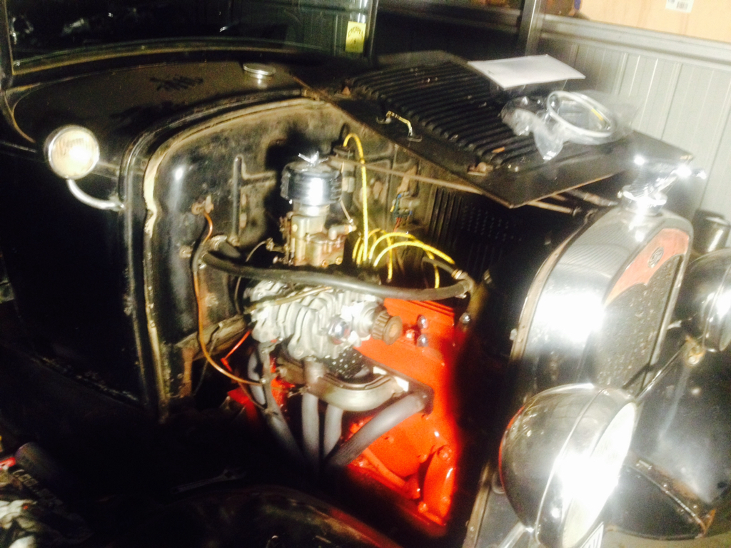

    My 214 cui banger equipped with a 1934 Graham Supercharger.

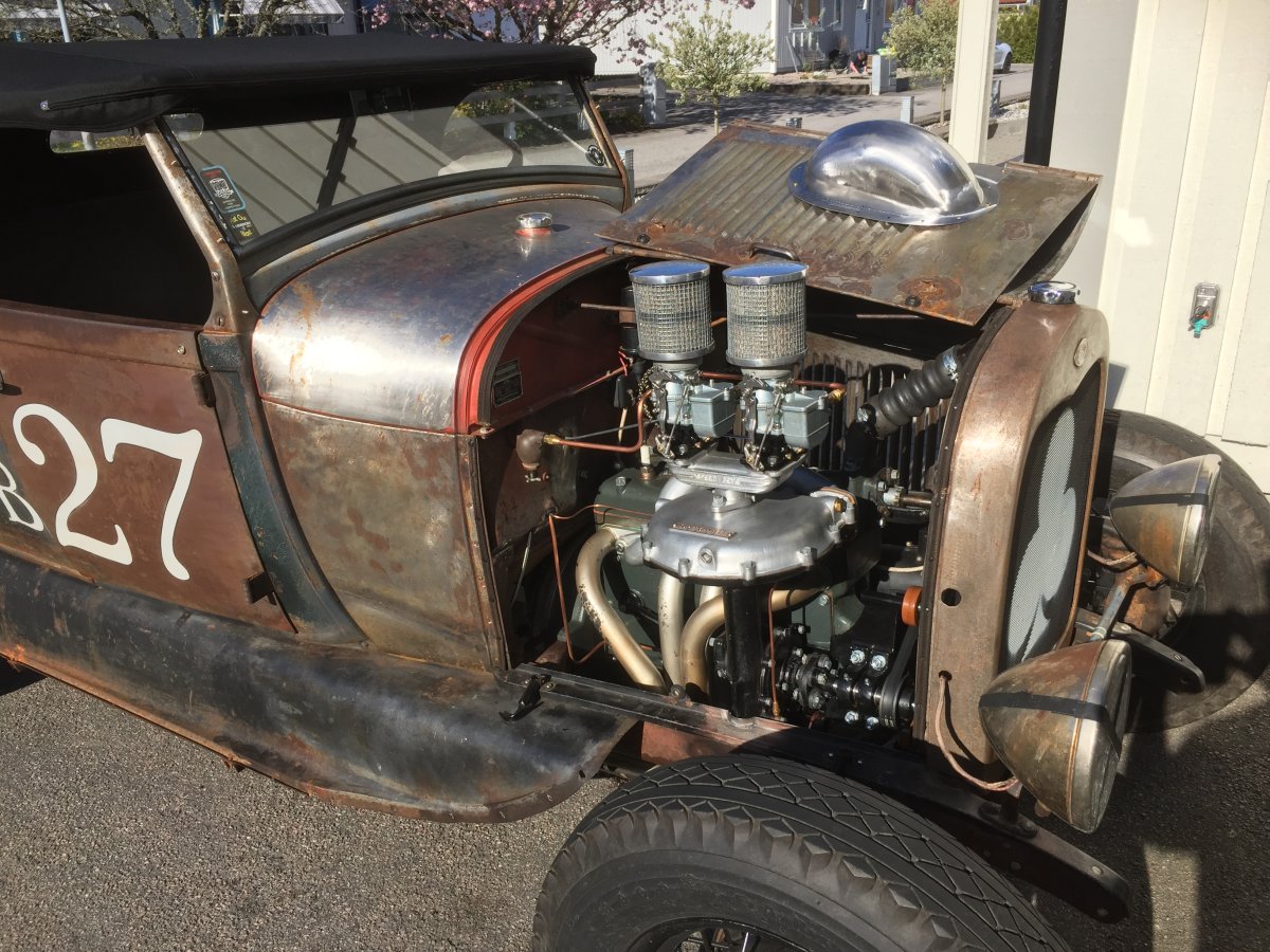

    This banger is not mine but might be as it’s for sale currently. Graham supercharged banger.
