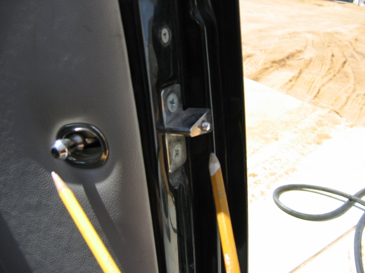

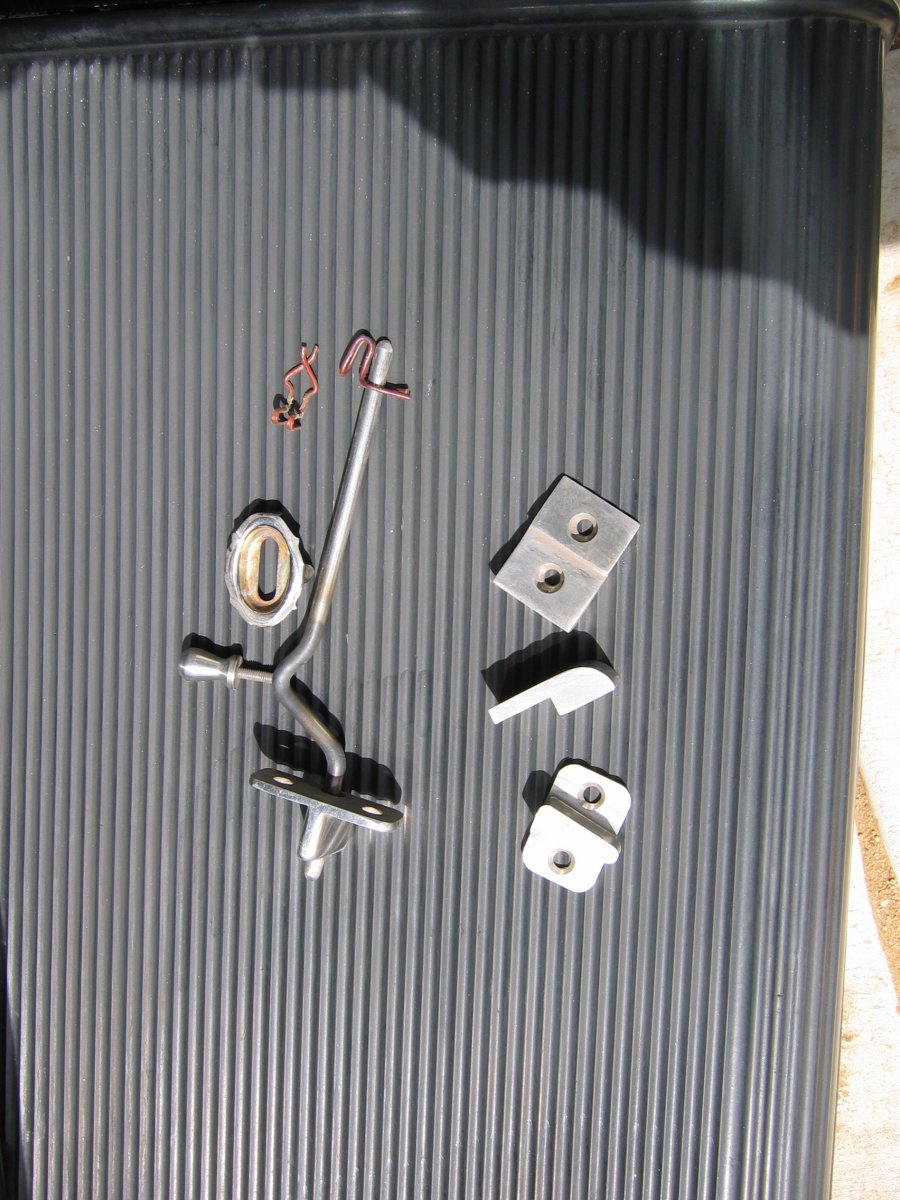

    Here is mine on my 33 Fordor Vicky. they won't solve your problem , but are easier to reach, in My own car they are manual butI have built them electrically operated in a customers 34
    48-760, lil32b, loudbang and 3 others like this.
