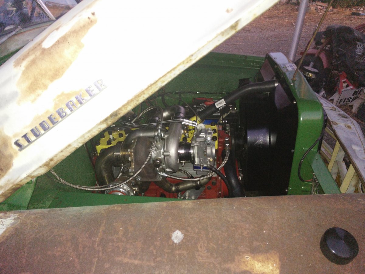

    Well I haven't posted here in some time so I thought I would post some pictures of this goofy truck I saved from abandonment. Its already an orphan being a Studebaker and it was last touched in 1977 when the previous owners were not able to finish a motor rebuild. Fast forward It was a Gifted to me 2 years ago and it was totally complete and stock down to the 4 hubcaps. so I got it running and took it for a spin and WOW was this thing underpowered I guess that is to be expected with a 75HP flathead 169ci six. I decided I would try my hand at a Hop up on the old six. No amount of available speed equip. could do much for a 169 flathead six so I decided to go all in.
    I have been driving it for about 200 miles now and its now a fun and kinda scary truck it drives if you can imagine like a 2 stroke tractor. Its all or nothing I only have the wastgate set at 9psi at least until I get the water methanol inj. system put on im going to work on that next week. Oh and BTW everything is made from 304L Stainless steel.
    here are some pictures

    Uhhhh...... OK! I was preparing for another ho hum LSx swap. Nope! Very nice fab work. Are you using the original trans and rear? Looks like EFI ? Give more details man!
    volvobrynk likes this.
  4. Well good clean install. I see the micuni smoothbore, but what's the turbo? A custom built unit for the engine or???

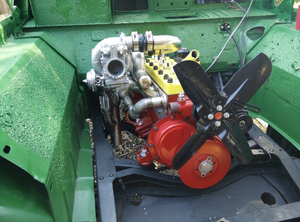

    Good eye its a Mikuni 48mm flatslide with a bowl spacer for volume. and I bought the turbo off a riceburner that was upgrading . The turbo is a custom T3/T4 Garrett that I modified with a carbon seal and also rebuilt and its water cooled.
    No efi here hell im even running points and the rest of the drivetrain is stock but rebuilt its a 3spd w/OD and a Dana 41 w/4:89s

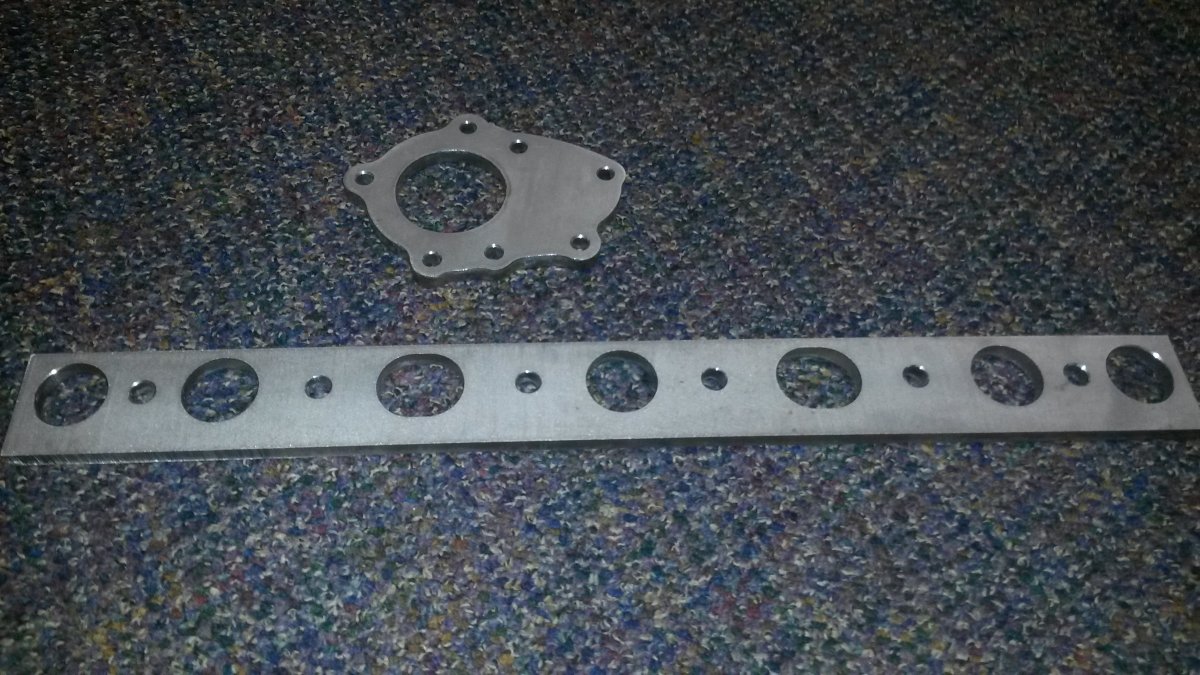

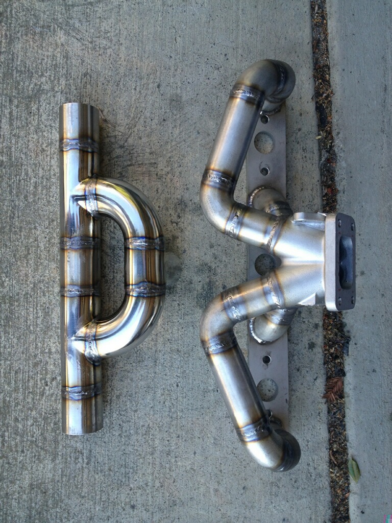

    Here is how the header started life .108" wall SS
    Mikuni Vision... Bird Strike anyone?

    I love this project - always liked the old stude trucks. Underhood did you paint green over undercoating? Do not see EFI, sucking Micuni's gas through turbo will eat away turbo blades over time. Same with water injection into turbo. Love more detail on brakes and drive train. Wonder what power it makes with turbo. What 0-60 time? Stick with the patina paint job - love it all.....

    Eventually the truck will be Oliver tractor green so I painted the engine compartment when I had the chance and over the factory under coating that shit is really on there so I figured fuck it.. Compressor wheels are cheap and it will take a long long time to hurt one. The H2o/Meth will be shot into the manifold. Im guessing 200hp tops when I get up to 17psi. Oh and the brakes they are totally new 11" x 2" stock Studebaker truck with chevy truck finned drums on all 4 corners.

    Excellent job on the fab work. Stude mills do respond well to turbos. Like the job you did. Any more detail pics of the I/E manifold. & what else got done to the mill? Additional specs, etc. Good parts are available, some speed equipment(new), but turbos give the best bang for the buck.

    I shot a lot of photos when I was fab'n the in/ex man. my phone got destroyed along with all the pic's ....Lame.

    Some details on the engine :
    • .060" overbore,
    • cast pistons no Carbon grove,
    • Castiron rings, .015" gap,
    • SS Ex. Valves Nos Intakes,
    • Intake guides cut for Teflon seals,
    • stock cam and springs
    • stock forged rods and forged steel crank .030 .030
    • Aluminum cam gear
    • Modified oil pump exits out the top and into remote filter
    • Closed crankcase ventilation W/ exhaust venturi and valve
    • ARP head studs torqued @ 60#
