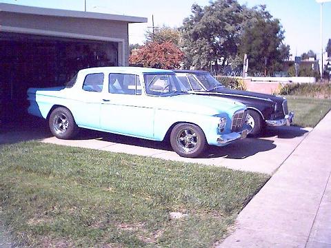

    Now my Studebaker has a nonstandard 383 inch SBC 4 bolt main block, with World Products 2.02 heads Comp cams 272H, roller rockers, Eledbrock Intake, Mallory Uni-Lite, Billet flywheel blow shield, 4 speed, 9 inch 31 spline, Power disk front and lots of other stuff like all new upholstery. And all you need to do is give me money and drive a original Calif. Black Plate car home. Must go. Make offer, but keep it within reason.
