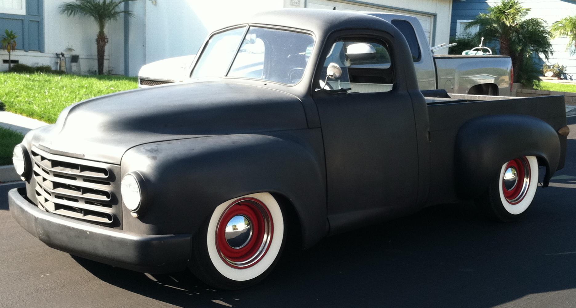

    Hello all. It is with mixed emotions that I find reason to join and post after years of lurking.
    My step-dad passed away a couple weeks ago and left me a small project, and by small, I mean Hoover Dam-esque.
    Here is my new pride and joy:
    Having finally found the title, I now know it's a '51.

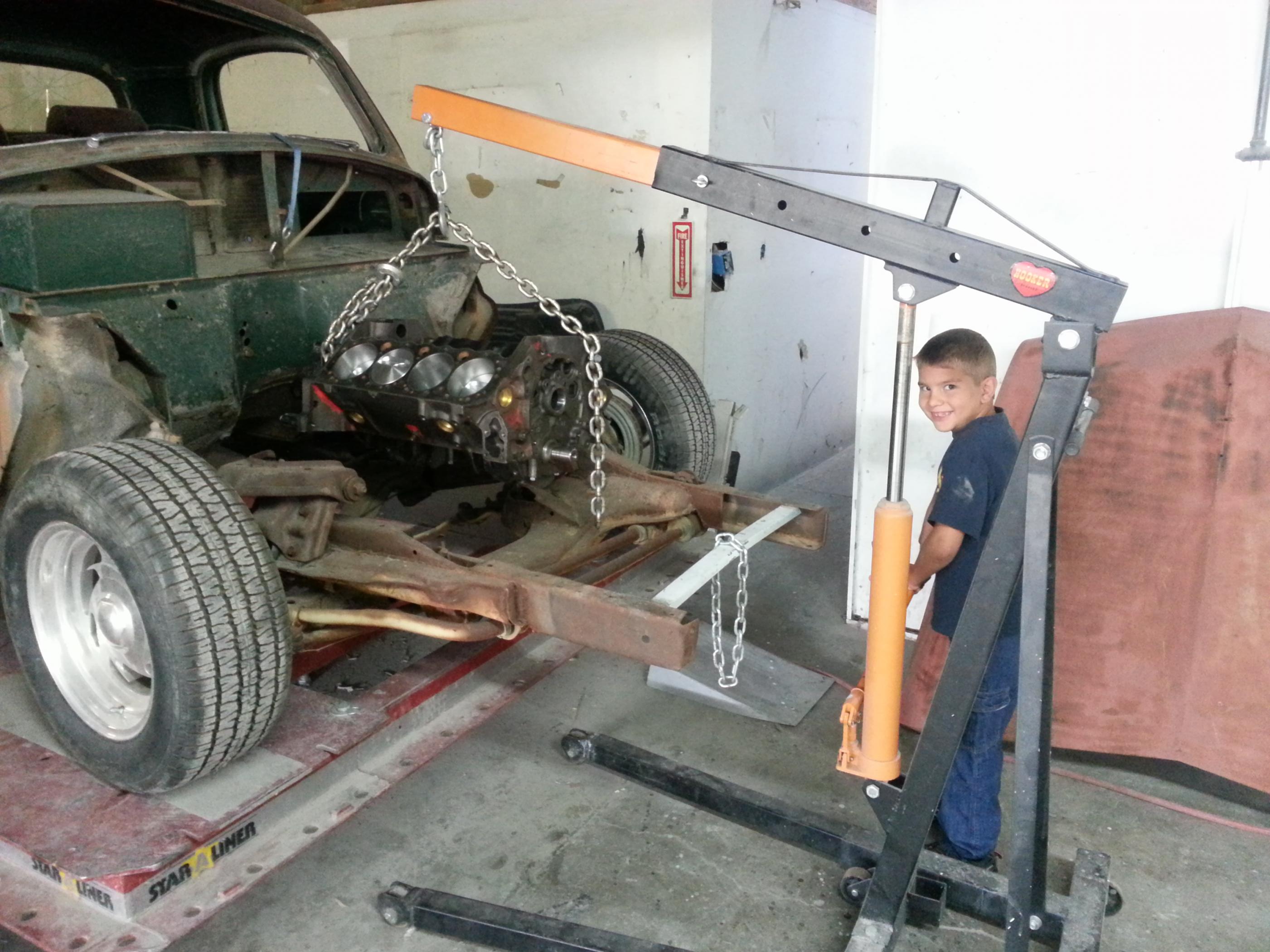

    I have made a little progress. I started work on engine placement using a plastic block and today I picked up the actual 327 that is going in.

    Joined: Jul 30, 2012
    Posts: 98
    DHeep
    Yes, that's my 8yo son. I'm trying to ensure that he gets an early start to his love for things that burn fuel. :)
