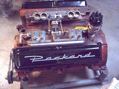

    Here are some pictures of a Packard that I put Pontiac Hilborn injection on and a Lincoln with SBC injectors. I would think a used SBC manifold would be cheapest to start from. Cut it apart like I did the Lincoln unit. See what is the best way to bolt it down. Adapters or redrilling the intake. Next you need to make a pump mount and drive. It's just fooling around with stuff until you make it fit. Injection 001.JPG Linc Inj1 002.JPG img66.JPG
