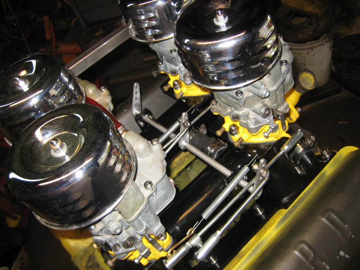

    I have emailed Stromberg for info. This was all set up (I think) at one point by someone who used to work here and is long gone. The carburetors were in a plastic bin, the linkage in pieces, mixed in with some other similar linkage was all in a box. . No pictures, diagrams of how it all went together.
    I found pics two setups to kind of guide me. One of the same manifold but, you cannot really see the back of the intake to see what is going on with the cross shaft.
    Deuces and dana barlow like this.
  4. I found that the extended throttle shafts from the passenger side carbs flex and looked like they could bind so I built an aluminum flat bar that attaches to the two driver side throttle shaft bushings. It is a tight fit to provide a stable support for the extended shafts that pass thru it. Then I used throttle arms and small heim joints with a SS shaft that I got from Tractor supply which is connected to a larger adjustable arm on the rear carb to get the pull I needed. Looked for the pic but can't find it and the whole project is in storage as we are building a new house/garage currently so I may not be much help. That engine is in my avatar if you can blow it up for reference.

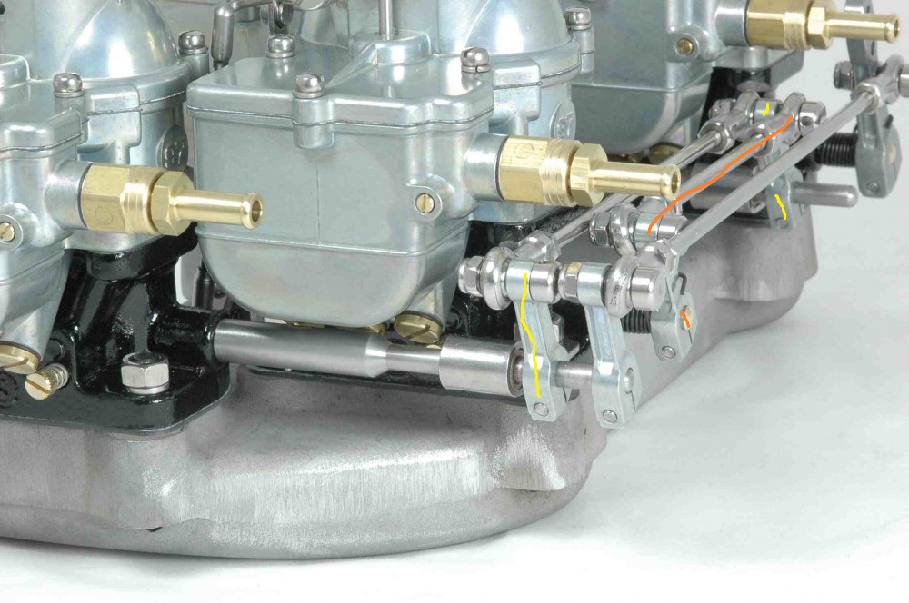

    Update. I got in touch with Stromberg and they (Clive) recommended just running one rod straight through all 4 link arms. He said a back bar was not necessary because with the extended throttle shafts it was possible to line up all the link arms with one piece of rod. I sent him the photo of the Olds that I posed above and he basically said all that was not necessary. Waiting on a couple of parts, I will post up of photo of what I end up with.

  10. Bigchuck

    The ones that I have seen that work well all had some kind of support for the two extended throttle shafts.

    The extended shafts on this are supported by a hinge that attaches to the carburetor bases behind the extended shafts.
