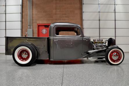

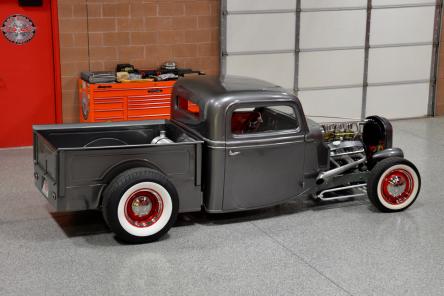

    It's been done. While this truck is a little OT, it shows what can be done. The owner is from Ohio but I can't remember his name. If I recall correctly, he had an extra pair of doors and used them to complete this. Obviously, he had to straighten one corner, probably using pie cuts. Also,I think he used a slice out of each door to extend the doors and create the extended cab. Maybe he or one of his buds will chime in and give more info.
    Like you, I am tall and one of these trucks would never work for me. That is why I took the pictures.

    Being 6'3" and about 250, I can see the value in stretching one out, but I dont care too much for the blue truck. It doesn't look correct for the period of vehicle to my eyes. It reminds me of a early 90s Ford Ranger extended cab. :eek:
    Mr.48's photo is more appealing to my eyes. ;)

    I believe the blue truck is actually a fiberglass body, and if so, is on a Ranger frame. I definitely do not want that rear opera window!

    That is an all steel body. Not fiberglass. I don't know what kind of chassis it is but you can build whatever you want. I just posted the pictures to give you a source of ideas and to show it can be done.

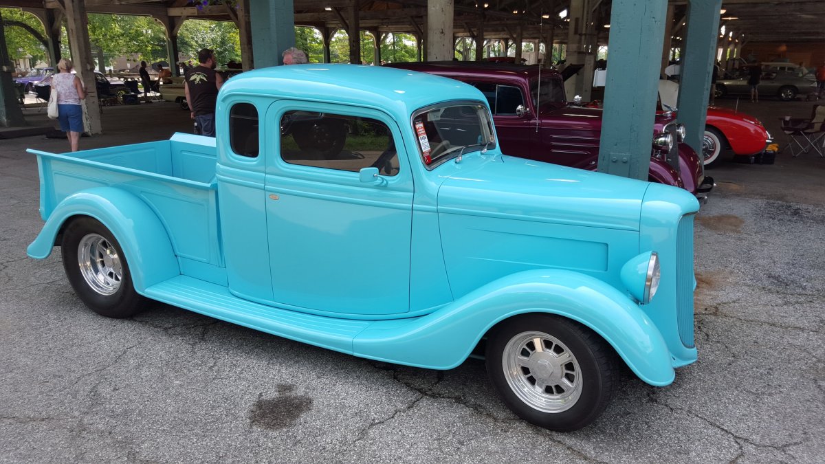

  8. I friend of mine owns s shop and a customer showed up with one of those fiberglass extended cab 35s on a ranger frame. They sold it and he built him a steel one. I’m not much of a fan of an extended cab style but I have seen them stretched. Adding 2 inches to the door and maybe an inch 1/2 or so to the cowl and rear part of the cab would help proportions
    The roof taper will probably requite a custom roof skin

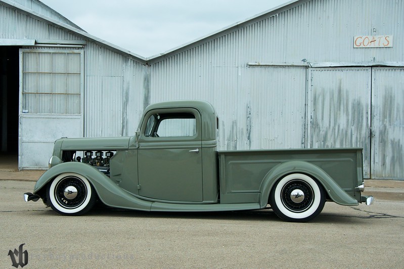

  9. The door was stretched on this one.
    And the cowl just a little
    Bring the back of the cab up some and lose the window and you would have what you are talking about

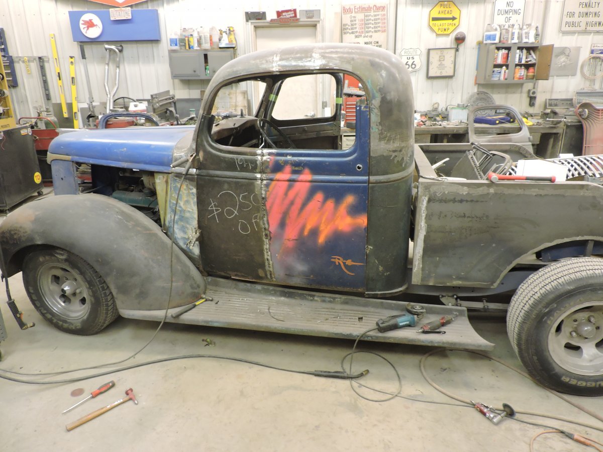

    This the 39 chevy truck I am doing. I stretched the cab 6 inches and chopped it 2 inches. It is a lot of work, I did some pie cuts and used another roof to get it lined up. Still have a ways to go but just sitting in it now compared to my stock cab 40 is like day and night difference.

    That blue truck is Russ Speilman's from Dayton, Ohio and it is steel.Great rod builder..
