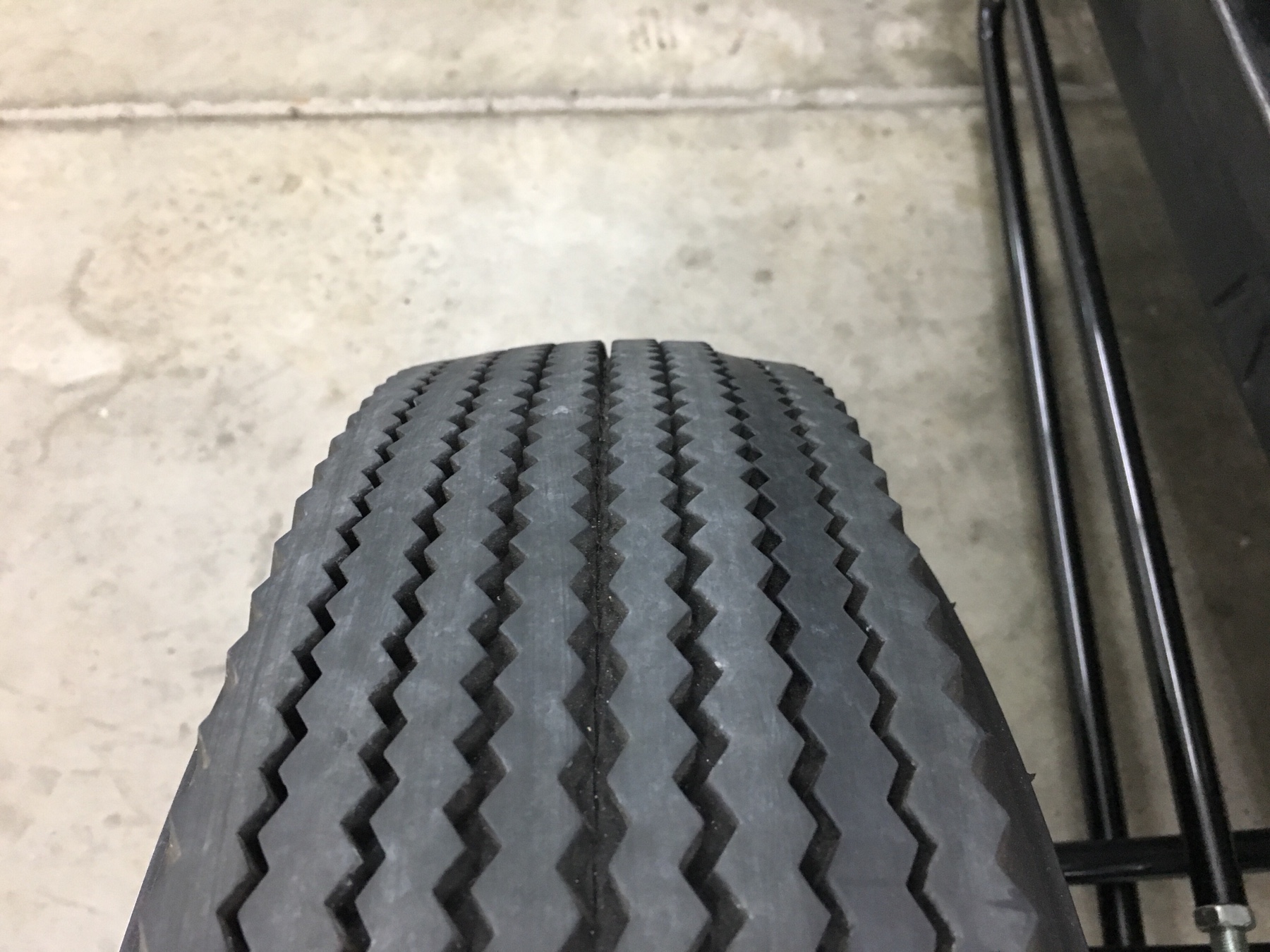

    I’m the type that hates to ask for assistance in solving a problem, but I guess that’s what it’s come to !
    SuperBell ‘32 style axle, hairpins, .125”toe-in, 6.5 deg caster, 0-0.5 deg camber (as it came,best I can measure), 32 psi, 6.00-16 bias ply, 1.5” rake front to rear. Car literally drives perfect, 85 mph on the interstate hands free, no pull, vibrations, etc. If the road is smooth, you would think you’re driving a 2018 car.
    The tires have 14,000 miles on them, and I started to see the pattern after just a few thousand miles, and been scratching my head ever since. Since the car drives perfect, I could just wear them out and forget about it, but all things have a reason, ................ I gotta know !
    Any suggestions would be appreciated !

  2. Is the wear on both tires?
    Sent from my SM-G960U using The H.A.M.B. mobile app

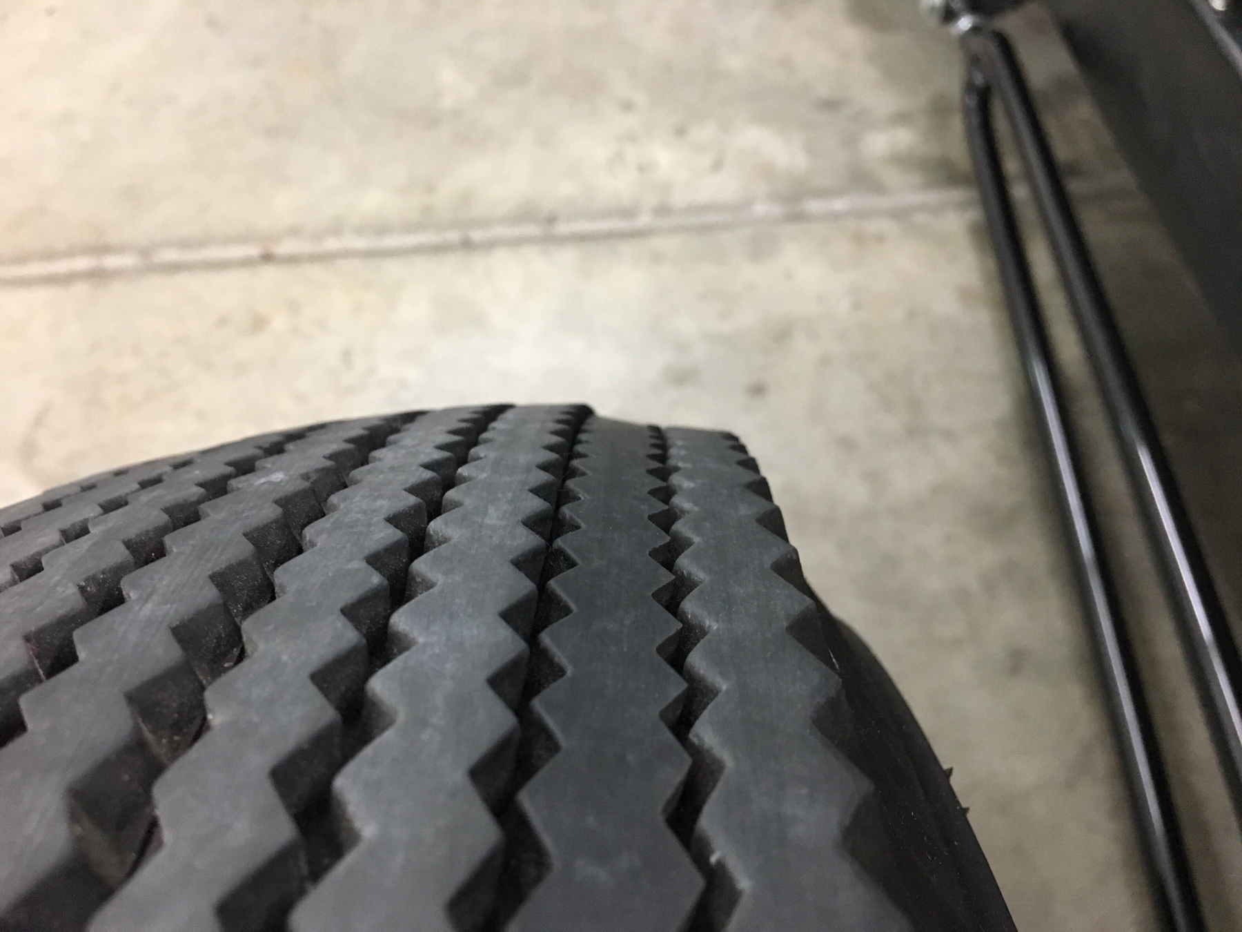

    Can see the toe out in the #3 picture.

    I’ve checked it with my homemade gauge several times, and had it on alignment machines twice (last week latest), toe-in dead on .125”. I’ve never changed it because .125” is the standard on bias ply, but I could easily try .0625.
  8. The wear pattern looks like excessive toe. Also, check your camber to make sure that you do not have negative camber. Negative camber will wear inside of tire, but the wear pattern you have looks more like excessive toe.
    Hnstray and zzford like this.
  9. I agree with pic 3. Looks a little out. Specs...shmecs....... lol. try bringing in a bit. Rotate the tires and see what new wear you discover after some miles

    Right now the camber is 1/2 deg negative, would that be enough to cause that wear in 14,000 miles ? Maybe ?

  16. It's caused by Tire Scrub. Take a strait edge and put it vertical against the King Pin and make a strait line to the ground following the pin. Your contact point is inboard of the inside of your Tire. Every time you turn the steering wheel you drag (scrub) the tire. Another issue that adds to that is incorrect Accerman. When all of these things are dead on you can turn the steering wheel to the lock either direction on a smooth floor and push the car with one hand and it will make a circle. If you can't do that, you have an issue. Camber, Caster and Toe arn't all there is to alignment.

    Look up tire "river wear" pattern. Some rib tread designs wear that way. Lot of rubber out on the tire edge since the inner profile of the tire transitions from the tread to the sidewall. On some heavy truck tires they cut a decoupling groove on the outer edge to help combat that type of wear. If your specs are correct as you say, you may have to live with it on that style tread.

  27. If you actually set the Accerman correctly I doubt you would forget that you did it. If your not sure, it would be a very good thing to do just to be sure. Also to be the best it can be the King Pin ground contact point should be dead center of the Tire contact point. Most guys and even Shops don't know and don't care about it. That helps with Tire sales.

    I've seen wear on the second rib on bias tires quite a bit, but it is even on both sides of the tire, not only one side.
    Alignment specs are great for the specific cars they were meant for...but sometimes you have to adjust things to work with the car you have. Might be it needs more toe in, might be it needs more camber. Remember that things are not the same with the car in motion, as with it sitting still. There is load on parts, and stuff deflects.
