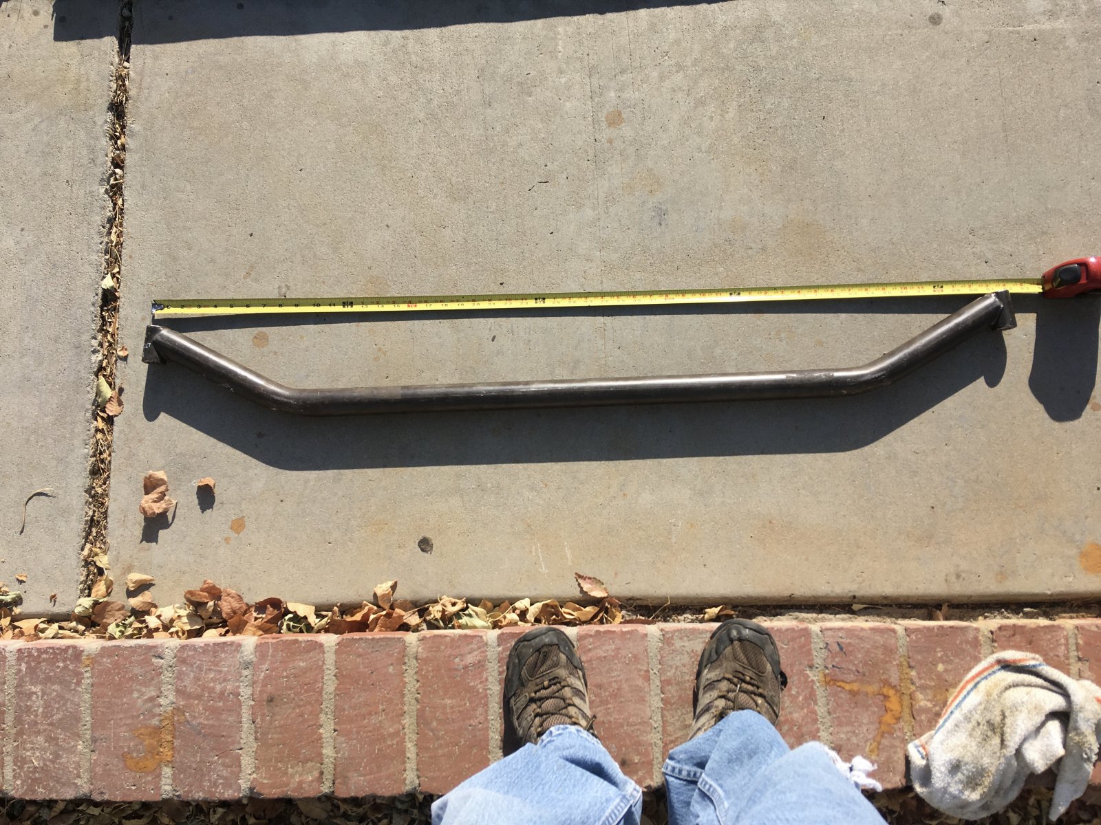

    I have what I believe to be an old Total Performance dropped axle. Im going to use this on a parallel leaf spring project. The kingpin bosses have a .741 hole which matches a 61-63 Econoline king pin. also the height of the boss matches. the boss is set at about 8* of negative camber.
    I would like to have the bosses machined out for the 49-54 chevy car spindles and king pins.
    My question is , will there be a camber difference between the econoline spindle and the chevy spindle.
    Another question is the chevy king pin is .867, should I have the boss reamed to that exact size or give it some clearance .001?
    Any knowledgeable help will be appreciated.
    Don't need "why don't you just "opinions
    As alway thank you HAMB, Ive been hangin around here since ought4
