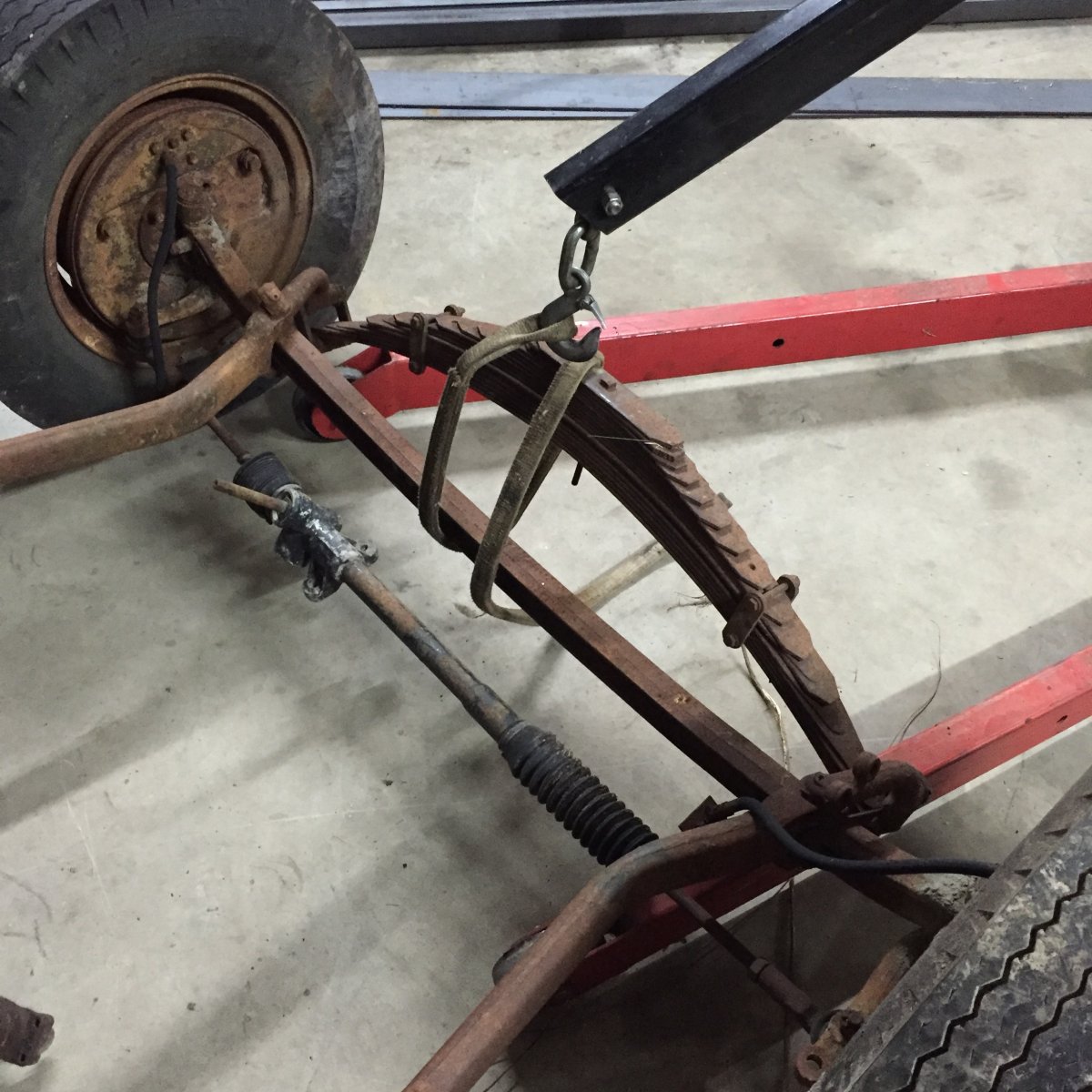

    Sweet rack and pinion on an axle i got off craigslist
