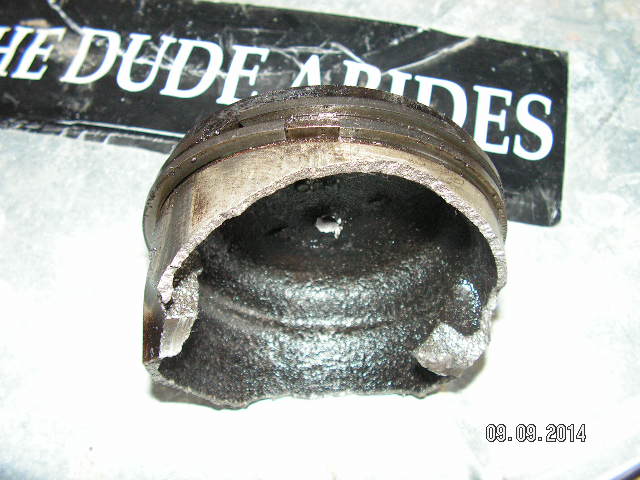

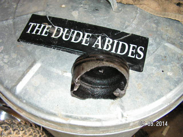

    Thanks for the suggestion. Here's what I found....

  3. What do the cylinder walls look like? Are they scored badly?
  4. ,"the rest of the story" should be interesting

  7. Good idea. I'd do this before wasting time pulling the pan. Then in just a few minutes you'll have a better idea if an in car repair is doable
  8. It's looking more and more like you may have dodged a bullet. Might get away with new piston and a cylinder hone, though I would snatch the engine out and freshen the whole thing up if it were mine

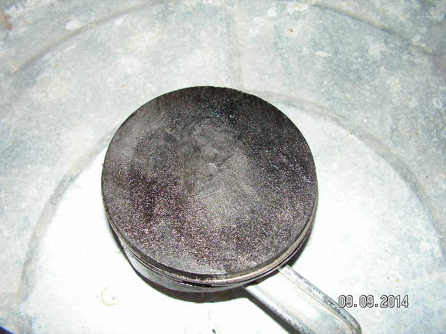

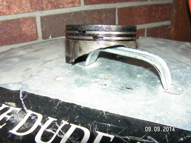

    if you can show us what the rest of it looks like and if the rest of the piston is still on the rod rotate it by hand to the bottom and we can see how bad the wall damage is . IMO so far your damn lucky that broke where it did .
  11. Yes, it's looking like an in car fix may be doable. Take some pics in the hole. Motor's are very forgiving. Even if the wall's pretty ugly you can probly fix it with honing. I've put some real ugly shit together in my broke days with great results

    I'll try to take some better ones tomorrow when I have better light.... PICT0002.JPG PICT0003.JPG PICT0004.JPG

    Amazing! That can be fixed.
    A simple overhaul with new pistons could do it, or a total rebuild. That's up to you. It looks like she survived intact not many designs would have.

    Looks like that cylinder has been in trouble for some time. Note the oil fouled carbon buildup on the top of the block/valves and piston crown, compared to the adjacent cylinder.
    From the photos of the wall, it does appear to have little damage. Of course, the pics may be deceiving.
    It is possible to get more or less satisfactory performance from a less than perfect cylinder when saving costs trumps perfection. Depends on how much you want to drive it annually. If you were going to make this cylinder 'perfect', may as well do the other seven as well.

    I would say U dodged a bullet for the most part. Now lets see if you can get a piston and rings.

    Well I'm amazed. To have that wrist pin going up and down without making a big hole in the cylinder wall is stunning. You couldn't have run it that much after it gave away.
  17. JEEBUS!!! :confused: You didn't say nothin' about running it with a blower on nitro! :rolleyes:
    Wait a minute... Those engines didn't use an oil control ring??? Learn something new every day if you're not careful. :oops:

    The oil ring may well be in the lower part of the piston skirt. Some older engines were done that way.
    Although, with the oil fouling evident in the cylinder, maybe it was assembled at some point with a compression ring in place of an oil ring.

    You are one lucky SOB, but if it were mine I'd be yanking the powerplant and doing a complete disassembly.
    There are parts of the piston floating around in the pan and checking the other pistons for cracks would do a lot for a persons sanity.
    Who's ta say that there aren't a couple more pistons ready to do the same thing right after you get it all put together.
