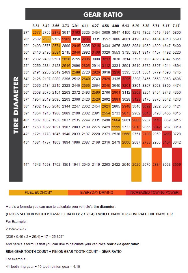

    The only way you could be limited to 65 m.p.h. if your transmission is, indeed, shifting into top gear is if the car was originally an overdrive equipped version with a 4.++ ring & pinion. Even then I think you're letting your ears over ride your brain. You need to know how many R.P.M. your engine is turning at 65. I just did a quickie calculation which says a 4.10 gear coupled with a 28" tire @65 is only 3200 R.P.M. Even a 26" tire would give you but 3450 R.P.M. That sure ain't at the engine's limit.

    Even with 4.56 gears it should do 65 in Second. It can't be finding Drive.

    Even a stock beat up worn out 302 should turn 4100 to 4400 RPM's. That should run it faster than is legal in any state.
