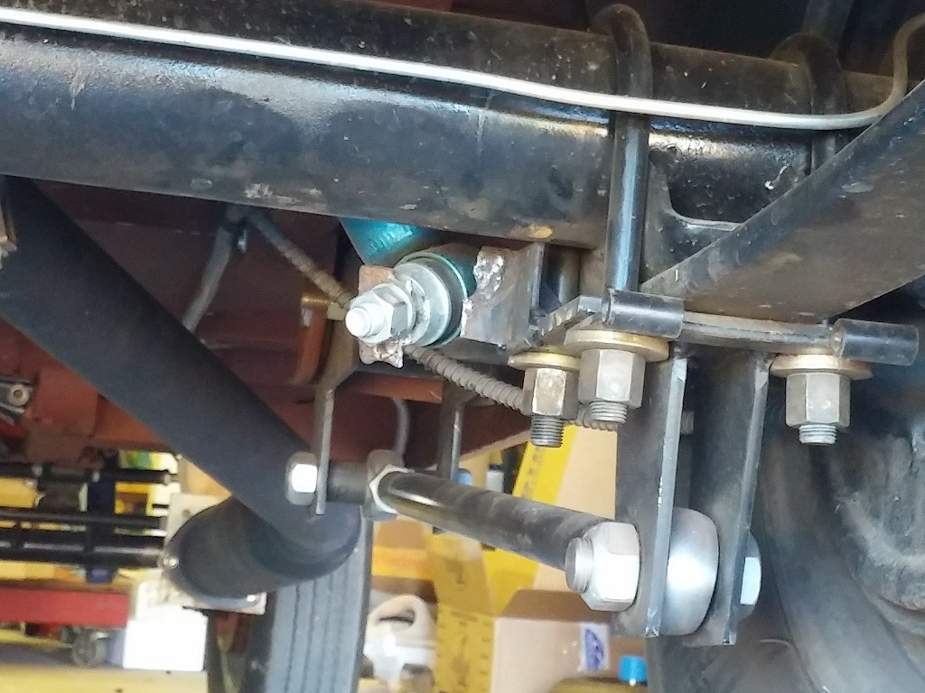

    I made a pair of "cal tracs" that look like "traction masters", and they work great. Car runs low tens. There are a few more pics in my build thread, I'll have to see if I can find them... I'm using stock springs, they were monoleafs on the early Chevy II.

  13. squirrel
    Joined: Sep 23, 2004
    Posts: 55,935
    squirrel
    the mounting of the rear end of the bar might explain that...it's not a ladder bar, it's a traction bar that pivots at the rear mounting point. Sorry for not including this picture earlier. (yes the shock mount was broken, it's fixed now)

    OK. So what's the geometry related to it?
    How much lower does the traction bar pivot need to be in relation to the leaf spring eyelet?
    And what distance does the rear pivot need to be from the axle centerline?
  15. squirrel
    Posts: 55,935
    squirrel
    Yes....
    Based on the Cal Tracs, there is some variation, and they generally have a couple different holes to try, so you can adjust as needed to make it work with your particular car. I just guessed, and it worked fine with the initial setup.
    I think I used 4" from the front spring eye down to the front rod end, and also 4" from the spring eye to the bolt that goes over the spring. And about 4" down from the spring plate to the rear rod end.
  16. joel
    Joined: Oct 10, 2009
    Posts: 2,467
    joel
    The lower bar is very close to the same length as the distance from the front spring eye to the centerbolt.
    I say close because you adjust the length of the round bar to control / limit the spring wrap up.
    Nice pic Jim, I've been planning on building something similar for my 40.

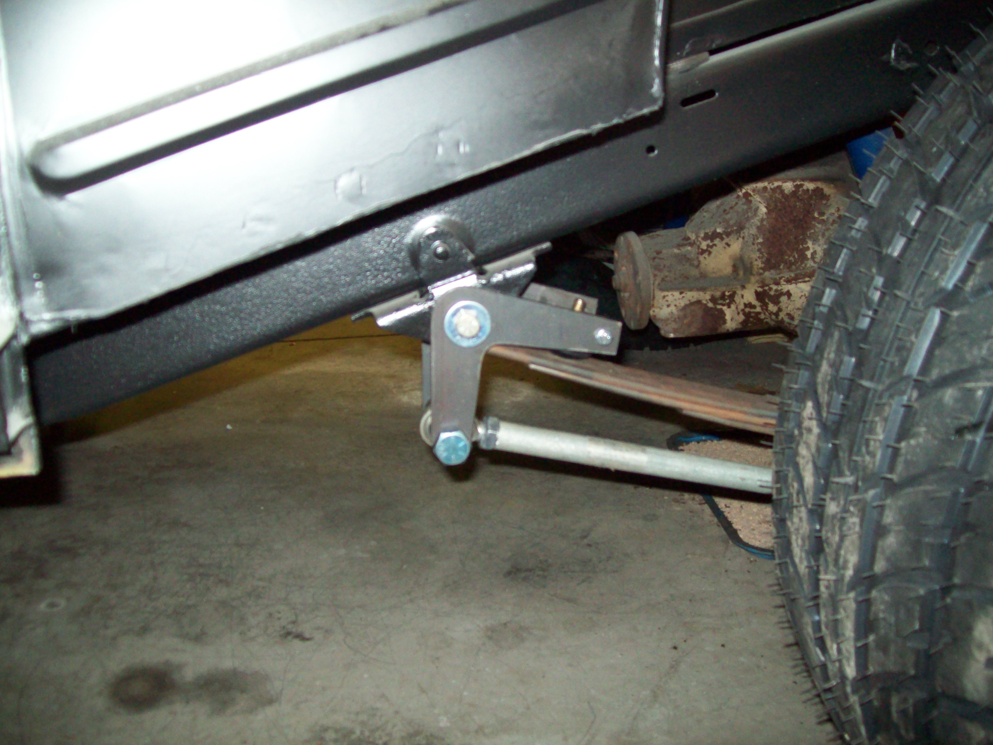

  23. blue 49
    Joined: Dec 24, 2006
    Posts: 1,820
    blue 49
    from Iowa
    It doesn't show very well, but here is my variation of Cal-Tracs. I have a short urethane snubber to contact the spring. I hadn't drilled all the bolt holes for the snubber mount yet when this picture was taken.

  24. deto

    deto
    So the snubber contacts the top of the leaf spring just aft of the leaf spring eyelet?

  26. blue 49
    Posts: 1,820
    blue 49
    from Iowa
    Yes, right above the end of the 2nd leaf.
