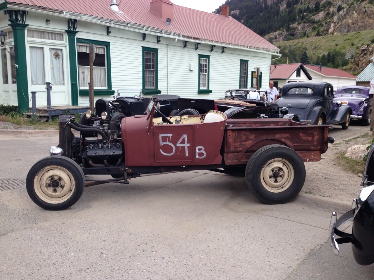

    image.jpeg My RPU is 2" forward on A frame, split A bones. Out handles a lot of my friends cars!
    louisb and sko_ford like this.

    Keeping it simple is usually best. My frame came to me that so I just went with it. Rpu shur handles good though...
    Keep at it! Johnny
