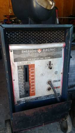

    On my way to pickup a used stick welder. It's been years (decades really) since I'v played with one and I'm wondering what sort of rod I should get. I'm not up on the numbering system they use to determine heat range/composition ect these days. I don't have anything specific right now, but can see thick gauge mild steel as a principal use.
    Also comments on the 'Emerson' badge welder would be welcome. So... Take me to school.

  16. Emerson Electric is a well-known brand in the industry, just not known for welders. They're the current #1 brand for sink disposals (Insinkerator), but also build a ton of electric motors for commercial/industrial use among other things as well as supplying motors to other manufacturers. They are not an 'off-brand' by any means, just one that may not be familiar to people not in in the electrical business. They're also the parent company of the Ridge Tool Company (RIDGID), you've heard of them.

    Is that an AC/DC version? It looks like AC on the left and DC on the right.

  23. You would think this welder would get more love, given how it's as 'traditional' as it gets... LOL. As said, this was the type of welder that was most commonly used 'back in the day'. This one is actually a bit better than some.
    And lost in all the opinions is the fact that the main difference in welders is ease of use and weld appearance, not necessarily weld strength. Learn how to weld good on one of these and 'moving up' in welder features will be easy...
    Plus, these old welders were pretty robust; no expensive-to-replace electronics to worry about.
