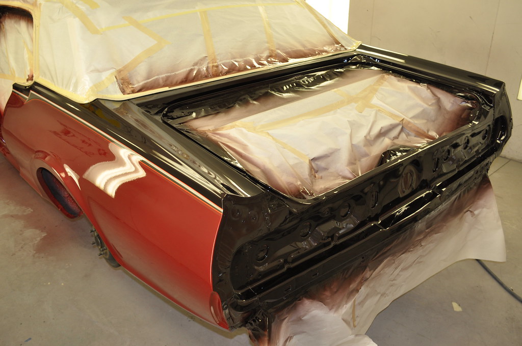

  7. When I spray a car with a complete color change or re-color I make sure the entire thing is assembled and gapped, then spray the entire outside of the car. (especially if it is a metallic) Mask the unpainted door jambs as good as you can to reduce overspray and resanding. This makes sure that all the panels are uniform in color and metallic orientation is the same throughout. Once the clear is dry, then I disassemble the fenders, doors, hood, trunk and other trim parts and add color to the jambs and underside of the trunk, hood, ect. You can color/clear the body jambs only or mask the jambs for color and reclear the whole main body again to reduce the chance for tape lines. ( I like to completely reclear) Mask the outside of the doors, hood, trunk completely and while the parts are on a stand, put tape around the border edge of the panel that can be pulled off immediatly after clear. This provides a soft clear edge at the edge of the panel. This way of painting makes sure that you have super slick jambs, uniform color and no chance of overspray. This works well if you are doing stripes/graphics on the outside because you are spraying the whole exterior of car assembled and don't have too guess where the stripes line up. You can then take the stripes into the jambs after the initial re-color/clear for a better job and everyone will be astonished as to how you did it!
    Though done on an O/T car, this shows the process:
    See More pics here: http://www.flickr.com/photos/cccstl/sets/72157623729433708/

  8. Turbos10
    Joined: Aug 8, 2011
    Posts: 55
    Turbos10
    from Texas
    As hobby painter only I just want to ask about the above process of painting exterior first and then jambs and interior. I have done a couple garage jobs with good results and always done it backwards from this and from what I had been told in the past was the easiest way and safest way to keep from chipping.
    My question is why not reverse the color order and do all the jamb work first and then mask from the inside. I reread and and I just did not quite get it. I guess in my mind it just seems like that is easier unless you are reclearing the entire panel. Is the reclear for no tape lines the main reason for this? I have just lightly sanded and buffed in the past to blend them if they were an issue.
    Just curious because I have a paint project coming up...you obviously know your poop. Thanks.
  9. The MAIN main reason for this is to make damn sure there is absolutely no overspray in the jambs. The door hinge area is by far the hardest place to mask without getting overspray. The other reason for this style of painting is to get artwork to match up if you plan on taking the artwork into the jambs.
    On single solid colors you can paint the car almost any way you want, this is just a trick to get art work and metallics to match up.
    As with anything, you HAVE to be carefull of chipping during reassembly. Make sure you have assembled and gapped all parts prior to paint so there are no suprises during reassembly.
