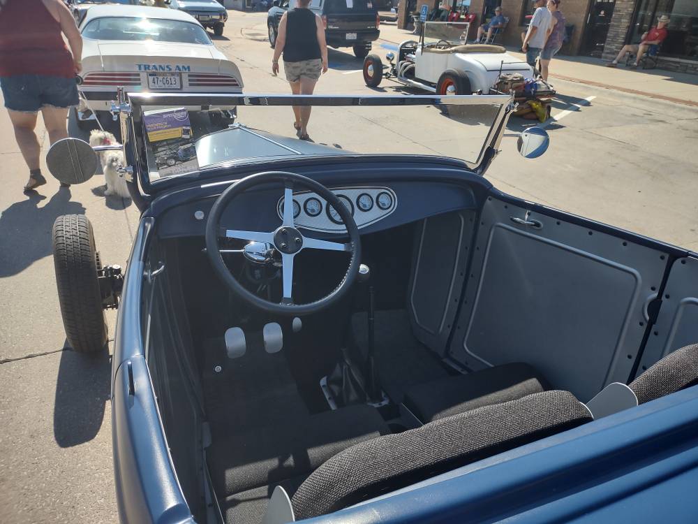

    I really like the look and feel of me steering wheel. The sun's reflection is blinding off of it and I can't seem to find something that has the look I want not in shiny chrome or stainless. 1396456352.jpeg

    Take a Scotch Pad to the spokes, go in one direction, that will give them a brushed look.

    A nice paracord wrap may look nice also.

    How about refinishing it to match the gauge cluster? Just wanted to put the idea out there...

    Engine turn it....would match the dash insert and cut down sun glare.

    Rustoleum makes a non porous primer we use on glass before painting signs on it. Should work on chrome or stainless. Pull wheel and glass bead blast the spokes and then epoxy primer. Semi gloss or flat top coat should then work.

    I have the same wheel on all three of my hot rods and have covered them with flat black masking tape. It keeps the reflection off and you can remove it when you want to without any damage to the wheel.

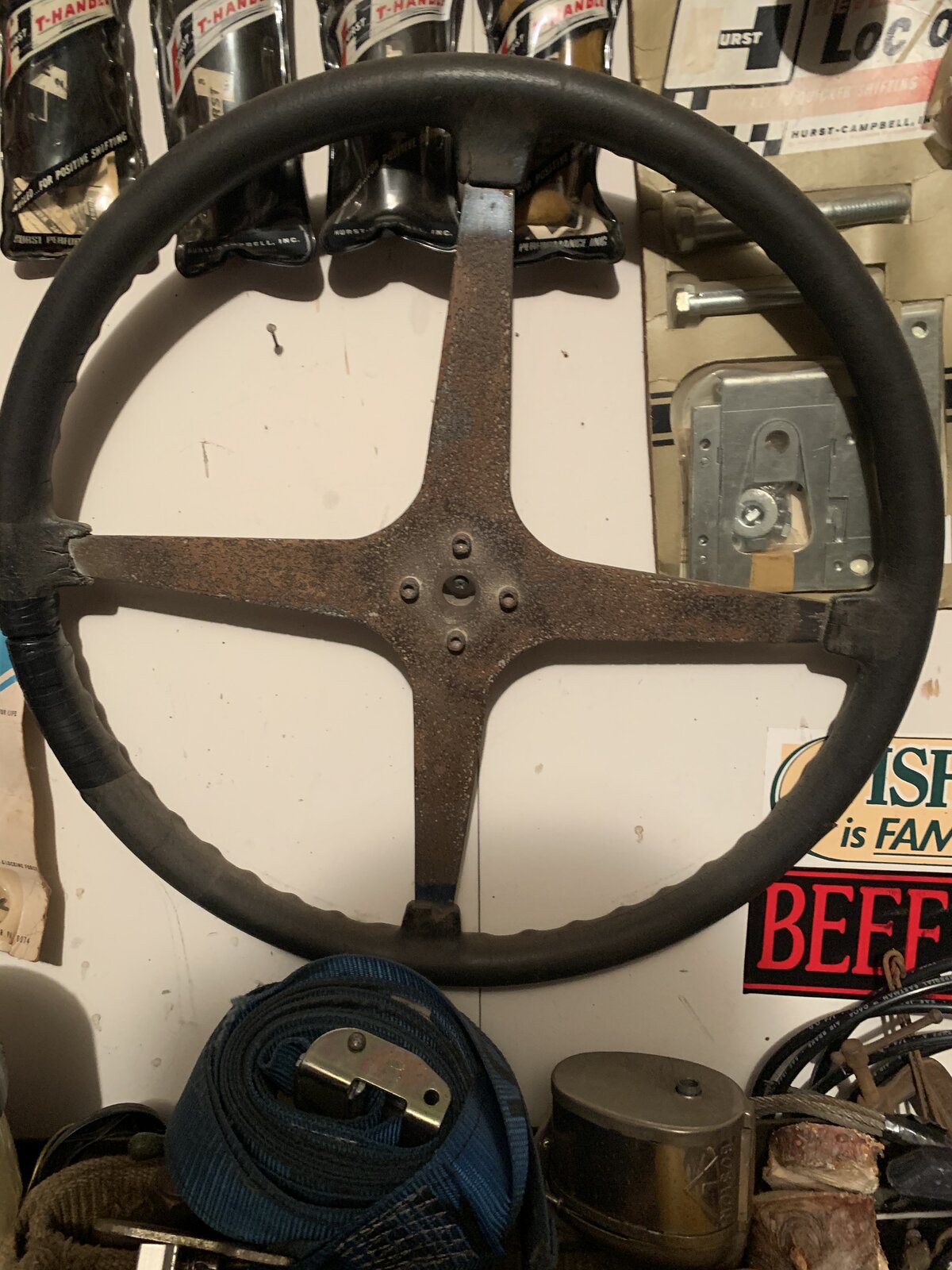

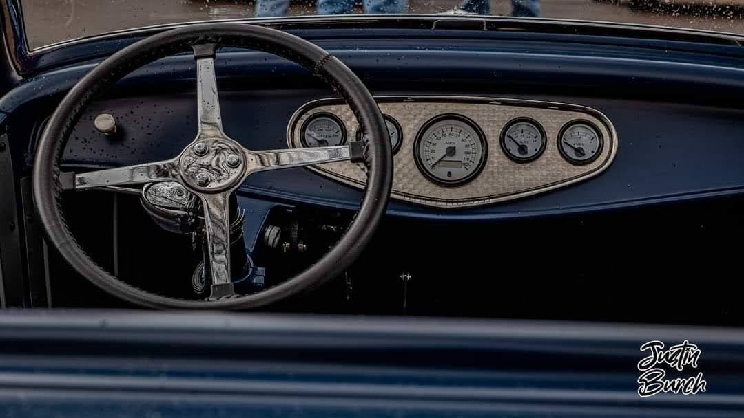

  16. ^^^^^ I vote nice horn ring.

    Thanks for all the great replies and ideas! I covered the center piece I made with a piece of leather it helped allot
