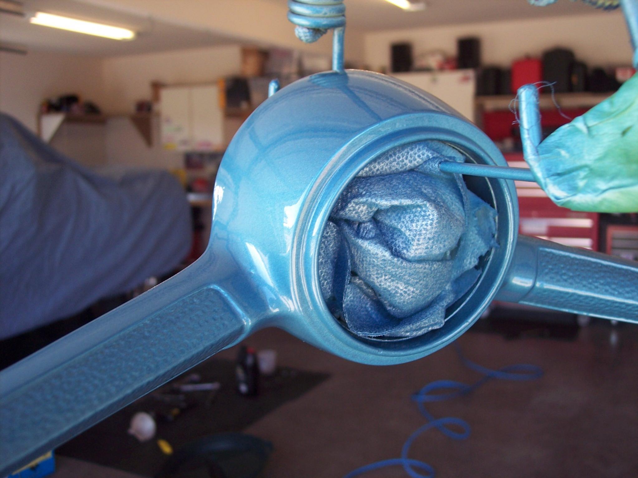

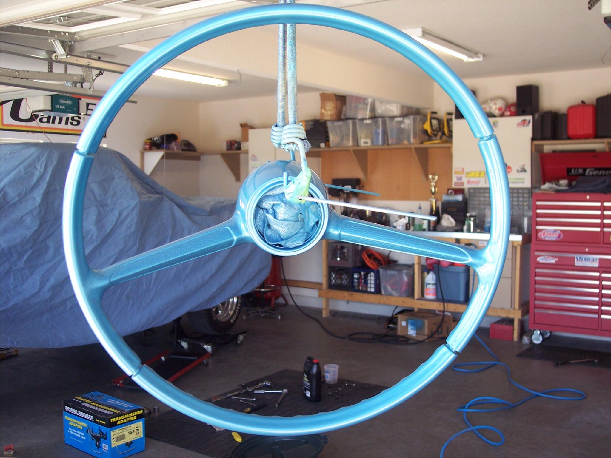

    I tried JB weld, but was thin and ran off the wheel. PC7 is thicker and sticks to the core of the wheel, and much easer to work with.
    began by applying multiple coats of PC 7 over several days, cure each coat before adding more. The best sanding tools I found were foamboard nail files
    finished wheel with airbrush woodgrain

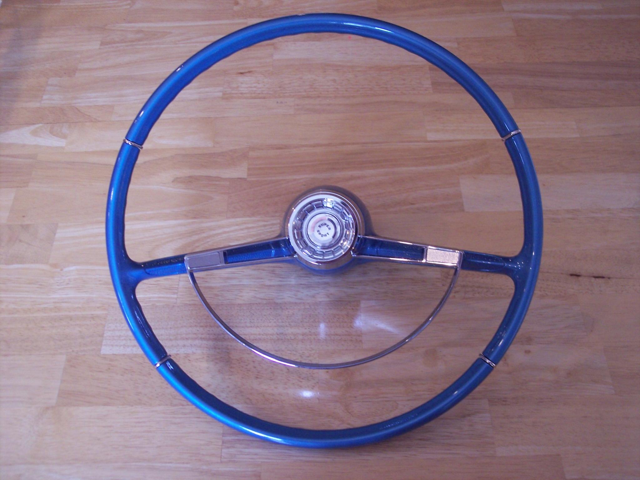

    I've done a few and PC7 is what I use, it has a workable consistency and sands at the same rate as the wheel plastic, also it adheres better. I file the cracks and overfill the first application of PC7, rough file within 24 hours, sand then one more spot application of PC7 (pinholes), then prime and paint. Haven't had any cracking or shrinkage issues, but I also file down to the metal ring.
