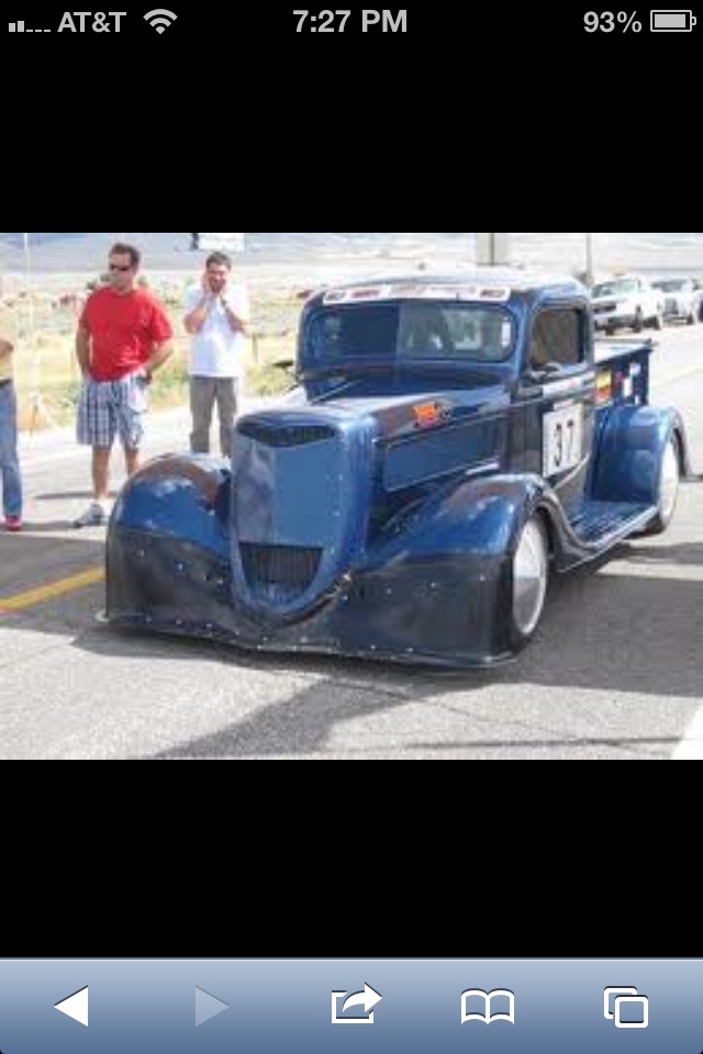

  20. Poesrodandcustom
    Joined: Dec 11, 2012
    Posts: 192
    Poesrodandcustom
    from Kentucky
    Silver state classic challenge truck. A lot of older cars runnning out there, I ran in my OT car clocked at 169.9 by Nevada Highway Patrol. Not mine but its cool and fast.
