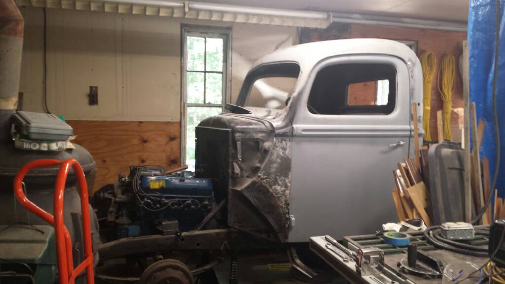

    Joined: Sep 3, 2006

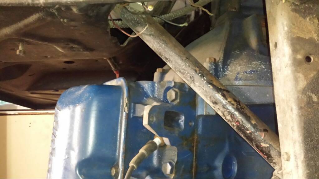

    It is my 47 truck and yes I am keeping the straight axle, here are some pictures
    That's what I called the straight bellcrank, when I can get the box should this still be in the same position it is in now or is it Ok to be at a different angle?
    That's how close the column is to the exaust port, the motor is mounted all wrong so the motor actually need to be lower and closer to the firewall.
    this shows how close the motor is to touching the head there's about a 1/4 of an inch between the head and the column.
    Sorry about one of the pictures being sideways, I guess I shouldn't be doing this on my phone.

    If you mean that straight arm on the bottom of the box, that needs to be pointing straight ahead, or very close, when truck wheels are straight.
    I'm not sure on where the motor can/can't be moved by those pics, but the column is not any closer to the exhaust port, compared to many older hot rods with small spaces. If a header pipe can fit, then it is OK, if that is where the motor needs to be
    I have an older hot rod: mine is about the same distance, and my column actually rubbed on the casting bump on the head, so I ground the bump off. If I had moved the motor away a bit, then two/three other things would have hit, so it was in the best spot I had

  12. like F@J wrote, sometime you have to just squeeze them in. gather all the pieces and trial fit, you can move the motor over a little for clearance. moving the radiator forward might help or getting a shorter fan spacer. DSCF4144.JPG

    Thanks, it is true but with how far back I have to push the engine I think the exaust port will be exactly where the colum is, I guess I should just mount the motor correctly and find out.
  14. I don't necessarily think it is a good idea to mount the engine and then figure how to deal with the steering; need to take it into consideration when locating the engine as mentioned by previous posters. Have you considered shortening the column such that you can put a u-joint right where it exits the firewall, then drop down to another joint and forward from there, looks like you could get by the exhaust and a 3/4" shaft is skinnier than the mast jacket there now.

    So I have another quick question, my truck originally had a 4 banger in it wich I'm sure is a lighter than a fe with the springs being worn out it Sita really low in the front. Makes it look like it has a muscle car stance. I have the truck up on Jackstands right now and it sits about level, actually a Slight bit higher in the front but you really have to stare at the roof to notice. That's how I want it to sit.
    Here's a pic for reference, even though you really can't tell
    How do I figure out what size spring I need and how many helpers it's going to need to hold the weight of the truck?

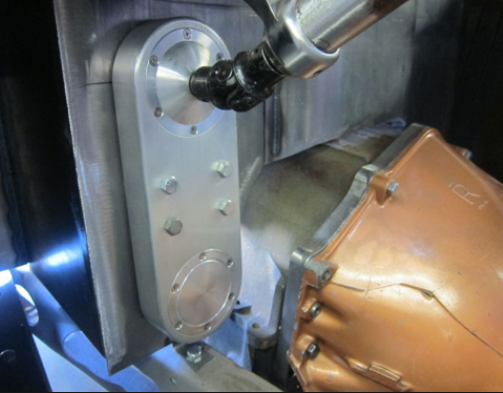

    Joined: Sep 15, 2006
    Posts: 27
    wizardfab
    I run in to this a lot, people that " think " this or that about my product. There is no law that prohibits "chain drive steering" on the streets of the United States. I have been selling Steer Clear for over 10 years now and not had any fail. In fact testing has proven that if used with a steering column that is built from round tube ( not solid bar stock ) the column would fail before the Steer Clear. Most of the top designers now regularly use them in there cars and it is used in a lot of different race vehicles.
