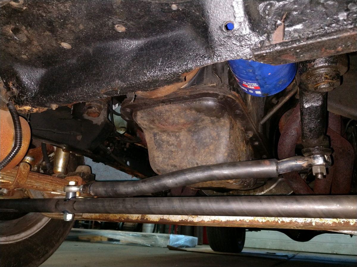

    Ongoing project to get one I bought in Sept on the street keeps "just one more thinging" me. thought I could correct steering issue on a poorly fabricated configuration. See pic's before and after. But while steers better geometry wise any bumps put's it into a Death wobble like jacked up wranglers. really needs new config, ie, Mustang 2 front surgery but don't have the green right now and would like to have some fun w it while saving my Shekels, :). so thinking about the stabilizer set up they use on wranglers? any other ideas? upload_2019-4-4_10-11-51.png upload_2019-4-4_10-12-42.png upload_2019-4-4_10-13-18.png

    What the hell is that thing in the last pic mounted from the axle to the middle of the tie rod? So much wrong in just a few pics.

    Was attempt at a stabilizer link. Criticism fine constructive criticism better.

    The drag link to tie rod connection seems inadequate to me, looks like there could be an amount of flex going on there that would allow some oscillations to occur. I'd be thinking of a more substantial connection between the two.

    Unless the length of the stabilizer is exactly the same as the length of the spindle steering arm, and is in the exact same arc as the spindle, you may have found your problem. And it probably still won't work unless it is in the exact middle of the tie rod since the spindle arms are not parallel to each other. Which then brings up Ackerman, since you have rear-facing spindles pointed forward, and haven't bent the arms out.
    Or it could be the heims, or the dropped spacers between the tie rod and spindle, or the too short drag link attached to the midpoint of the tie rod. You can't have a wiggly joint (drag link) attached to another wiggly joint (tie rod) and expect them to stay still.

  12. this needs a complete redesign. Start by taking the spindles and putting them back on the sides they belong. the Ackerman is all wrong with the steering arms pointing forward. Swap the spindles and then start looking into a way to get the tie rod from the pitman arm to the passenger spindle. I have never driven a car that had the spindle swapped like that that didn't have some level of death wobble in it.

    1st pic as bought has same issue & worse. The geometry or flex had left wheel turn more than right making left tire scrub the ground & going strait had the death wobble too. The original builder put BB Mopar in the ‘47 Ford PU frame created clearance issues & I believe is why he switched the steering 180degrees w steering & cross links in front instead of behind spindle position. As I indicated i know it’s a F’ed up design & needs new design. Not sure what the Hate Mustang 2 front end is about but still think it will be final resolve when green $ is available. Until then I’d like to get mod. this & get working for a couple seasons out of it while I wait if possible.

    The Ackerman angles turned backwards is what's causing the tires to scrub goofy. A perfect example.
    The loose joints are probably causing the death wobble. Heim joints aren't meant for tie rods on the street.
