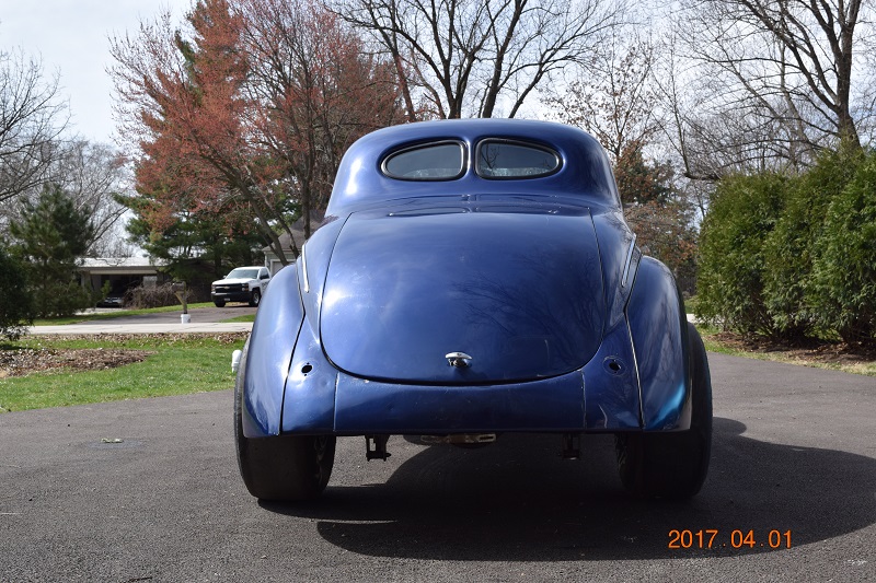

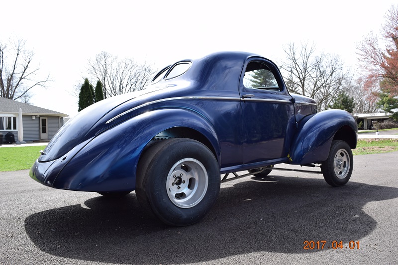

    rears are radial 30.5 tall, 10.5 wide on 15x10 ansens, yes the white lettering will be coming off. will have a second set of wheels 16x10 ansens with some pie crusts as soon as I sell off more of my stuff to keep this going. 2017-3-7..005.jpg 2017-3-7..007.jpg 2017-3-7..009.jpg

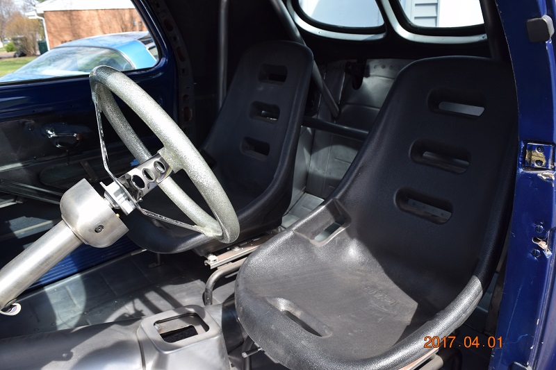

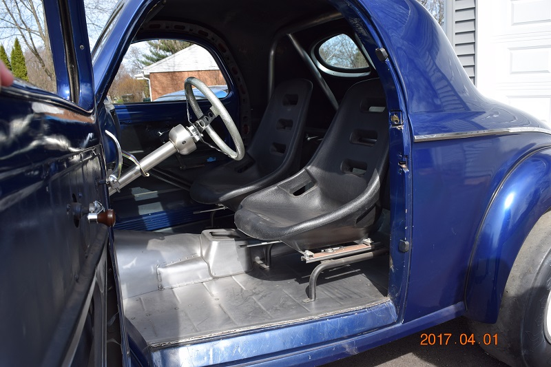

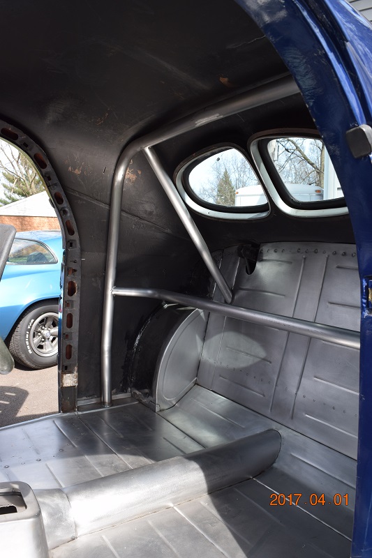

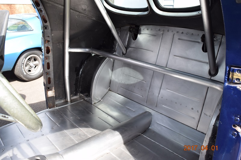

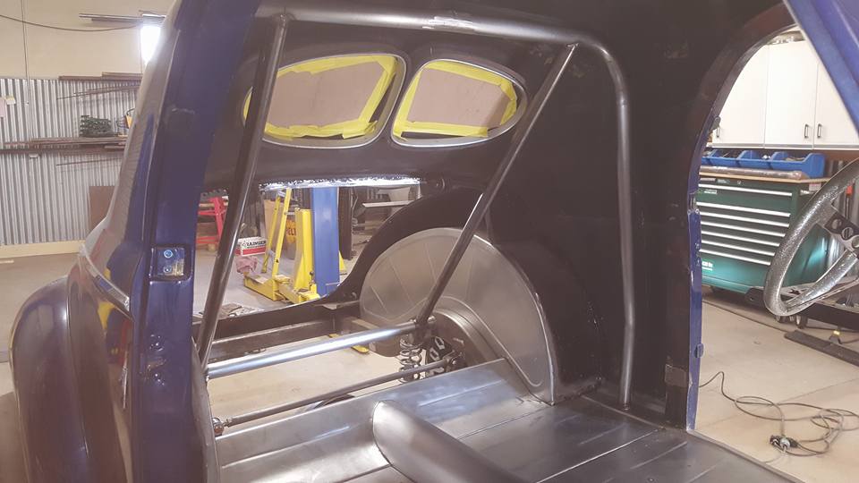

    I can't help but drool over this sheet metal work in the interior of your Willys. The transmission tunnel and the shifter housing is a work of art.

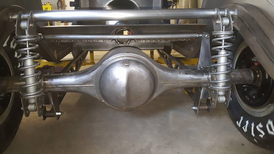

    1958-1964 olds/pont 9.3 fullsize is the years that are desirable. the one I have shortened and that is in the willys is a olds/pont 9.3

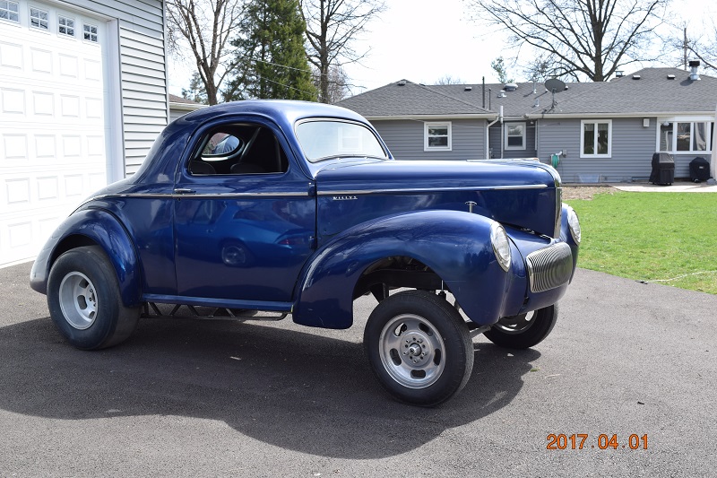

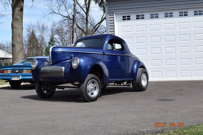

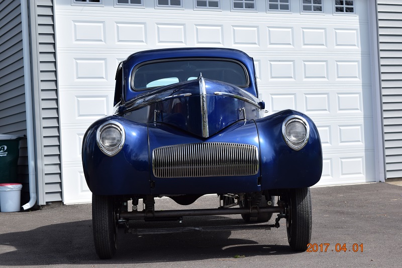

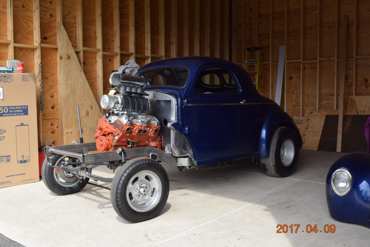

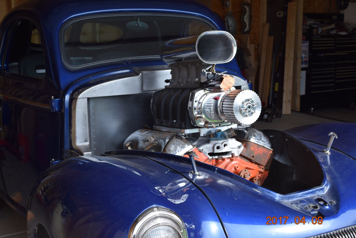

    409 block is at machine shop getting bored and 427bbc crank getting cut down to drop in. waiting for blower custom built pistons from ross. in these pics is were car will be at height wise. will be installing mock 409 block sunday so I can start mocking stuff up. 2017-4-1..002.JPG 2017-4-1..003.JPG 2017-4-1..009.JPG

    So happy to see a Big Pontiac/Olds rear housing!! The best for an authentic gasser build and with Fabcraft's supply of parts there is no reason to cave in to peer pressure and use a Ford 9".

    That is going to be one nice piece there. Fab work is beautiful.

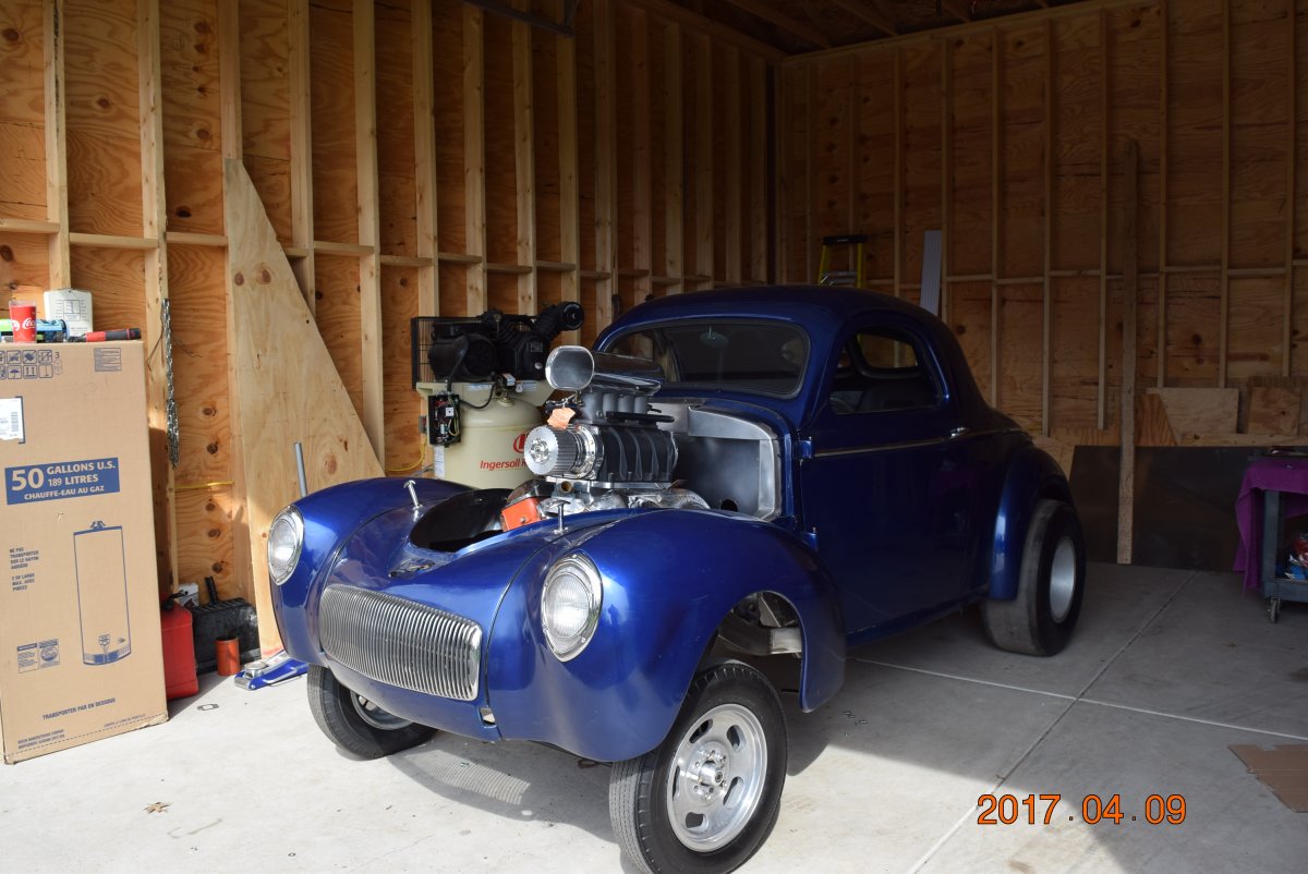

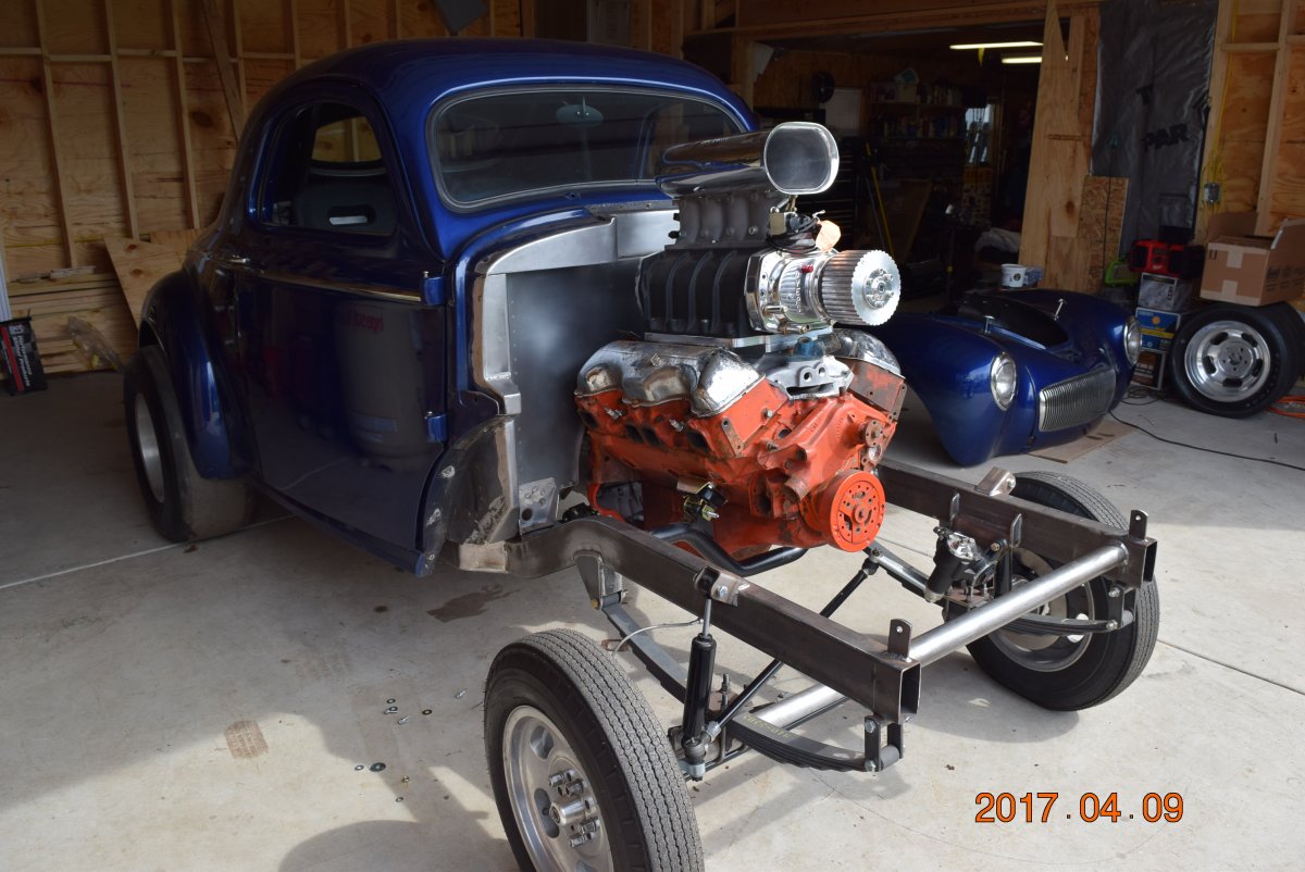

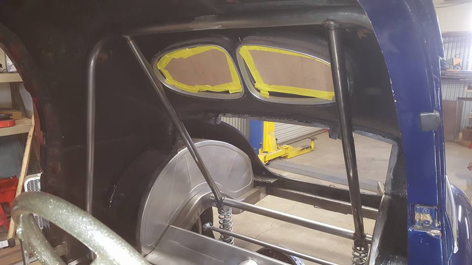

    been kinda slow on the project. but got the mock motor and trans in so I can start on a couple more things like redo on steering. we set it up for the sbc and it is a no go on the 409 due to cyl head interference. 2017-04-09..001.JPG 2017-04-09..003.JPG

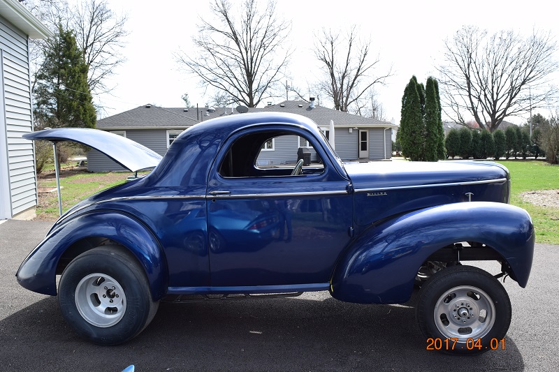

    a couple with the front end on. will have to add a blocks under springs to get front end back up in the air as the 409 is making it sit about 1 1/2 lower. 2017-04-09..004.JPG 2017-04-09..005.JPG 2017-04-09..007.JPG
