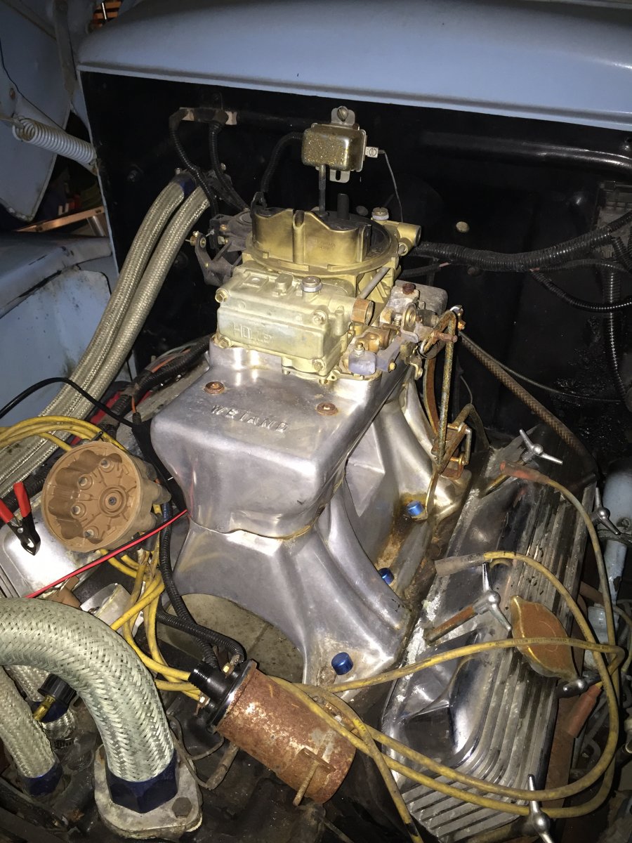

  22. squirrel
    Joined: Sep 23, 2004
    Posts: 56,085
    squirrel
  23. TudorTony
    Joined: Jun 2, 2013
    Posts: 231
    TudorTony
    from NJ
  24. squirrel
    Posts: 56,085
    squirrel
    probably got condensation in it, pretty normal. The rusty coil is a clue.
    classiccarjack likes this.
