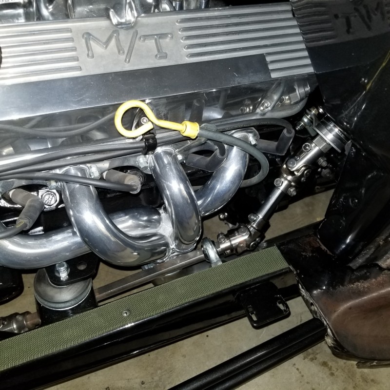

    A tad tight but everything clears. Just need to fit the column shift rod and mill down the jam nut and the column's done.

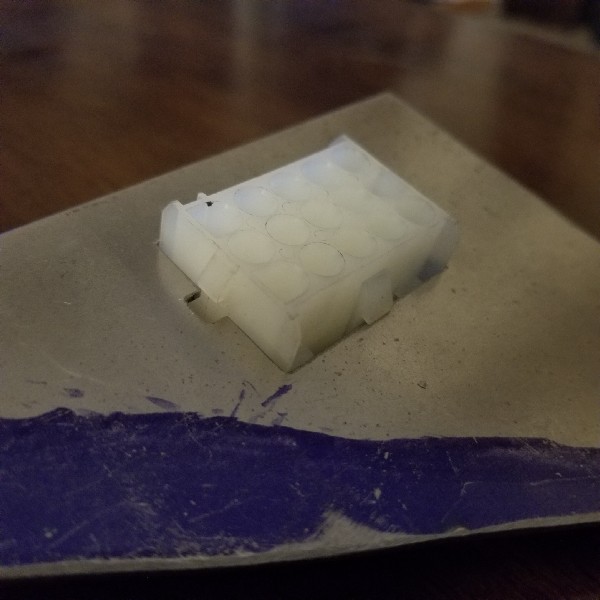

    OK, it's confession time. As it turns out I rushed painting the firewall to get the body back on the frame. I'm using Molex electrical connectors and wanted to put a panel connector in the top of the firewall recess so the engine harness would go into the passenger compartment being relatively hidden. Problem is, the connector requires I create the hole as in pic #1..... in a now painted panel. Now this is the horizontal part of the recess, but i'm still kinda pissed at myself now having to drill/cut through fresh paint.
    Pretty sure I can touch up the edges and nobody else will ever see it. Plenty of sharp bits and body saw blades will be required, but it'll be kinda cool if I pull it off well.

    So why all the hassle for a connector? Well, here's why though some may think it was a waste of time. It'll be even clearer when the tank is wired and in place, but this'll give a little insight to how my brain works.
    After drilling, and a ton of filing the hole is ready for the connector.
    Fits nice and snug
    Now you can see (or hopefully not) how hidden the connector is.
    The engine harness is soldered and fitted (still needs to be wrapped). After wrapping should be virtually invisible.

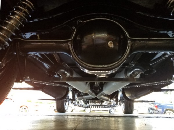

    A little diversion from electrical. The tires came today, so beat myself up mounting one by hand to check out the look. 30 minute wheel change to take it from street rod to hot rod. Fronts should be here in a week or two. Going a bit taller on the front tires to get a bit of axle clearance.

  26. For those holes you had to cut for the Molex connectors, go online to Mouser Electronics, the have cutting dies specially made for panel mounted connectors. Not cheap, but would save time and worry about damaging the paint on the panel. Makes a professional looking hole.

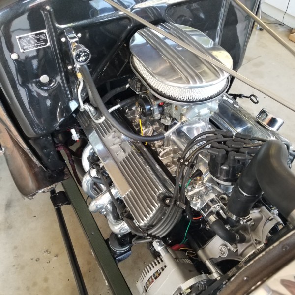

    Front chassis harness is 90% done. Threw a fender and the headlights on to make sure the headlight and turn signal wire routing is correct. Was short a pair of 2 circuit connectors for the turn/park lamps, but now I can knock out the tank wiring while I'm waiting for the connectors. The new front wheels should be ready in a week or so, so it should be on the road soon.......
