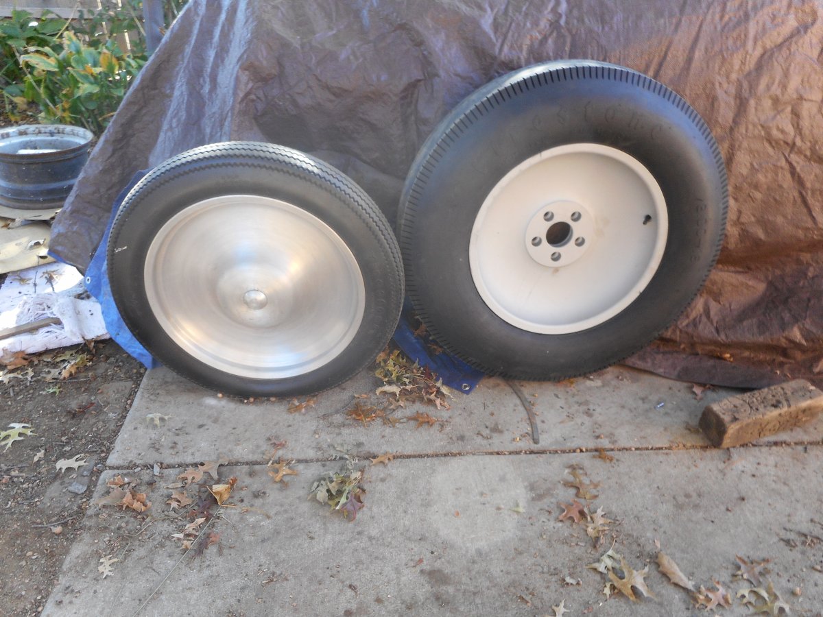

    DSCN0074.JPG Bigs and littles. These rear wheels and tires are really big. 8:00 x 18 Firestone Indy tires.

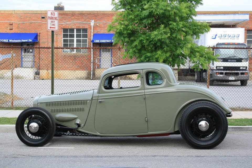

  27. xderelict
    Joined: Jul 30, 2006
    Posts: 2,477
    xderelict
    This Ford is a good example of what I'm setting it up for. The car is being built to scrub line which is LOW. Look at the front wheel in an earlier photo.
